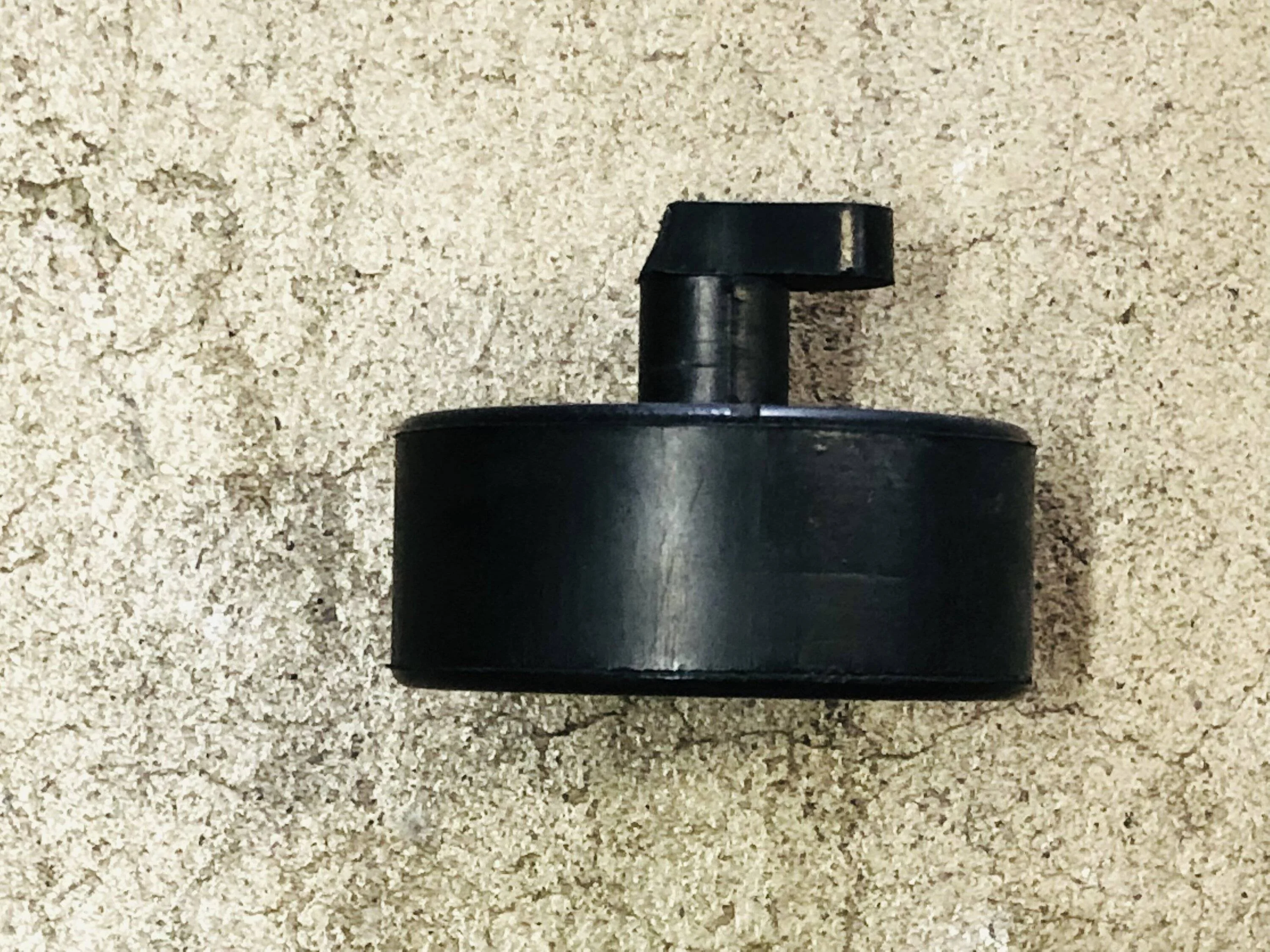

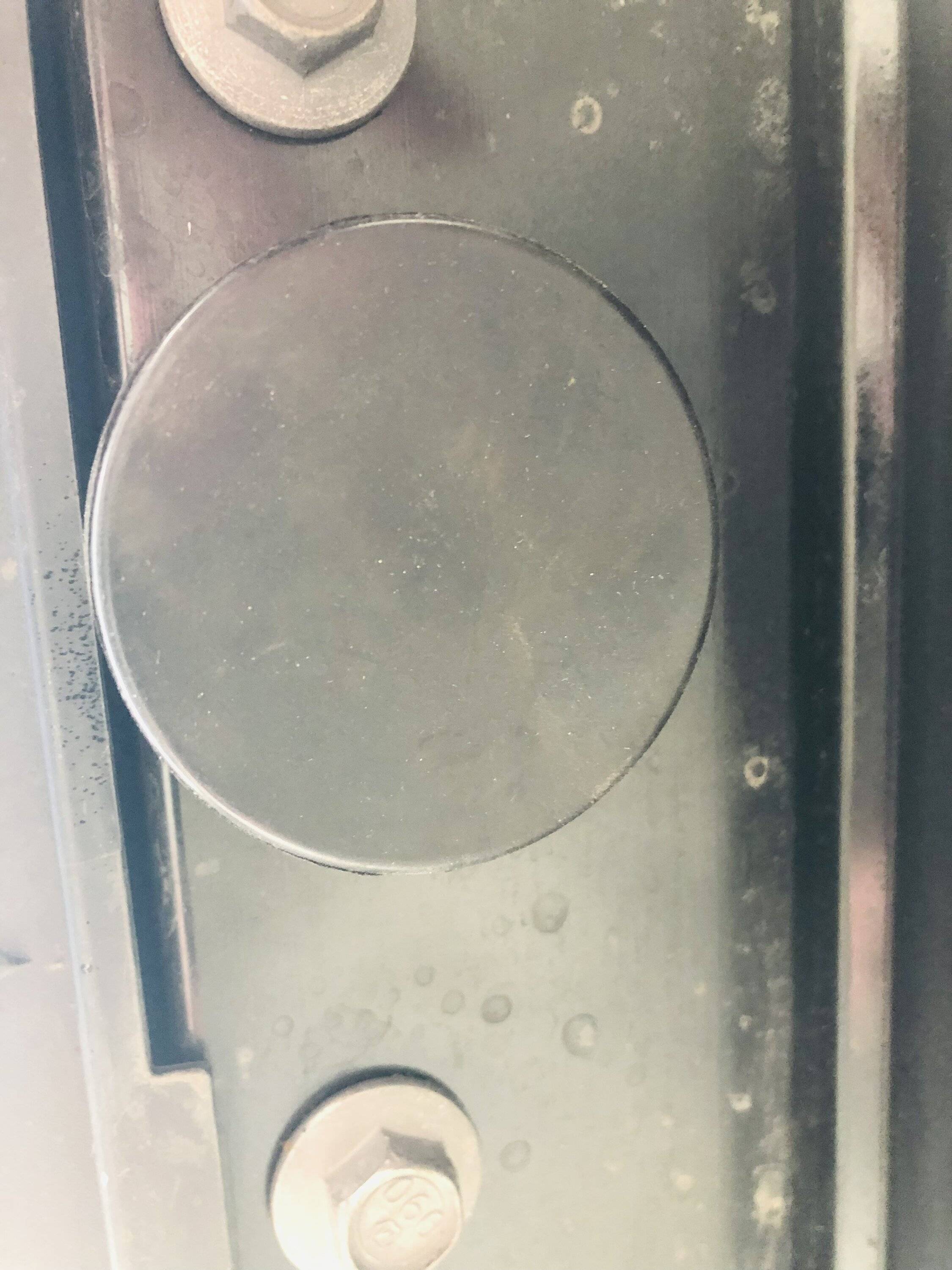

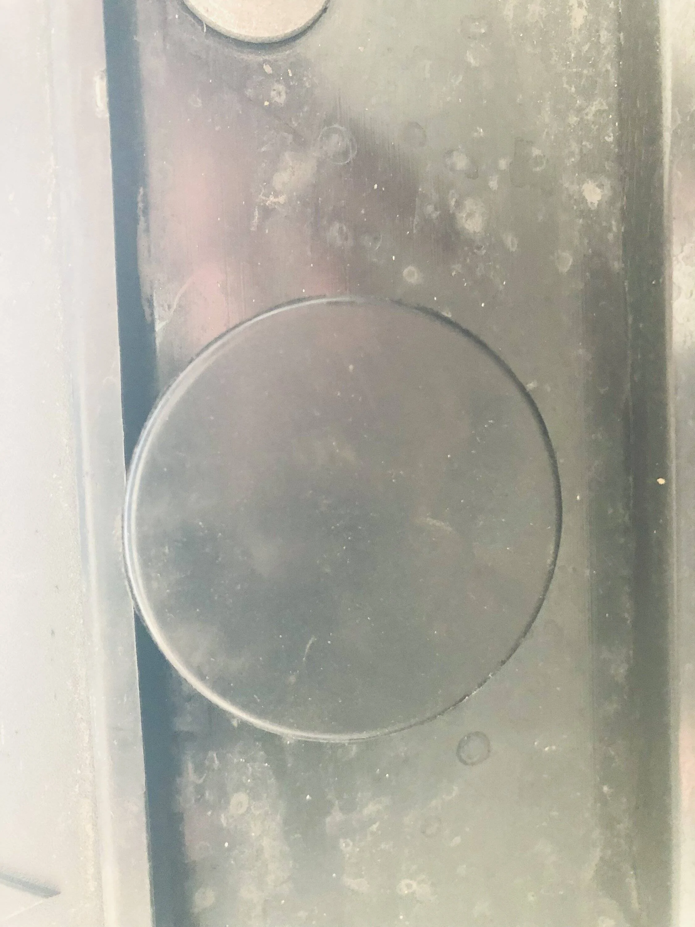

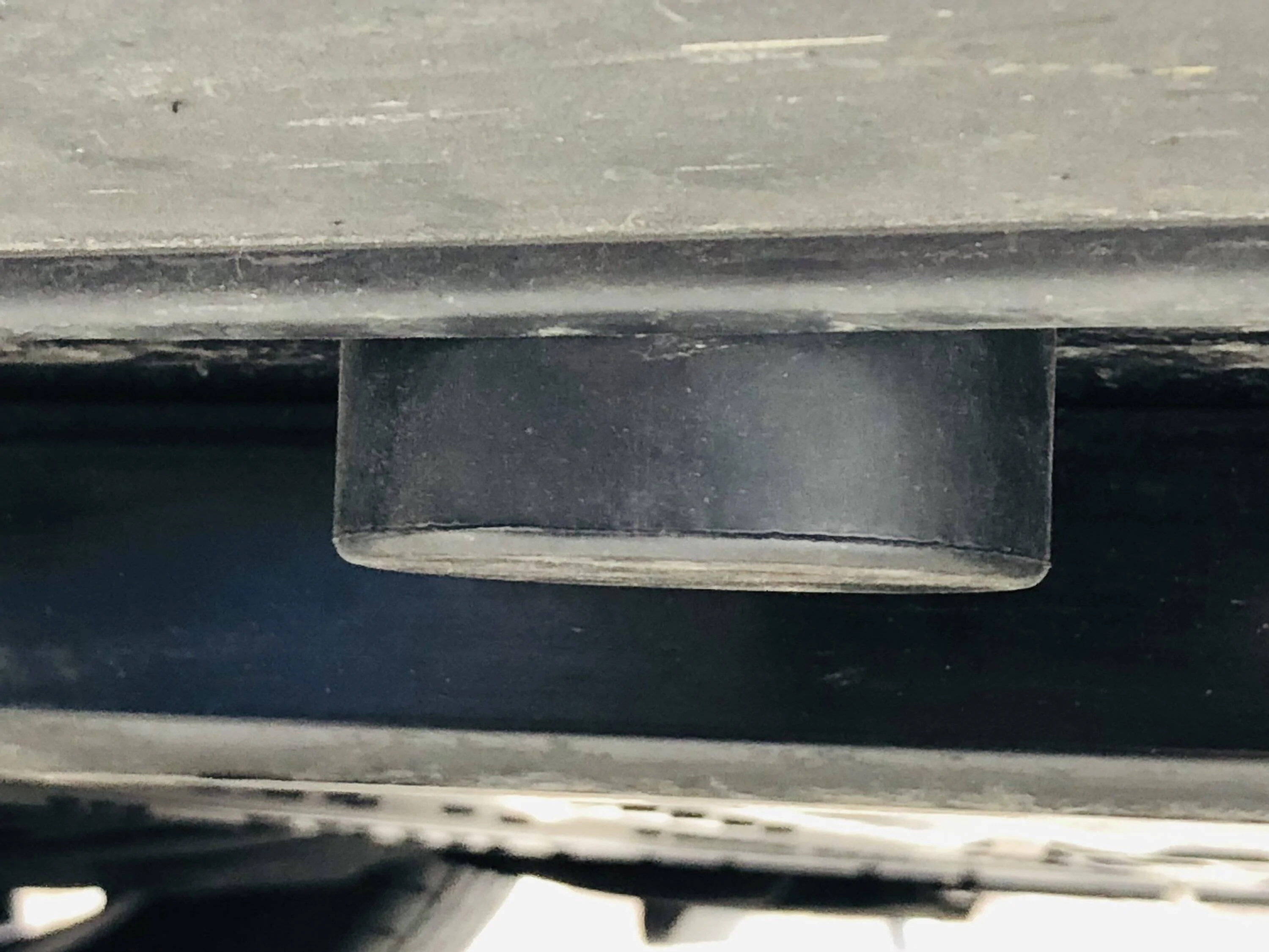

I have a set of modified rubber Corvette lift pucks in a bag in my car. Our cars are weird in that they have a pair of round holes and a pair of obround (oval) holes at their lift points. Some fool at Ford needs to be fired for that, why not keep them the same? Anyhow, the Corvette pads are made for a specific obround hole that has a smaller minor dimension than ours and a larger major dimension than ours (and it just won’t fit into the round hole). The mod is simple. Just cut one of the arms off of the ”T” with a set of diagonal cutters, and you’re ready to install. ??
The cladding helps to keep them in place so you can get a lift under them, but don’t leave them there when driving or you might lose them. ??

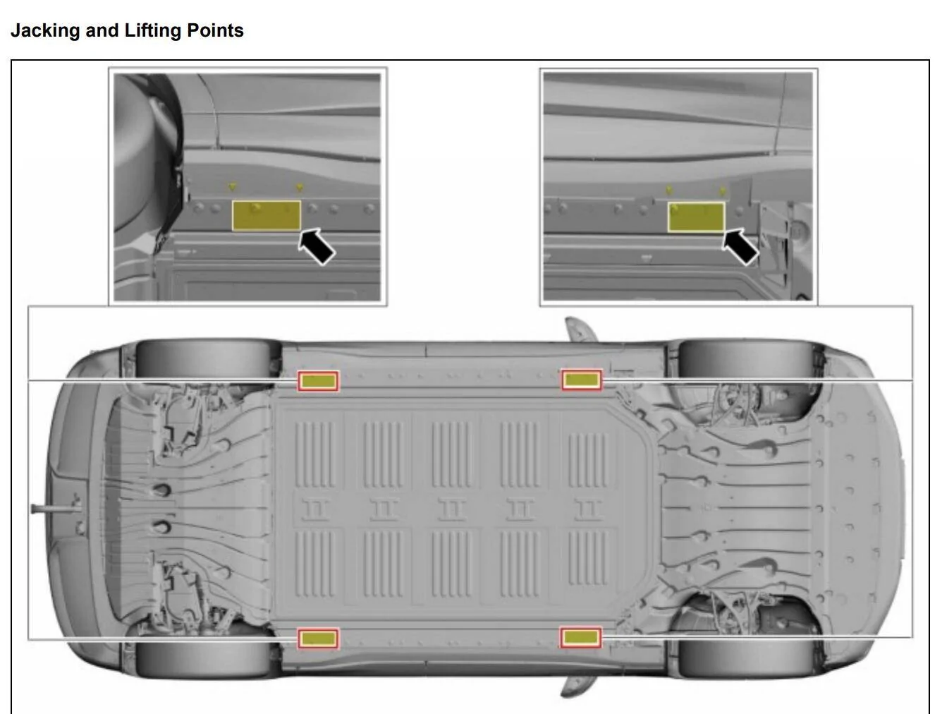

There a lot of questions through threads on how to jack / lift Mach-E. Maybe some variations are okay, particularly if the load is spread.
From the pdf, there is a very specific area between the triangle marks on the plastic strips which is suggested. It is the just under 3" strip inside of the aluminum rails with holes which are actually part of the battery pack and which aluminum battery rails are not to be used for jacking lifting (?), and which can be ripped (shipping example), or crushed.
The approved lift or jack area is the thin strip between /the outside plastic strip (with the triangles) and /the inside aluminum rectangular battery rail.
In the lift examples, it would seem that many reviewers are technically lifting incorrectly using the rectangular aluminum channel, instead of outer metal (steel?) strip.
I guess (?) to lift at least technically correctly, it takes something like a rubber jack pad / block that can be between the typically wider jack head surface and the relatively thin (2 1/2" to 3") metal rail which is inside of the rectangular aluminum battery member.
From the pdf:

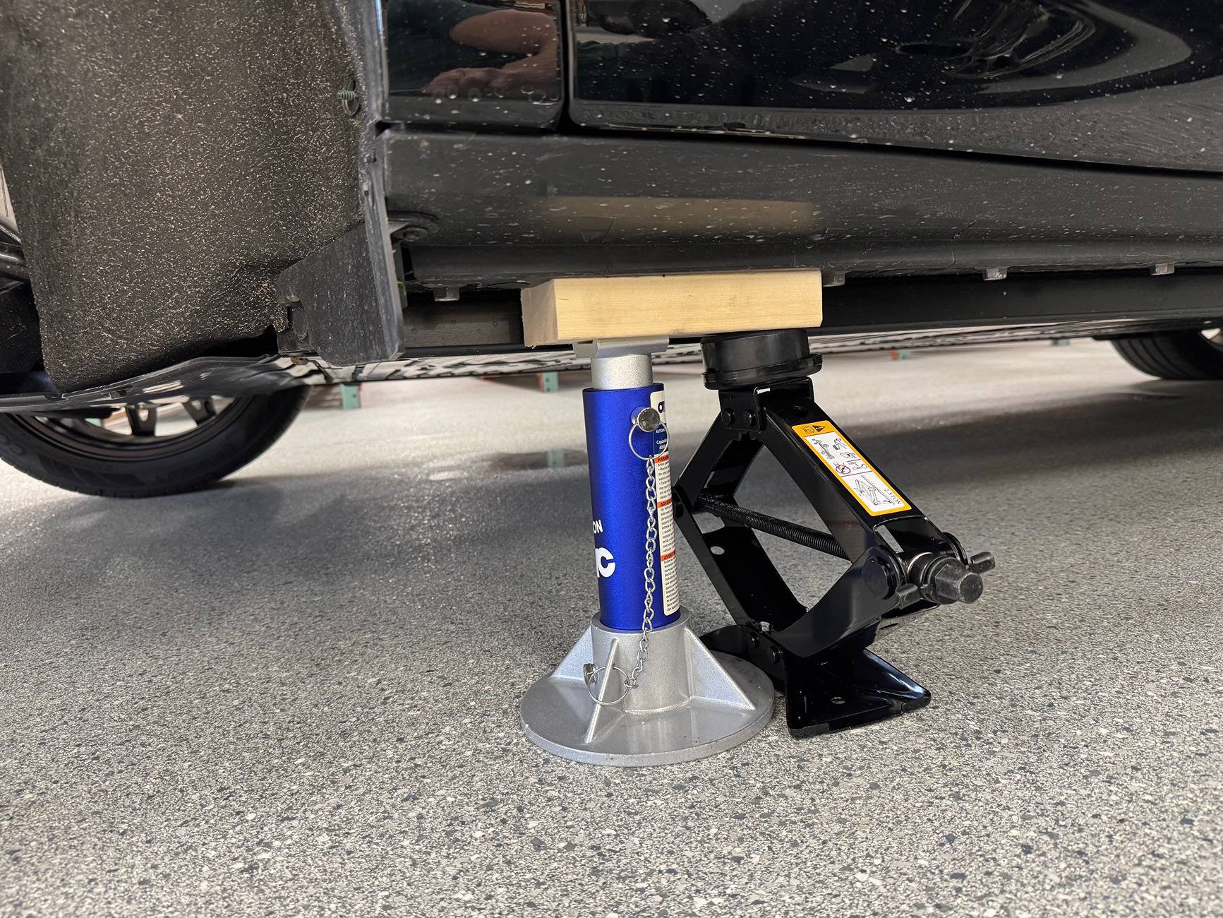

I found a way to jack the Mach E up and place jack stands all in the approved lift points only.
You need:
1) Amazon 2.5 ton scissor jack
2) OTC 2-ton jack stands, or other small round-based jack stand
3) Four ~6.5" long pieces of 2x4
Cut the 2x4's to length to fit in the jack point areas. Then use a 3/4 spade bit to drill pockets in the 2x4's where the frame rail bolt heads protrude into the jack point areas.
This works on all four corners of the car.
