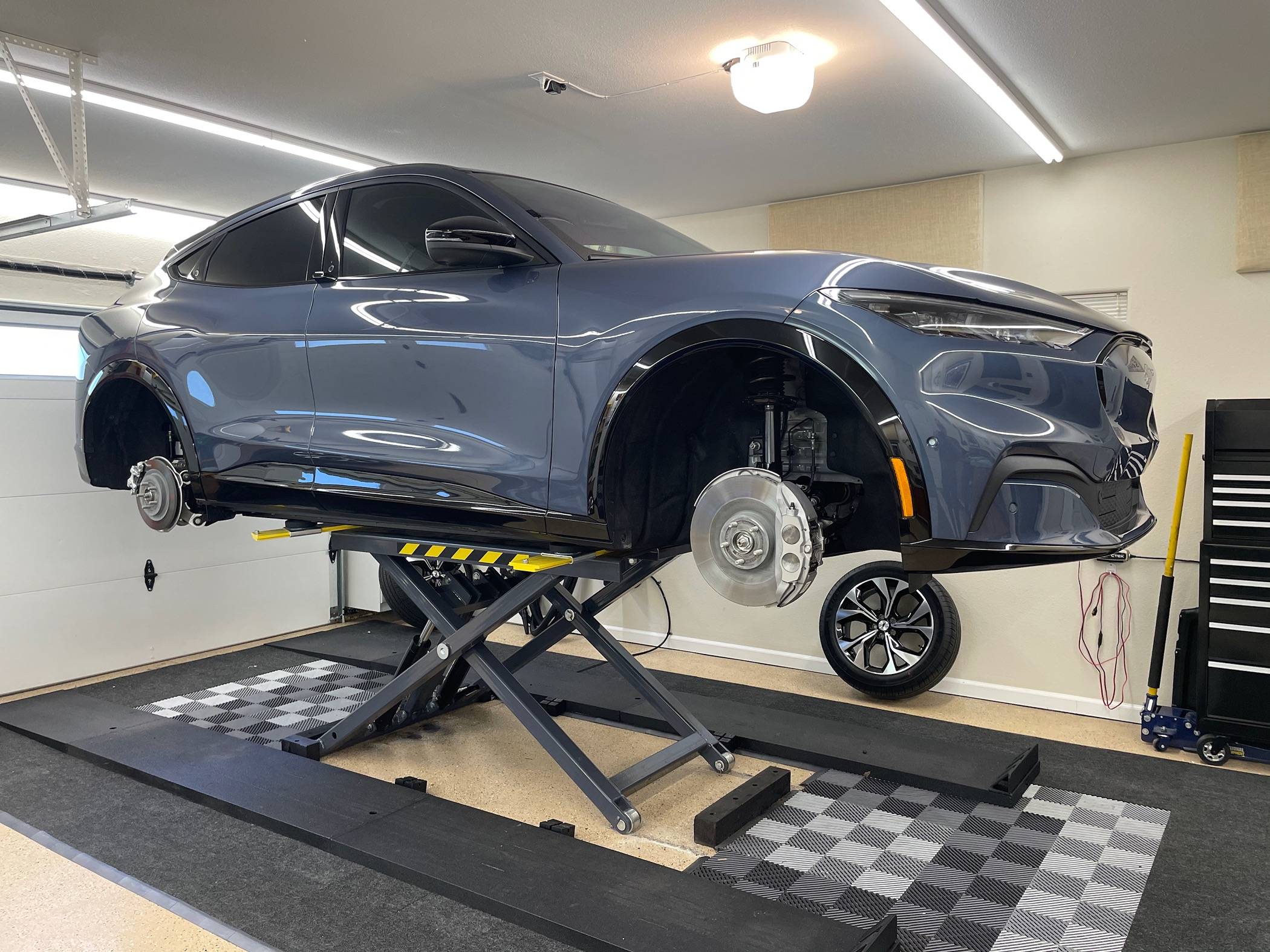

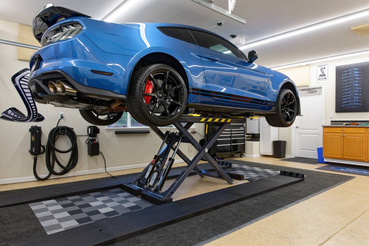

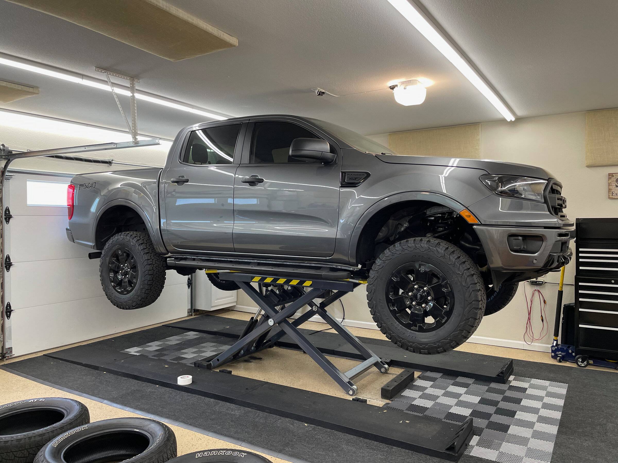

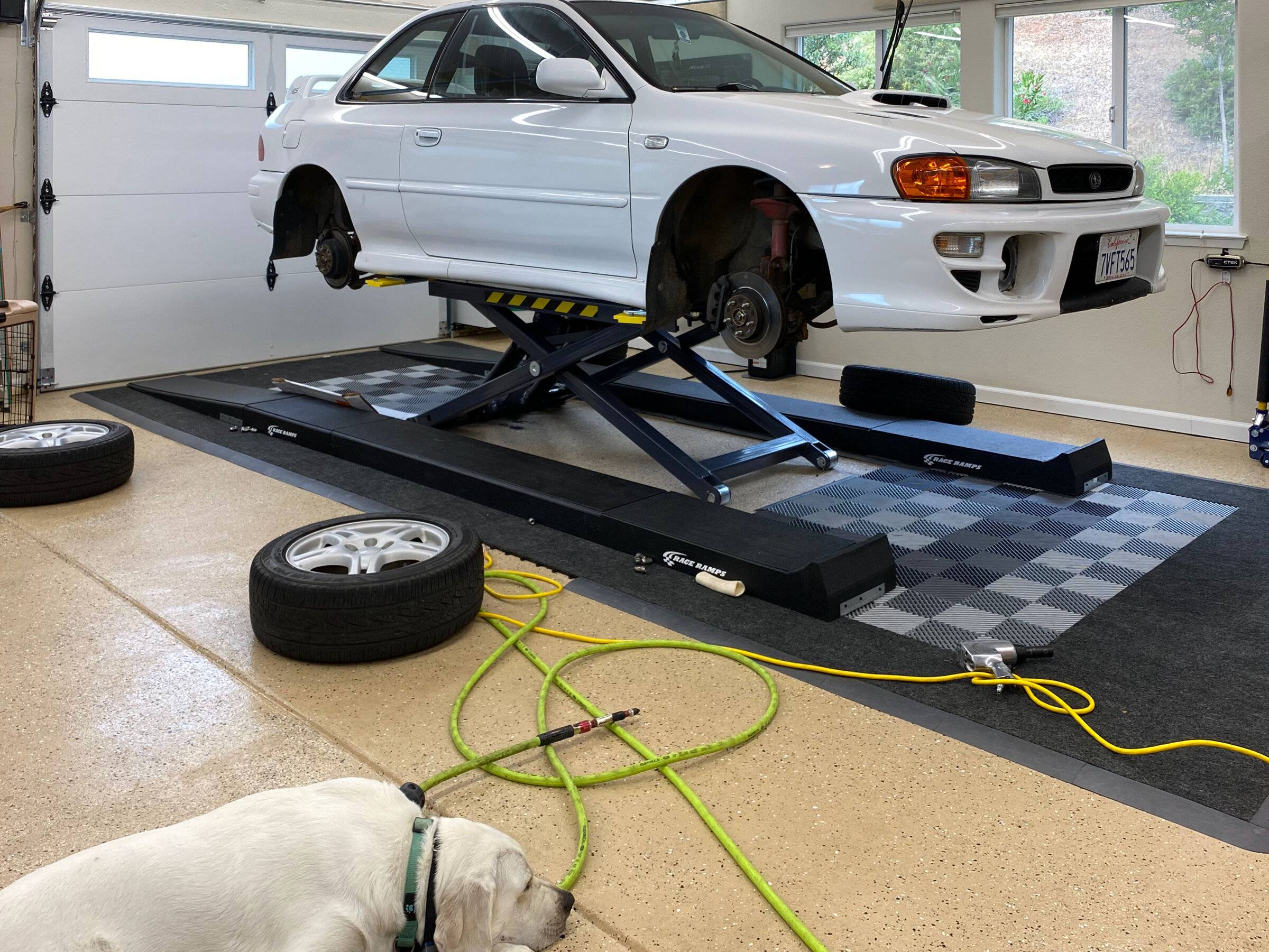

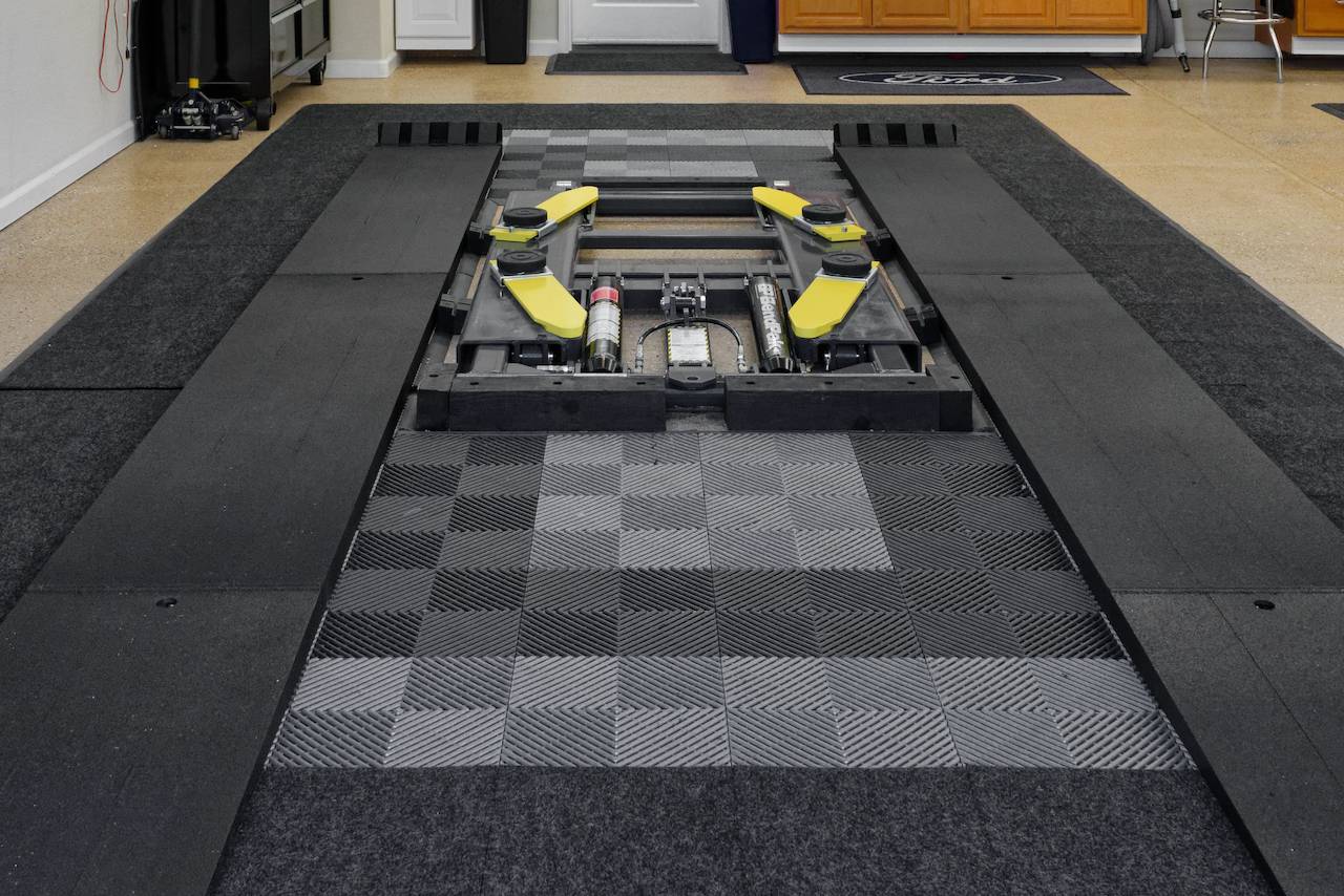

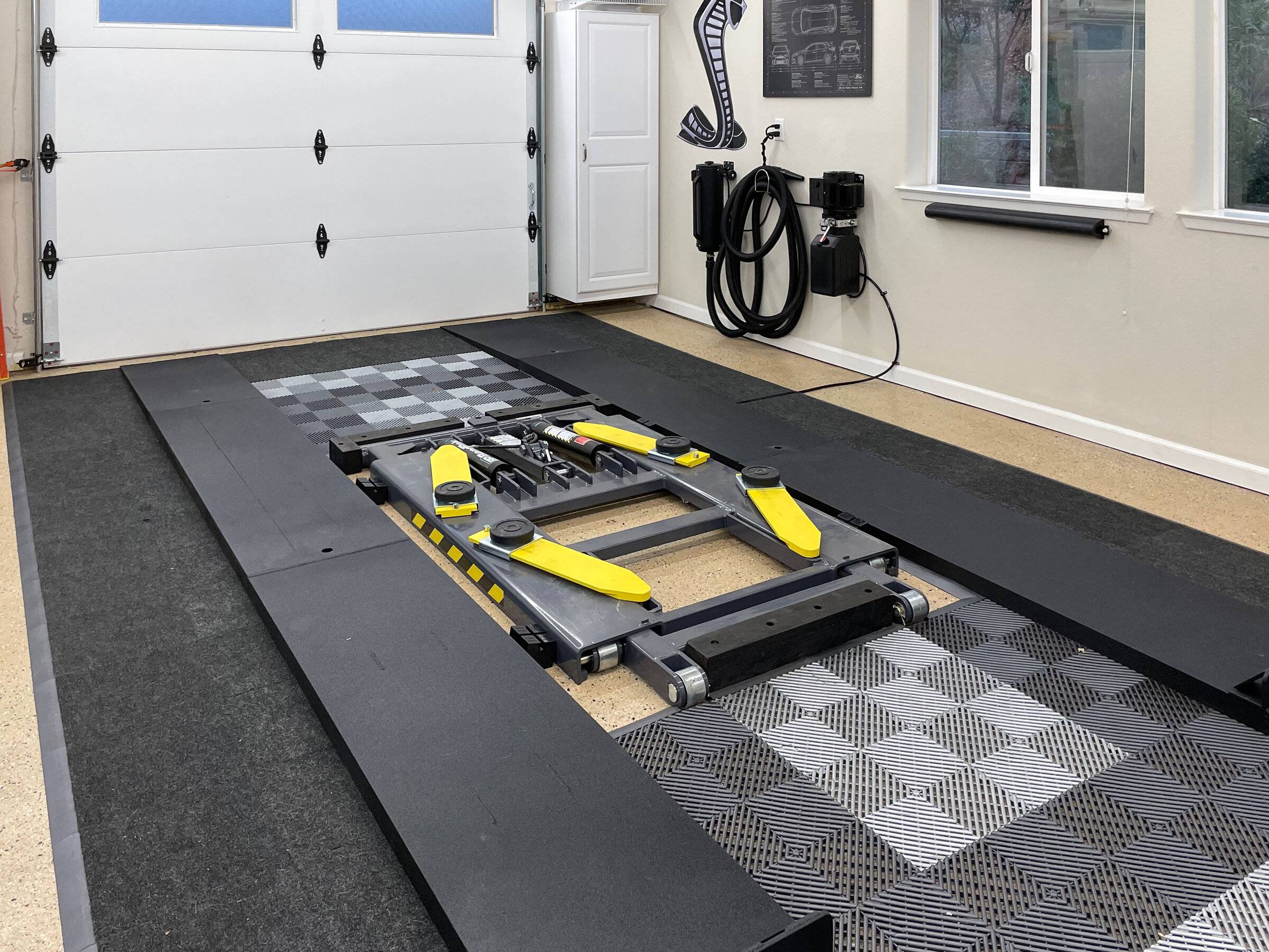

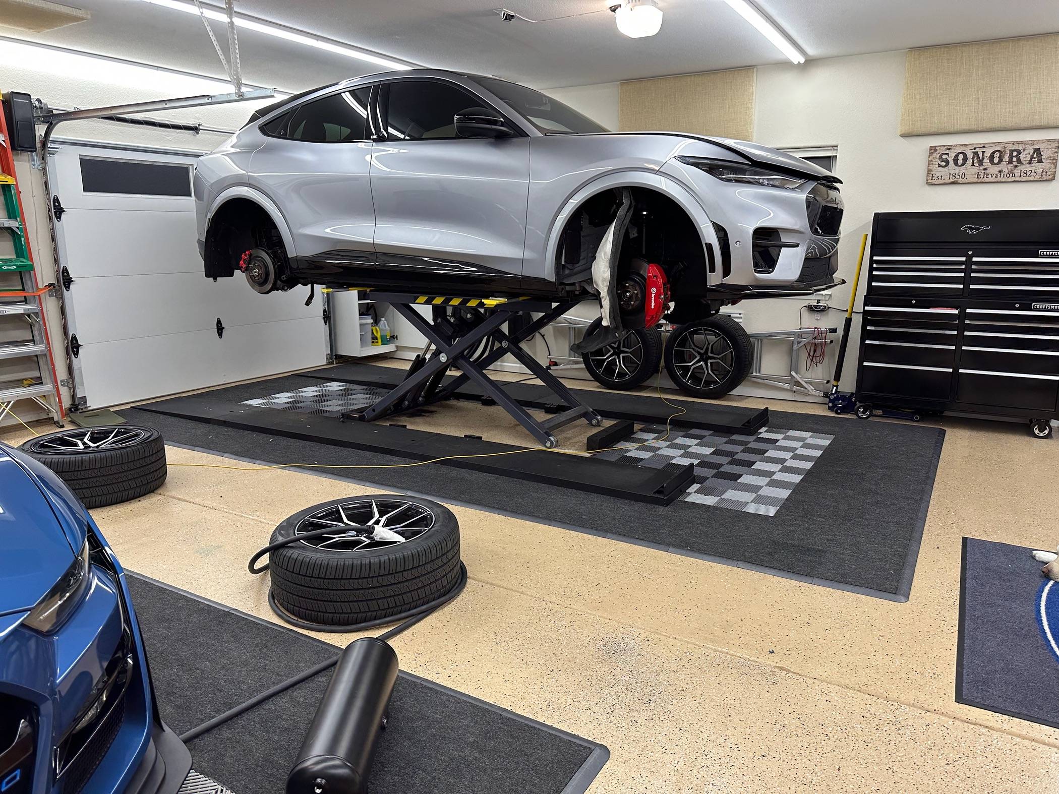

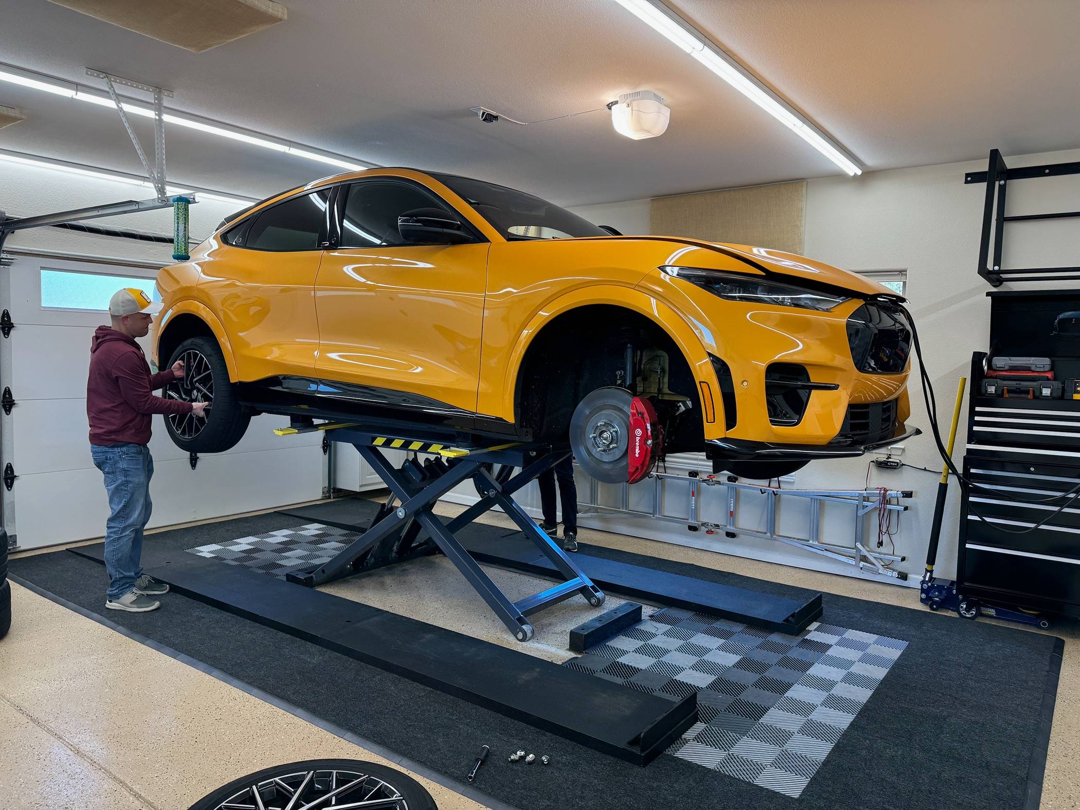

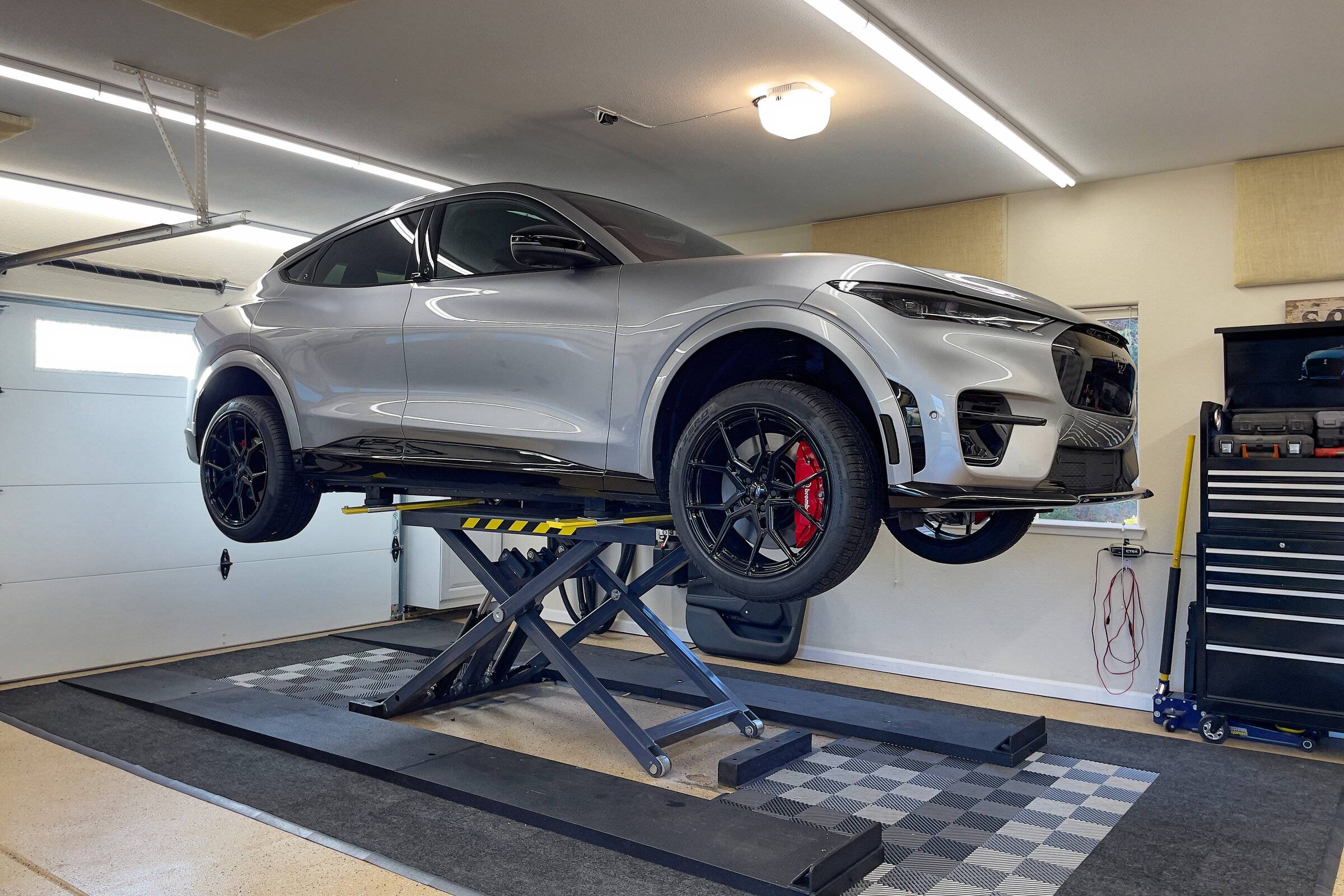

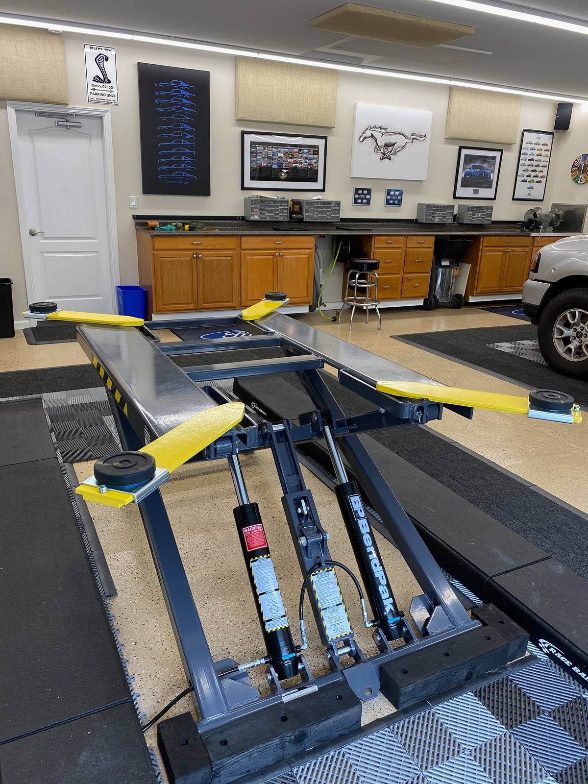

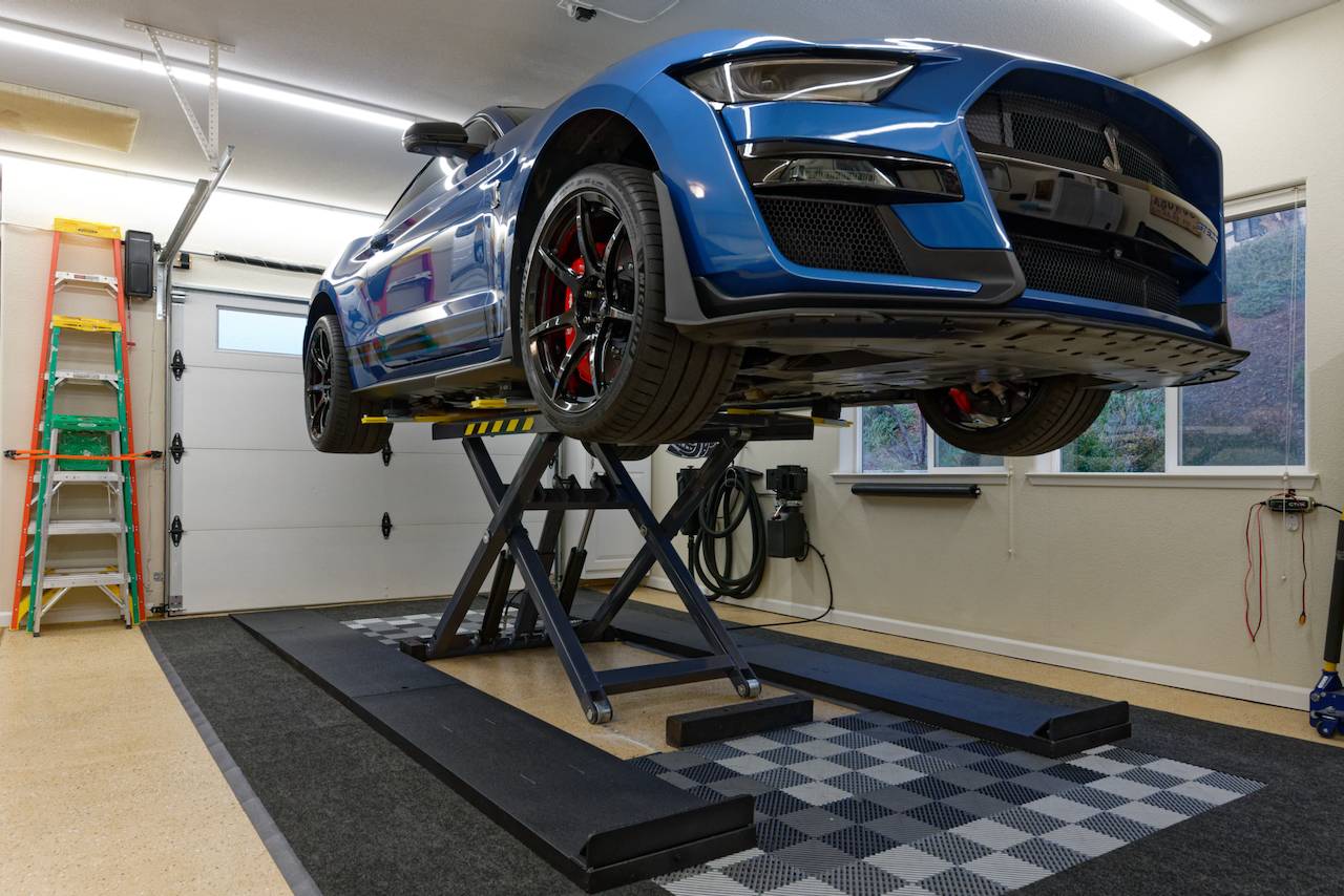

I have a BendPak mid-rise scissors lift (MD-6XP) which was just under $3K when I bought it a few years ago (https://www.bendpak.com/car-lifts/mid-rise-scissor-lifts/md-6xp/). It was probably the best investment I've ever made for my cars/trucks. I have a 9 foot ceiling garage and changed my overhead garage door opener to the wall mount type (Chamberlain) so there would be nothing above a vehicle when raised. This mid-rise lift raises up a maximum of 4 feet. I had two RaceRamps on each side but wanted a more permeant ramp (you cannot bolt them to the floor as they are made of foam). So a friend of mine custom made two aluminum ramps that are 18' long by 18" wide and 2 1/2" tall. Had them coated with Rhino liner. The lift is about 5" tall when collapsed and would not need the ramps if it was just for the Mach-E or any of the trucks but for the Focus RS and GT500 with a ground clearance of 3.5", I needed ramps.
While I thought I would use the lift for just changing oil and brakes pads (I cannot rotate tires on any of my cars as they all have a staggered setup) I found I use it for much more. I really like cleaning and detailing my cars on the lift. Much easier to detail all the lower trim, wheels/calipers, exhaust tips, etc. Also was much easier for me to change out springs/shocks/struts on my Premium Mach-E and GT500 and applying the tint on the reflectors when they were at eye level. Being 67, it is not so easy for me to kneel down and work in that position anymore. ?
