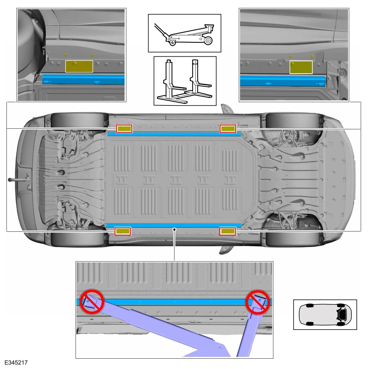

The service manual has been updated to highlight the guardrail (blue) which you should NOT use. Jack in yellow areas, not blue. Also, do not allow a tow truck driver to put hooks anywhere in the blue rail or you might need a new traction battery ($$$$$). The proper recovery points are ahead of the front wheels. Joe, perhaps you could update the photo in your original post?

If anyone is using a lift (or a floor jack) I strongly recommend these QuickJack blocks. I have been using them for years on my trucks and cars and they do not bend, break or deform in anyway. They work great for cars with pinch welds (like my Mustang coupe) and they are also the perfect size to fit between the battery guard rail and the body on the Mach-E. They fit perfectly in the yellow areas marked in the service manual diagram that Lee posted above in this thread. Unfortunately, they come in a set of 4 for lifts and I know most people only need one if they are using a floor jack. https://www.quickjack.com/accessories/pinch-weld-blocks/
