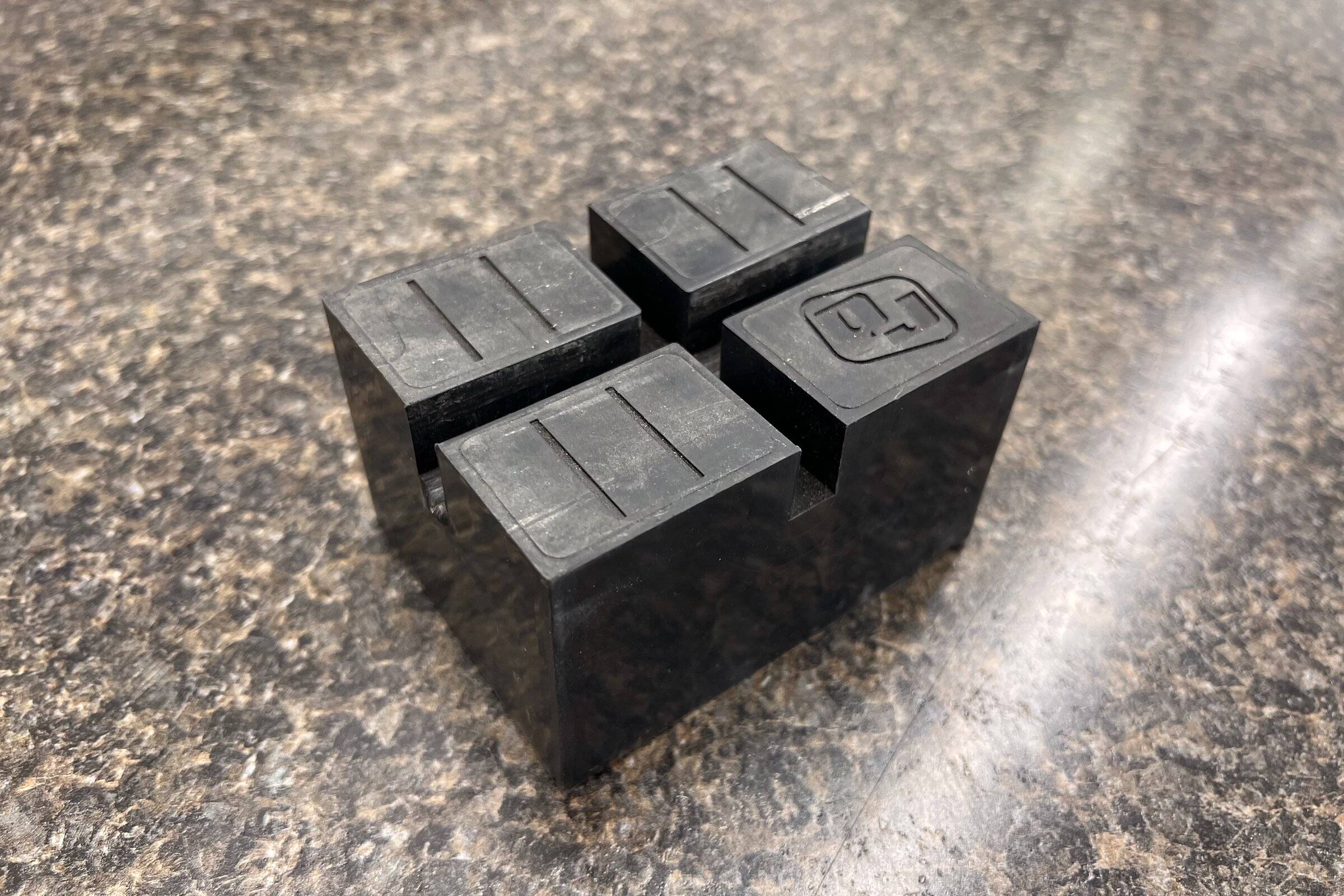

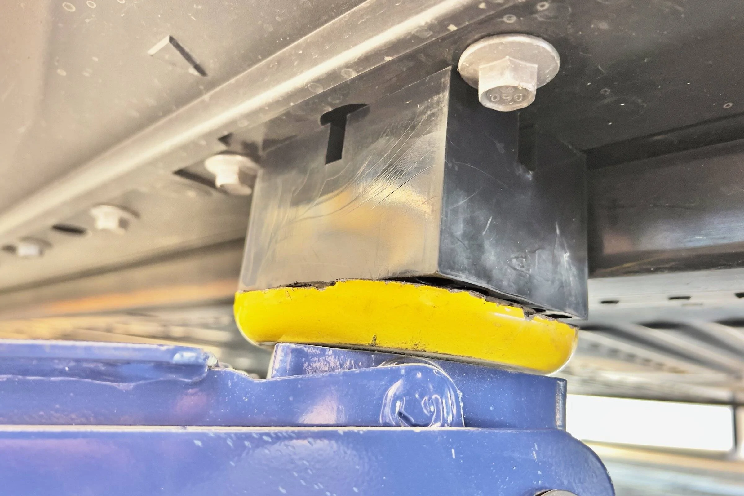

Honestly I haven't seen any decent jack pads other than cutting 2x4 wedges. I'd buy them. But maybe I'm alone and thus we will never get a reasonably well made option.
You may have missed my earlier post in this thread but these are what I use for the Mach-E and also other cars like Mustang coupes that have pinch welds. They do not bend, break, crack, etc. They fit perfectly in the section where the Mach-E should be supported. Of course you can make your own out of wood or whatever which should work fine for the Mach-E but I lift more cars than that so it is nice to have these for various applications. https://www.quickjack.com/accessories/pinch-weld-blocks/

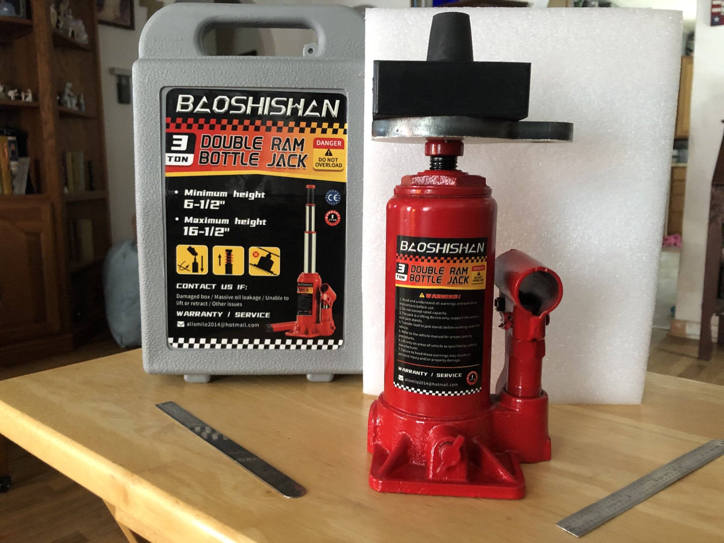

Here’s my lifting set up.
I have 2 sets like this, as I plan on only lifting as a set, the front, the rear or a side.
the top 3” square lifting rubber has a rubber stopper mounted to it.
this fits into the hole of the steel plate between the lift point arrows.(stays in place)
then, because the bottle jack contact point is so small(3/4”dia.), I use a shooting steel 3” dia. AR500 3/8” thick plate, to distribute the pressures!

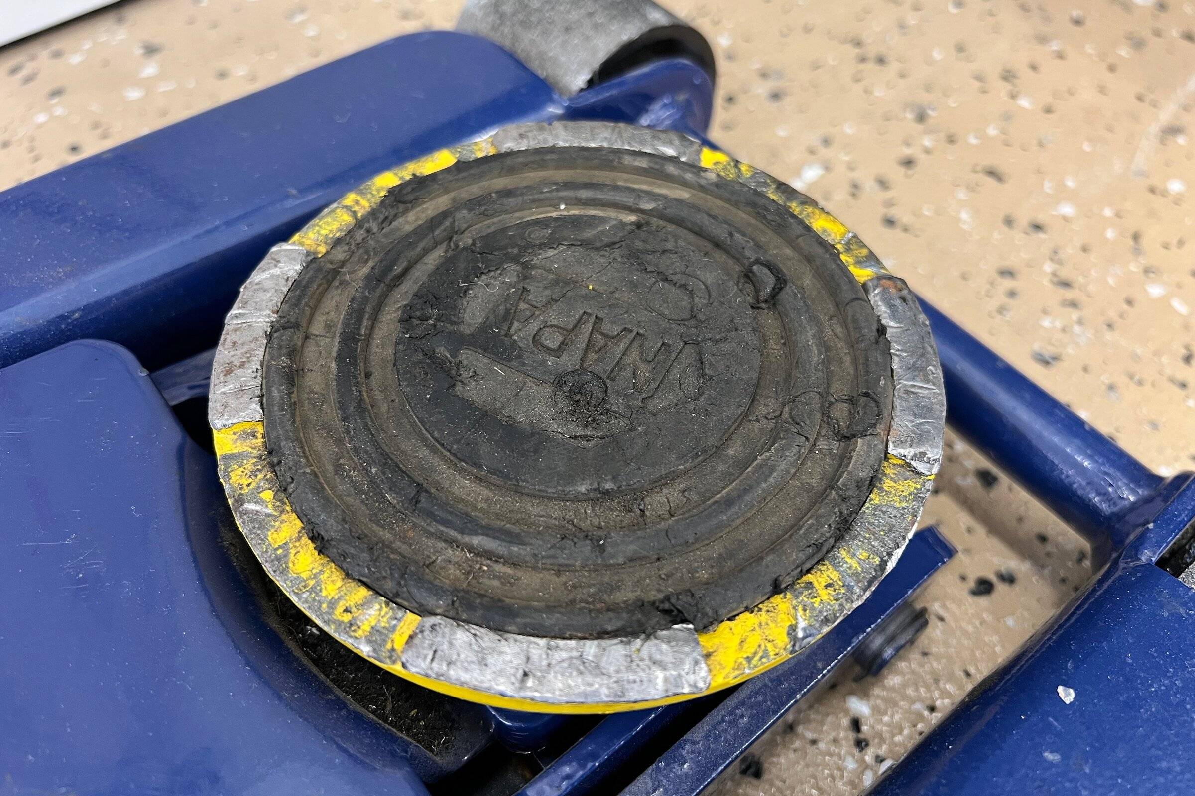

Notice how that fits the mach-e and NOT the jack? As I said, there is no good jack pad that fits both ends that I've seen. Or is your jack not hollow? That lift point on mine is a cup and would dig into the pad and destroy it.
Oh, you don't use that with a normal jack; you need a fancy $1000+ jack to use those $100 pads. lol. Not quite what I was wanting.
My jack is not hollow. The lifting point on my jack has a solid hard rubber pad so it is completely flat. Same with the crossmember extension arms and also the arms on my big lift. All have flat rubber pads on them built in.
I use a normal jack quite often if I am living up one corner (normal floor jack) or one side (normal floor jack with crossmember extension). I only use the big lift when I want to bring up the entire car.

Picked up my Mach-e on 1/11/22, have not had a chance to test out my set up.
the car will be a “ hanger queen “ in the winter, only using when sun might be shining…. 268 miles driven so far…..
A ABIGAIL 2 Pack Universal Jack Rubber Pad, Square Slotted Frame Rail Floor Jack Pinch Weld Adapter, Car Black Anti-Slip Rail Pinch Weld Adapter Support Block Heavy Duty for Car Lift, ;Amazon…….
