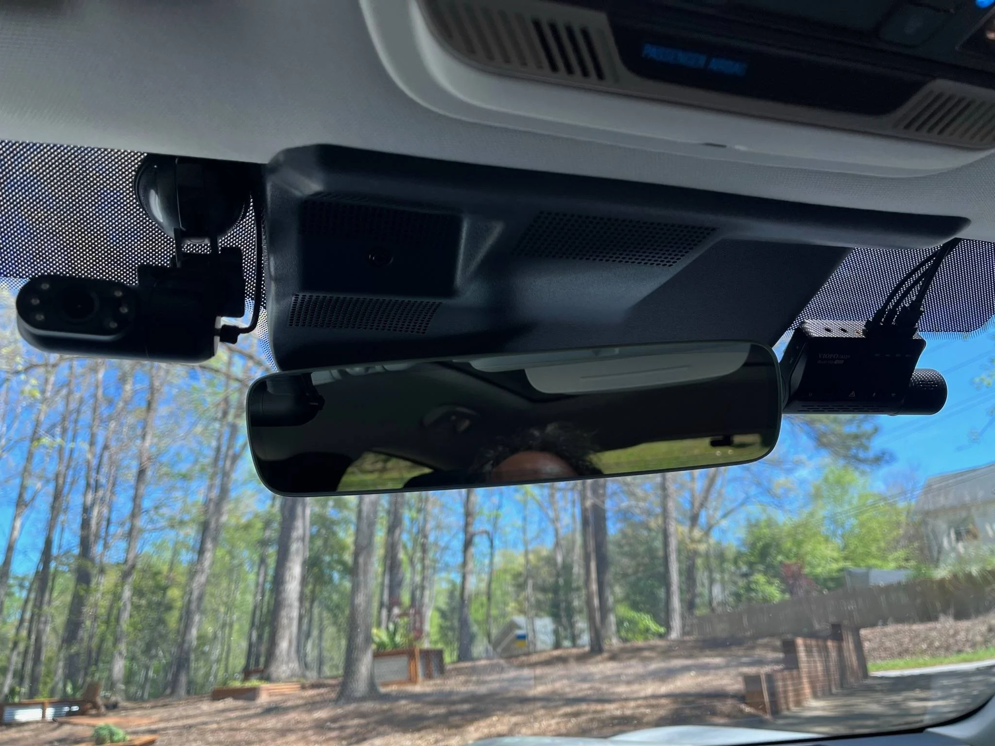

Got the Viofo A139 installed this morning. It took the installer about 3 hours. He did a great job. But the other folks I want to thank are everyone on this board and thread. It made life much easier after he reviewed a few pages and photos here and watched Ben's excellent video!
It is a 3 camera system and you will note from the pic below I had the interior cam mounted on a swivel. I also have it powered via the Powercell 8 battery from BBMC. Now I just have to figure out the best settings and do a few minor adjustments! Thanks to all! BTW - my local shop charged $300 for installation. the interior job went well with no broken clips or other parts! Great information from all of you. Of course I'll try to answer any questions you may have.
