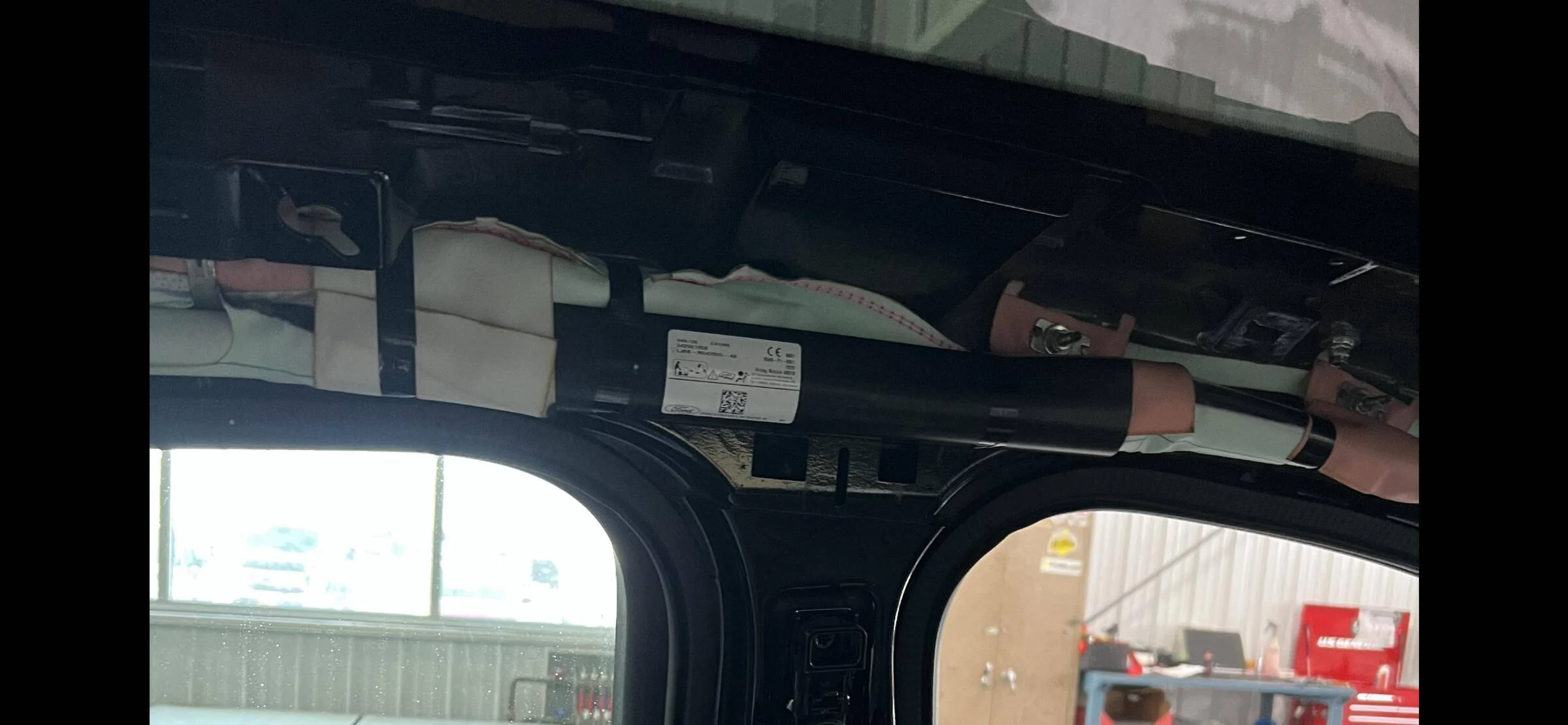

I decided against derailing the 21P22 VIN check thread, and figured I'd ask here: @Murse-In-Airy's post here had a great look at all the guts under the headliner. It did give me pause though -- any concern that running a rear cable in the manner suggested here would interfere with one of the curtain airbags? Ie tucking into the rubber trim above the doors and threading it through the B column?

I’m not sure I posted this pic over on the other thread. But now that you mention it, I kinda took this shot to help with this exact question.

I believe that as long as you keep the wire against the rubber seal and metal of the body/frame, the airbag will explode out of the headliner and go right over the wire. Then along the b-pillar is a plastic roll that keeps things contained. So anything you tuck beside the headliner will end up underneath/behind this plastic. Therefore behind the airbags if they do inflate.
Hey thanks! That's reassuring, especially with the photo. My windshield just cracked during the recall work too, so I'll have to wait a while till I can give it a shot...
