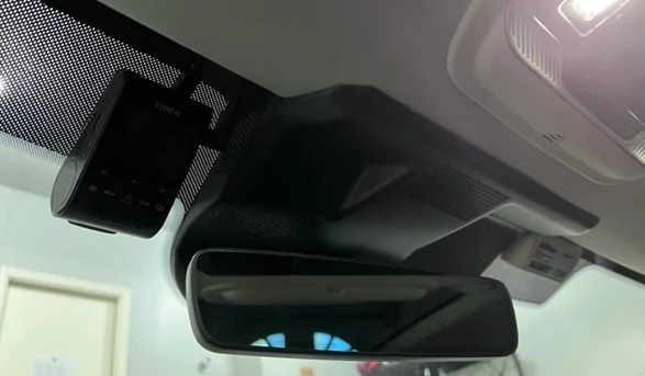

@MachTee or anyone else who wants to answer:
Can I ask where you mounted your cam that you are getting good GPS signal? I’m thinking of adding a GPS antenna to my Thinkware X1000 And want to make sure I put it in the right spot? Does it have to go on the dotted part of the windshield? With my EZPass and Radar sensor for the cam, the black dotted area is getting crowded fast.
I have a Thinkware U1000 front camera installed and just running off 12V for now (waiting for my install appointment to get the full system put in). I put it just to the left of the mirror module, up in the part of the window that's partially shaded, just far enough away from the mirror to make it easy to remove from the mount. It announces GPS lock almost immediately when I power up the camera.
To the left of the mirror housing. Not sure how big your radar sensor is, but I still have some room left.
Yeah that's about exactly where I put mine too. Doesn't seem to be obstructed at all
