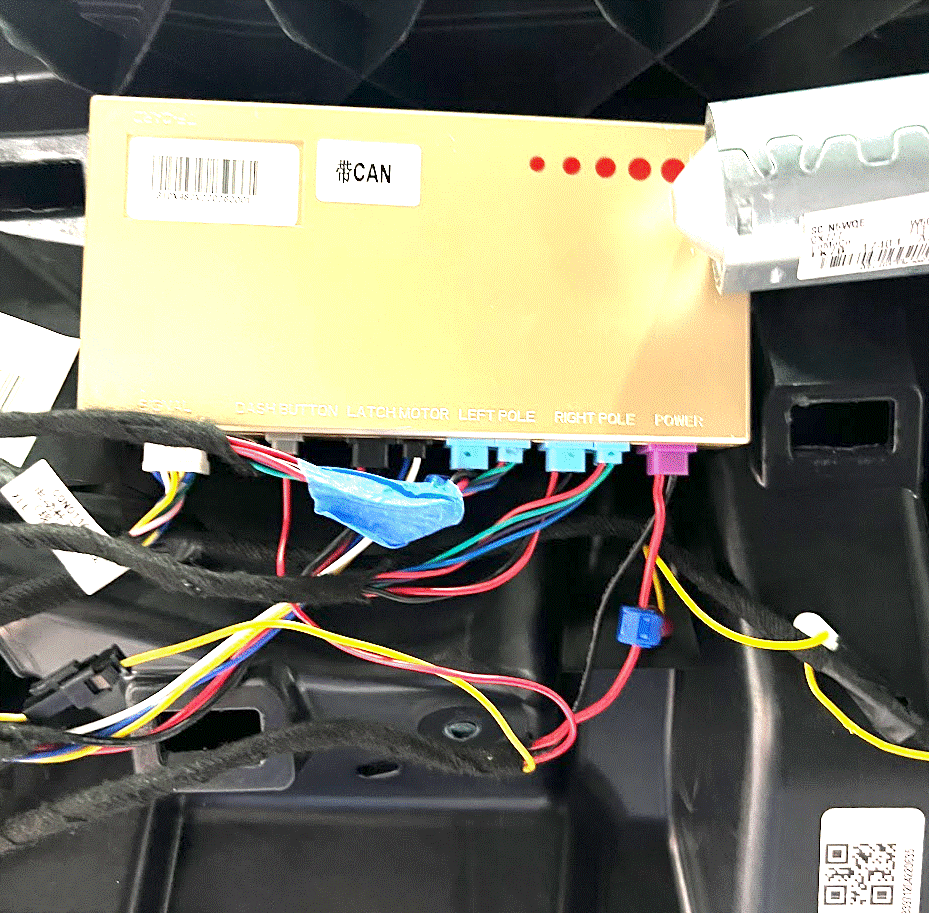

The pictures in the Autoease instructions show a spare tire, but my 2022 doesn’t have a spare. Did the 2021’s have a spare? I’m wondering because my trunk floor is totally different than the instruction pics. Because of this, I had to make a few modifications to how/where the control box and latch motor are mounted. I’m curious because I haven’t seen this mentioned in the forum.

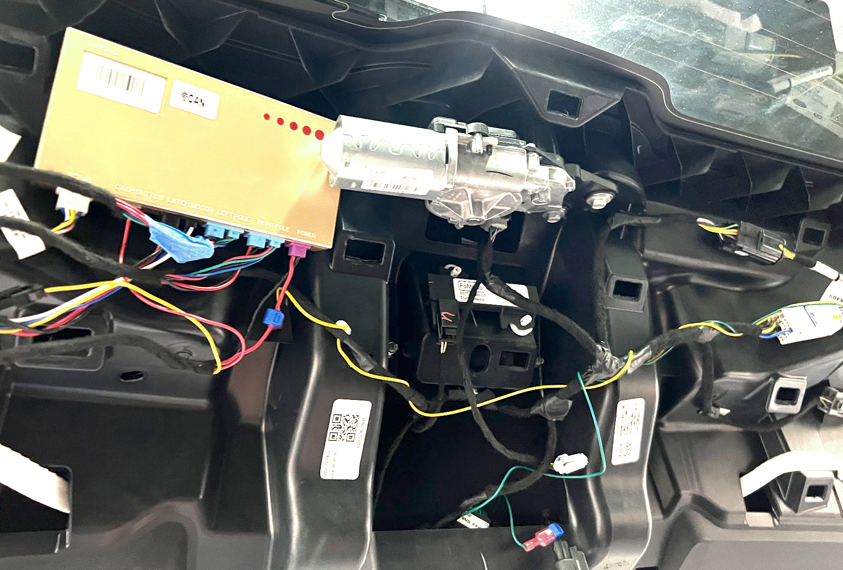

I’m pretty sure all my installs (I’ve done about 10) consists of placing the latch motor below the rear trims and routed to the right side. I unclip the trims and tucked the unit and connectors there too.

I also routed the latch motor to the right side and put it behind the right panel, but I didn’t like the idea of mounting it only with adhesive tape like the manual said. I did use the adhesive tape, but then I used 2 self tapping screws in the 2 holes in the box to secure it to the sheet metal. I couldn’t find a good place to secure the control box on the right side, so I bent a 6” piece of aluminum Angle to make a simple bracket that I attached to the control box and then I riveted it to the hatch near the back of the latch area. This probably made it more difficult to route all the wires up to the hatch and to the control box, but it’s where I wanted the control box and this was a simple solution for me.

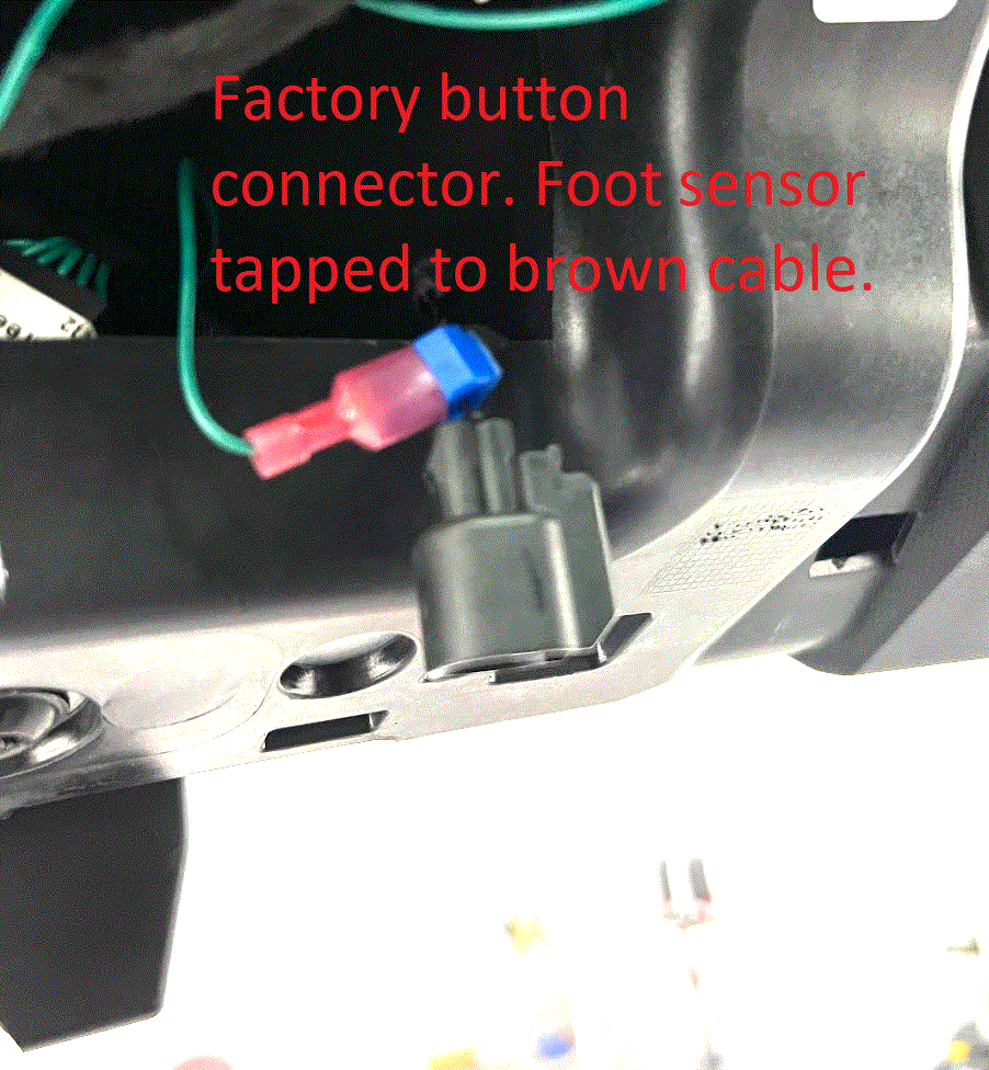

Question @Megabueno and others - I got the same kit from Autoease, and was able to get the power liftgate working. Both the factory and aftermarket buttons work to open and close the liftgate. I can't get the foot sensor to work. It gets 12V just fine, it's plugged into ground, but then it's not outputting 3V through the trigger wire. Nothing happens when I move my foot underneath. The sensor is installed inside the rear bumper with "sensor" text on top, and 3M pad facing bottom. Trigger wire is connected to the factory brown wire on liftgate button (the one in the center).
How did you have it wired?
