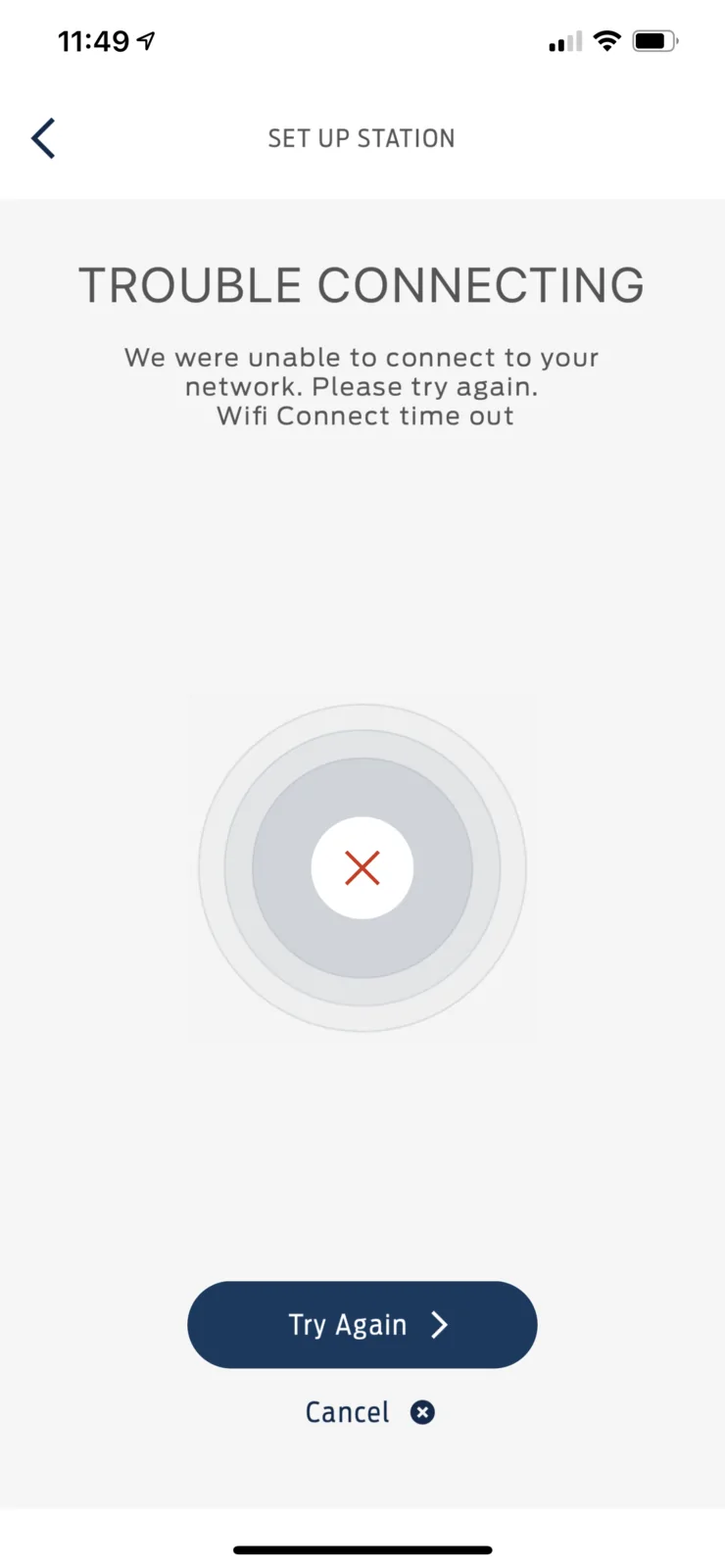

Has anyone been able to configure WiFi on this? The Bluetooth connection is flaky, but it will sometimes connect. However when I select a WiFi network and enter the network key (password) I always get “trouble connecting”. I’ve tried with both 2.4GHz networks and 5 GHz networks (and I have two different networks on each frequency - I’ve tried both). I also tried setting my phone as a hotspot (directly next to the charge station). No luck. I always get:
