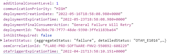

I'm still sitting on failed status for 2.6.0. I haven't seen any attempt for it to try again so I'm just playing the waiting game again.
My father-in-law got 2.6.0 and then 2.7.1 a day later without issue. I'm guessing he will get the next update today.
Yep, 2nd day later and I'm still failed with no retry. Granted 8 more hours before the 48 hour point from previous failure. I've wondered if they set it to not try more than once per day or per 24 hour period. dunno. @Gimme_my_MME seems to say he'll take a look maybe in a few days if mine is part of my continuing weirdness from the 1.7.1 fiasco.
I hope it's not related to the 1.7.1 issues that is causing issues with these updates. I don't want to have to take the car back to the dealership again for the 8th time just to fix software updates.
I'm getting a "General Failure, Will Retry" error, is this what you are getting as well? I'm curious to know if all the people having issues with 2.6.0 installing also had 1.7.1 problems.
No, I didn’t have any 1.7.1 problems at all, this is my first failed update. Maybe @Gimme_my_MME can clarify what failure actually means, I’ve seen people mention it just means it’s skipped cause some modules are already updated. What else can cause a General Failure?

Confirmed, "General Failure, Will Retry" is what I got also.
