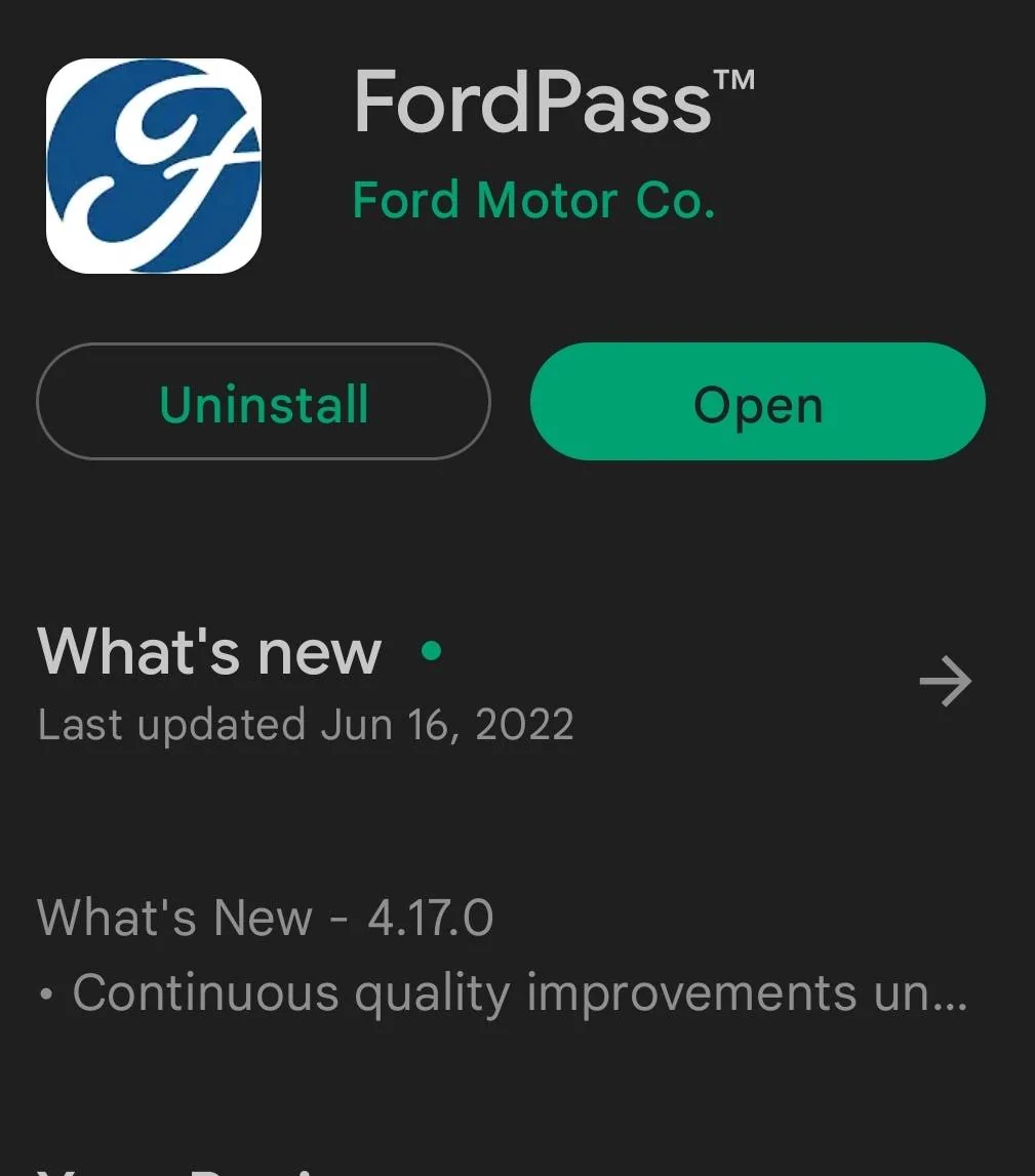

this is a silly question, but for the life of me, I can't figure out what version I have? I googled it and it says it should be at the bottom of the Account "page" within the app, but it's not...thoughts? tyia!! (FYI - I do see the trunk button, but it is not highlighted like "horn".

What is your phone? Apps store Play store search fordpass normally it will be displayed.

On an android phone it's inside the play store. When you find the app don't open it just press the icon.
