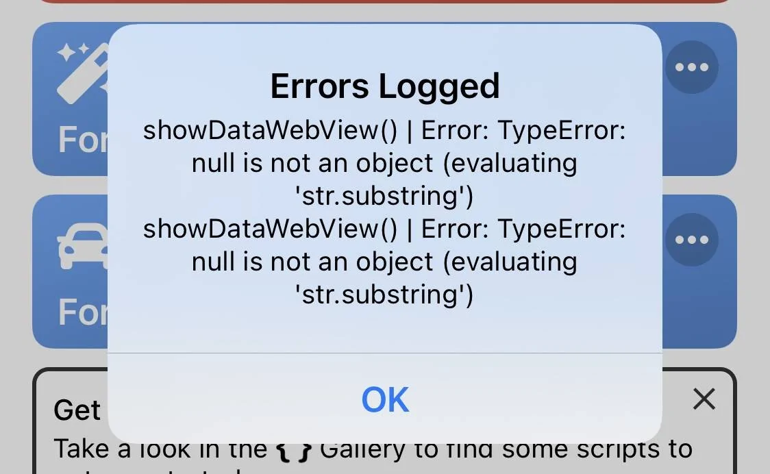

The widget is great. Thanks very much for the update. I deleted the existing widget tool (old version) and existing v 1.x widget then installed the new widget tool to get the new version of the widget to install and run. I like that it shows the current Sync version on the Advance Info Menu.
Things that aren't working for me:
  • The widget is appearing medium size, detailed style, light color mode. Changes I make in the View Widget and Widget Appearance menus do not change the size or appearance of the widget.
  • In Menu, "View Widget" - I can change the size and color mode and the changes appear in the pop up window but changes do not appear on the home screen widget.
  • In Menu, "Widget Appearance" - I can change Style and color Mode but they do not affect the appearance of the widget on the home screen.
  • Advanced info menu, "View All Widget Data, Tap to View" - Tapping to view does nothing.
Sometimes when I make changes to the view widget or Widget Appearance menus and then close the widget window I get the following error message:
Ford Mustang Mach-E FordPass - Scriptable Widget V2022.XX (iOS, iPad, MacOS) IMG_1173
Maybe I missed something in installation or I'm doing something wrong?

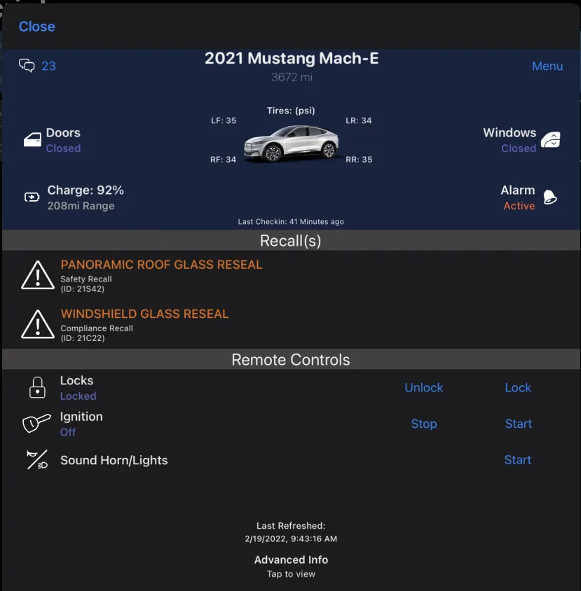

Haven't played with it much yet but it installed and is working fine for me on my iPad Air 4th Gen:
Ford Mustang Mach-E FordPass - Scriptable Widget V2022.XX (iOS, iPad, MacOS) 1645285279177

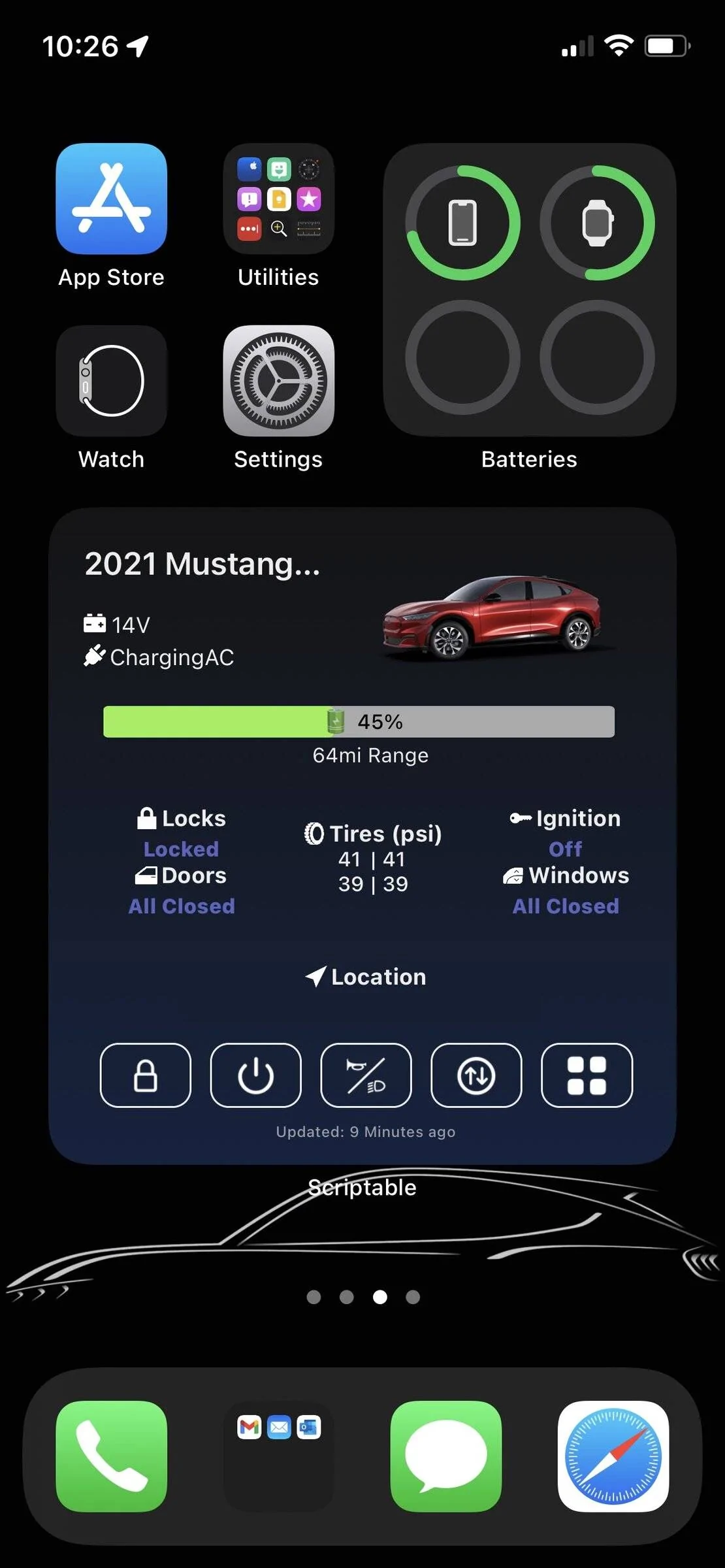

The large widget is working perfect for me with the last update! ??
Ford Mustang Mach-E FordPass - Scriptable Widget V2022.XX (iOS, iPad, MacOS) IMG_7865
