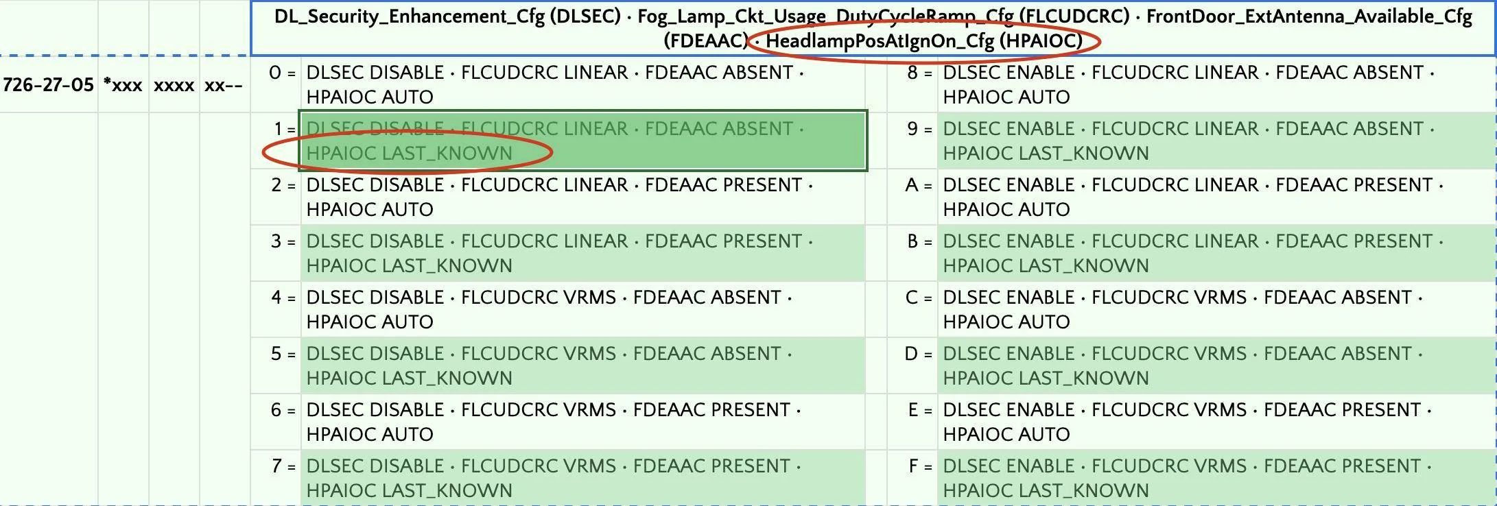

This is fun. If you turn the headlights off, they stay off at the next ignition cycle.
I had a 0, changed it to a 1.

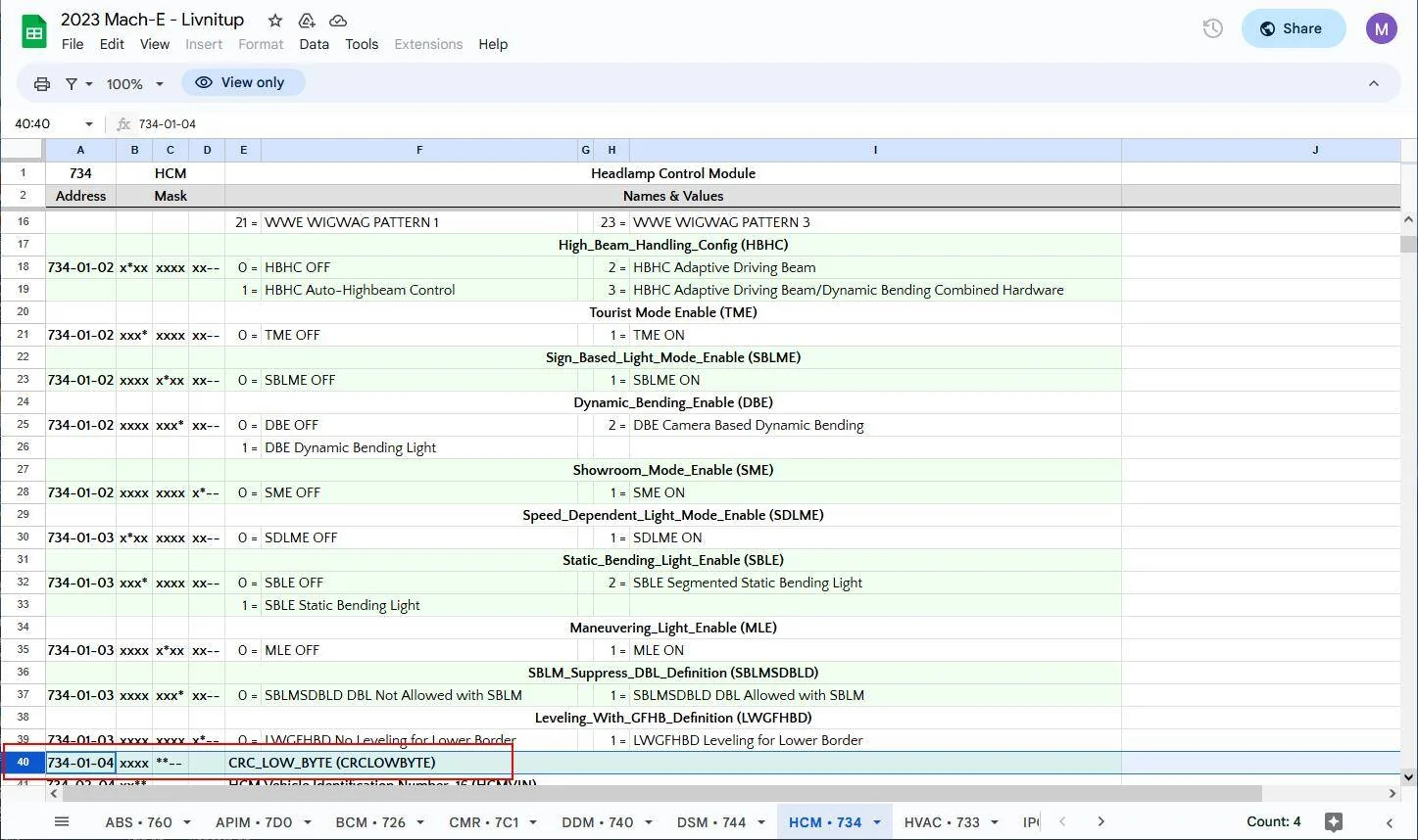

This is also fun...the Auto high beam ramp up that the later 22s and 23s have. Got it working on my early 22.
734-01-01 xxxx xxx1 xx--
734-01-04 00BC 1612 <-have to change your value to match this, or you'll get a headlight system error.
Tried it out and it works perfect. I have no idea what it'll do on a '21. But you must have a higher trim with the LED Projectors, otherwise there isn't a headlamp control module (HCM).
I have a question about this. The second set of data at 734-01-04...I don't have that in my asbuilt at all on either my '21 MME or on my '22 Lightning...and in the spreadsheet itself it seems to refer to something that's not actually a value that can be set. So where did that "00BC 1612" info come from?
i used the value from a 23 that I knew had the ramping high beams.

That was the secret sauce before a lot of these spreadsheets were published. I'd take entire as built configs and throw them in a text document, open it in Notepad++ and run a compare on them. It would highlight the differences and then it was just trial and error from there.

Understood. I just did the light ramp mod and while I was in there turned on the HD radio logos. While I've been using FORSCAN since 2012 (on my first F-150) and am comfortable with plucking digits out of Livin's spreadsheets I was scrolling through the APIM on the 'user friendly' version of the asbuilt and saw that and thought I'd give it a try.
There are lots of other options in the APIM that I kinda know about but didn't bother messing with. I've learned not to change too much too quickly in FORSCAN so that if something goes sideways you can figure out what you f'd up last and un'f it.
