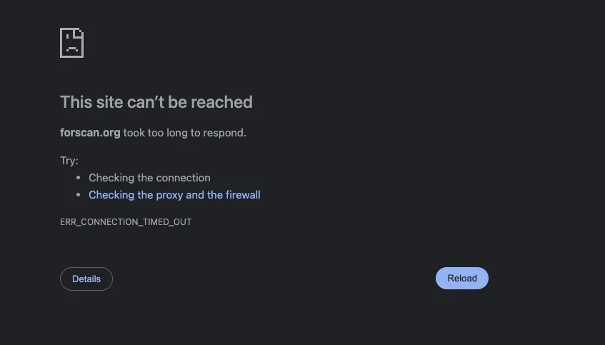

Trying to connect to my 2022 premium to enae the reve4se mirror tilt with forscan but keep getting this message pop up.
Any help please..
Any help please..
Mike, FORScan does not recognize your car because your PCM was updated so now the guys at FORScan need to update the software on their end.
With FORScan NOT running, go to the FORScan folder in your computer and open up the Log folder. Take the "dump.bin" and "FORScan.log" files in that folder and submit them to the support team at FORScan. Here is their email to submit to. [email protected] Explain to them them you have a Mach-E that is not recognized. They will send you a link to a beta version of the software for you to use. The next revised version of their software that comes out will include your car.
Thanks Mark for takeing time to give me this info..
I will give that a go when I get a moment..

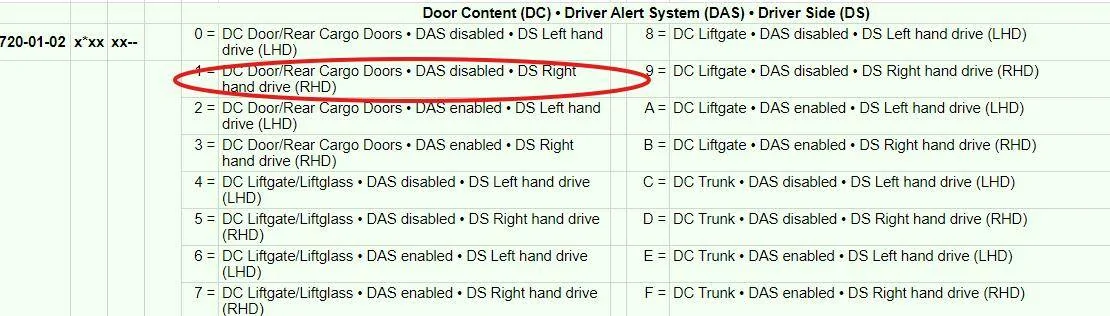

Wondering if this is the setting from our spreadsheet.
The 2nd digit in the IPC Built-in 720-01-02 Box is changed to a 1 if I'm understanding this correctly.
