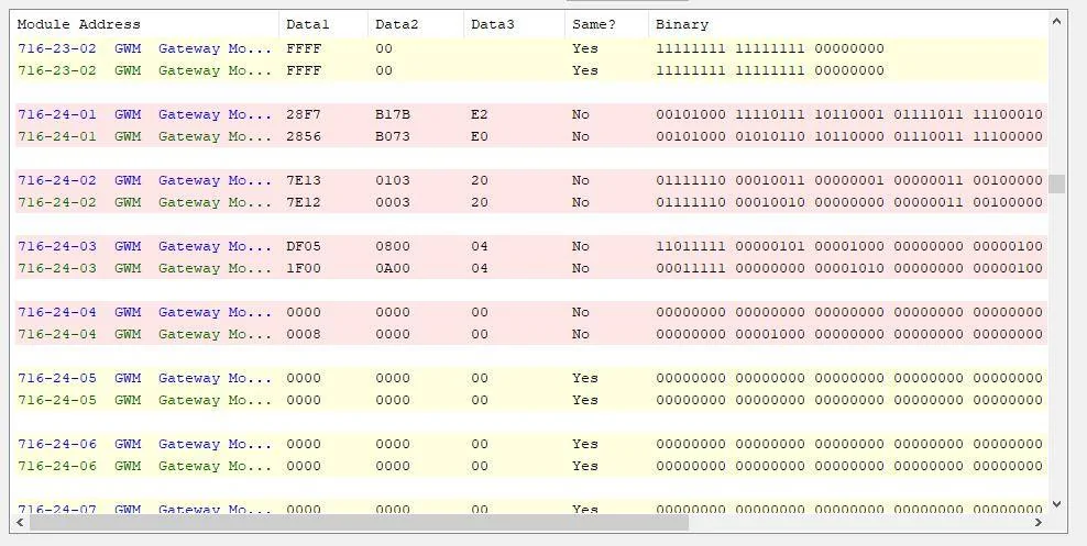

The GWM settings are not in the spreadsheet, nor can I find them elsewhere. As the gateway to other modules, there’s likely not much to fool with, but who knows.
Well I was curious to know what these gateway asbuilt differences are between my 23GTPE and a 24GTPE:
Ford Mustang Mach-E FORScan MME spreadsheet GWM_Asbuilt
I'm pretty sure Livin knows what these are....but there seem to be some settings they just don't publicize.

Well as I compare the two cars asbuilts I keep running into sections that are different between them (like the gateway, CCM, etc) and I thought it would be useful to know what those differences are.

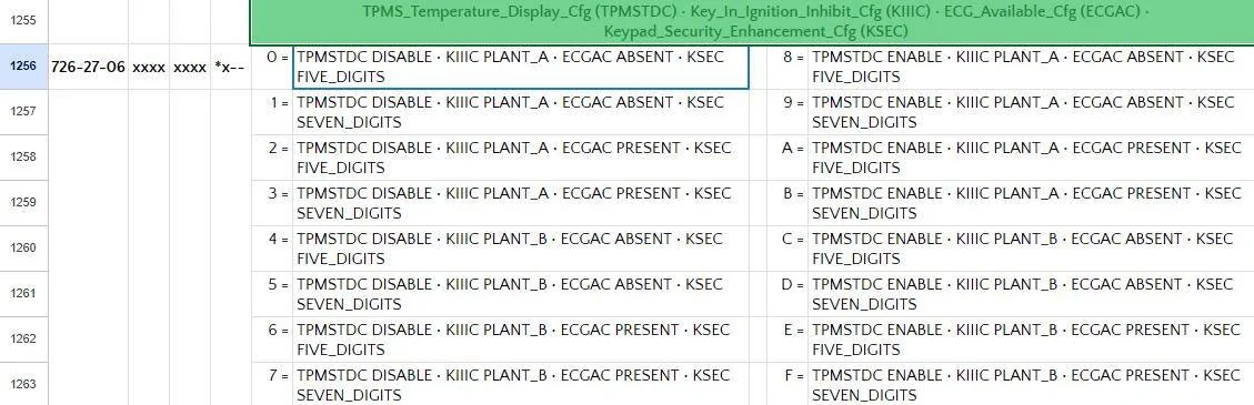

I just ordered an OBDLink MX+ (delivery tomorrow) to hopefully use with ForScan on my new Mach-E. I'm wondering if there is a way to change the keypad (on the driver door and used to unlock the car) to require 7 digits instead of only 5? I'm really not comfortable with only 5 presses of only 5 buttons...
It looks like this might be addressed around line 1255 of the BCM page of the spreadsheet, but clueless how to use this...
It looks mine is set to ”A”:
726-27-06 4B19 19B5 A22E
Find out what your current setting is, change it to be exactly the same except for the KSEC value. In my case, that would be B. Follow the recommendations by first backing up your module list.
