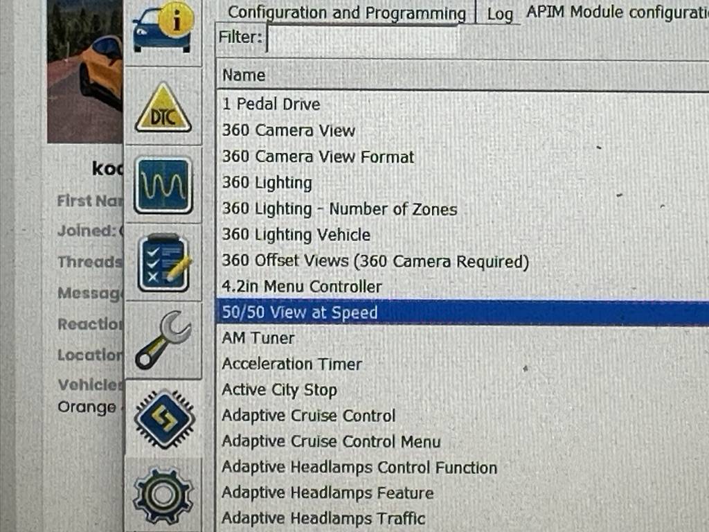

Did a number of Forscan changes last night - saw this in the APIM section:
Ford Mustang Mach-E FORScan MME spreadsheet FF148065-CA44-459A-8137-B11E154B8079_1_105_c
Any idea what it is or would do (if anything)?
markboris
Nov 13, 2019
5,840
16,708
Sonora, CA
Doesn't do anything. Many of the configurations have nothing to do with our cars and many require other modules to be reconfigured in order for a a particular setting to become active.
