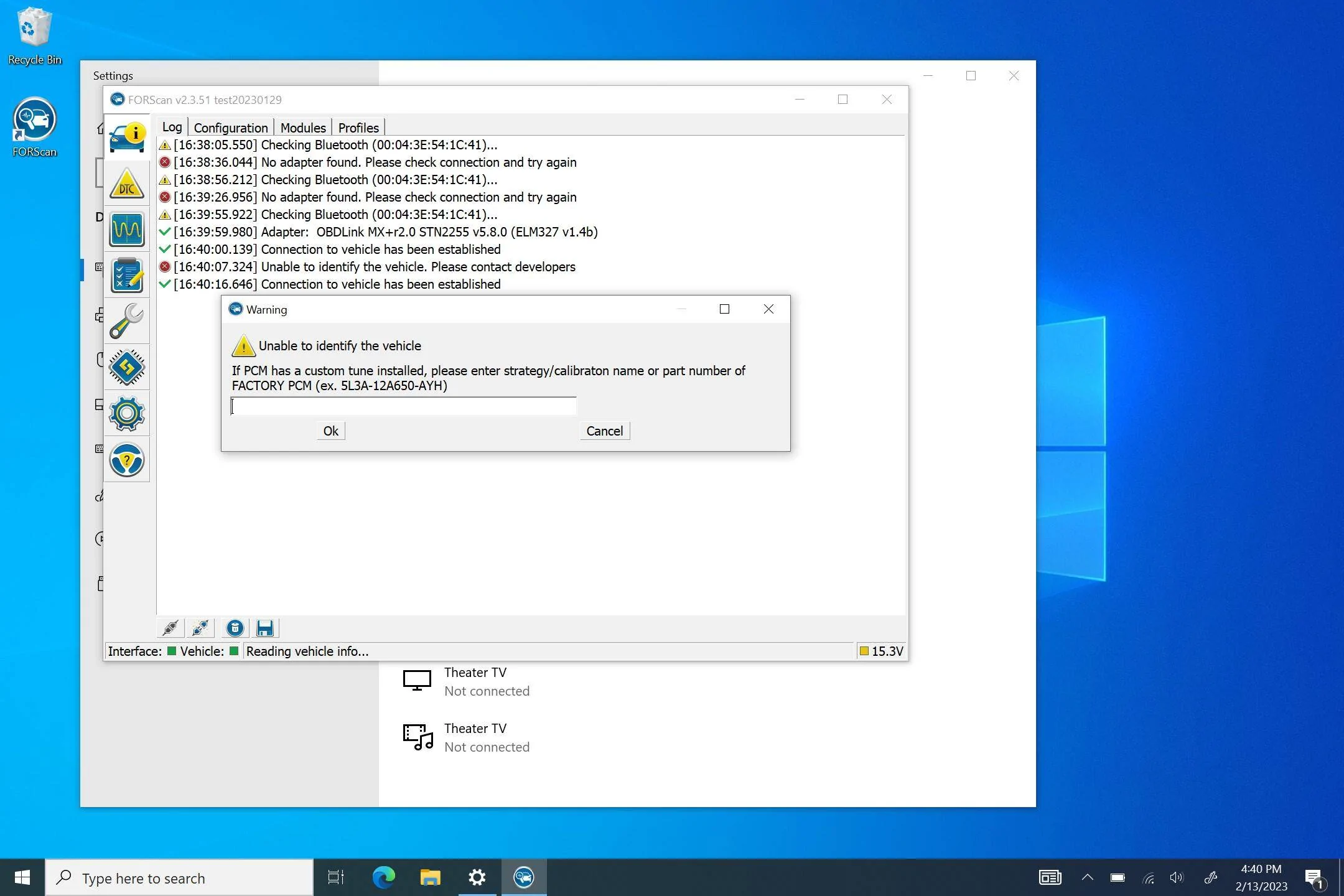

My first time using FORScan with the 2023 Mustang Mach-e, Premium.
I installed v2.3.51.test20230129
Paired the ODBLink MX+ with the Surface Pro
But I get this error message: Unable to identify vehicle.
Any suggestions?
Any suggestions?
I had the same problem. I contacted Forscan - they asked for my VIN and sent me a new version which worked. They were good to deal with.
