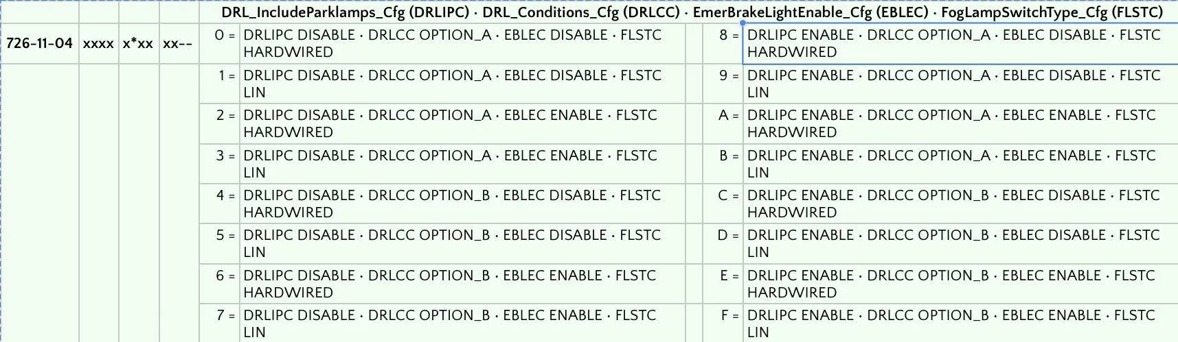

On my 2022 F150 I can have the taillights on when the DRLs are on. Does anyone know how to do this on the Mach-e? In the BCM module I see 726-06-03 and 726-06-04 have DRL settings but no description as to the function.
LaFong
LaFong
Nov 1, 2022
166
139
Colorado
Mustang Mach-E GT 2024 Vapor Blue Metallic
Systems Engineer
Looks like it’s 726-11-04 (DRLIPC ENABLE)

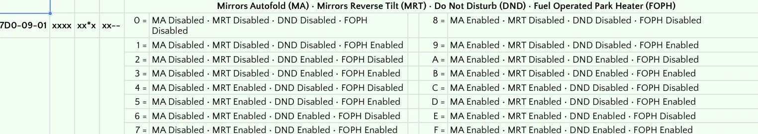

Our April ‘21 build of a SR Select had a menu screen that showed folding mirrors which I promptly turned on. Our car sheet showed heated mirrors but not folding heated mirrors so.. then an OTA update fall of ‘21 possibly winter of ‘21-‘22 resulted in that feature “disappeared” from the menu (as was “intelligent” driving mode and likely other choices I’d no clue about). The mirrors folded perfectly so actuators are there. Probably the bin of heated mirrors was empty so we got the “unofficial supply chain squeeze upgrade” ?!
Our dealer rep suggested that it’s probably possible to turn the folding mirrors back on though I’m ok just leaving well enough alone. He did mention… “Forscan” expert could probably help…
There is a DIY thread on how to do this. It's really simple to do.
