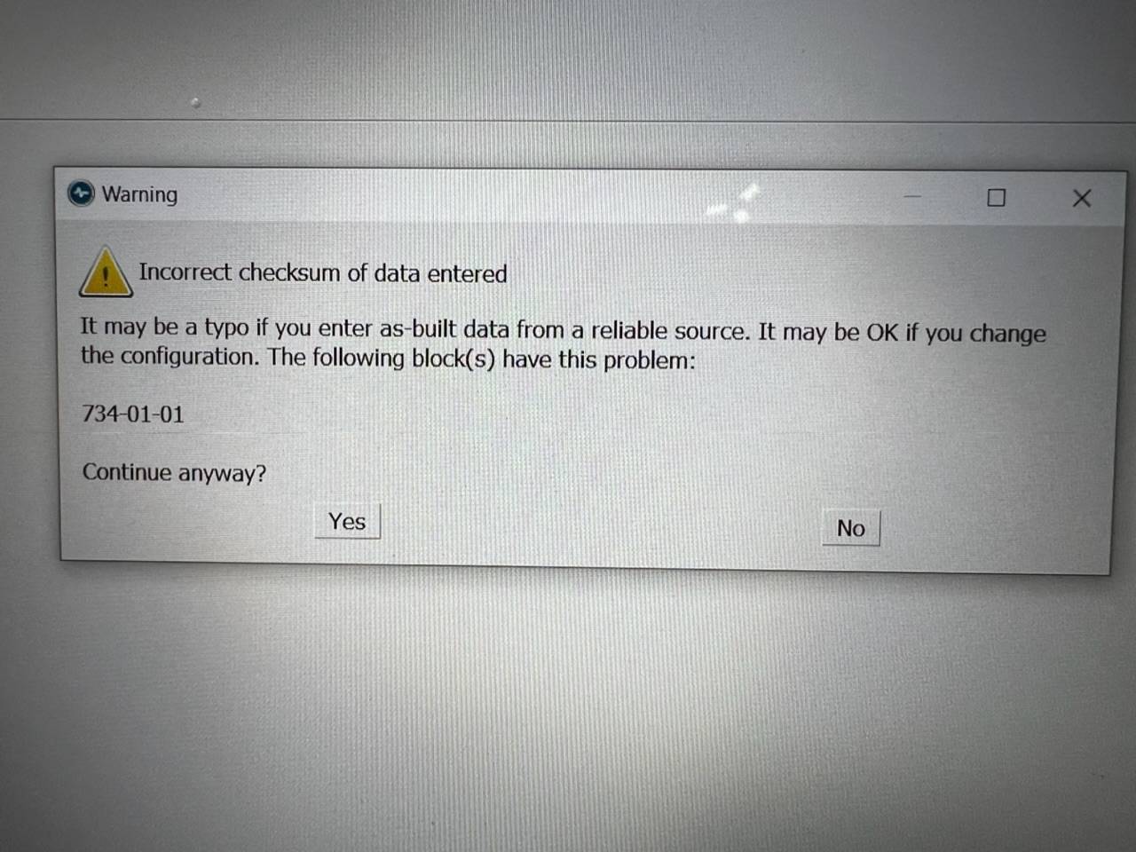

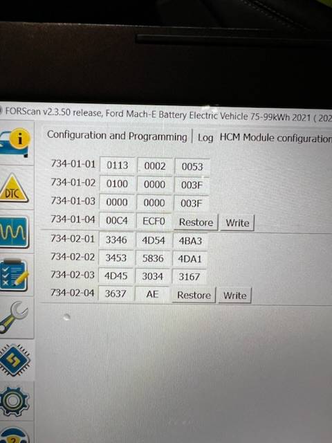

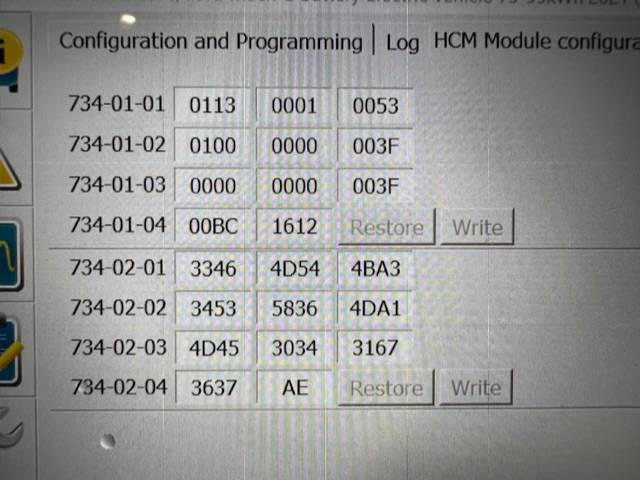

Asking the smarter folks in the room. I tried to follow this on my 2021 job 2 GT. And I got a checksum error. Does anyone see what I did wrong here?
original config^^^^
my attempted changes ^^^^
The error I received. Maybe I’m supposed to acknowledge the error and write it anyway. But I’m being a chicken?. First time I’ve messed with Forscan at all and I’m terrified.
I suggest you write down what your original configuration line was, and then go ahead and "continue anyway". The checksum simply alerts you that at least one value in the line had been changed... it is the safety check if you will before writing the new configuration parameters.
As long as you have the original configuration line values written down, you can pretty much revert to them on the next WRITE session if you so choose.
original config^^^^
I have a 21 GTPE job 2 car and it works. Just click yes and write it, then enjoy!
