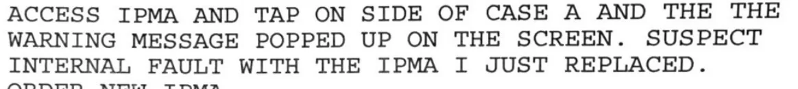

I don't think this is software. I think its more like a communication error between the camera module and the rest of the cars functions that use it's info. May be something with the windshield reseal causes the connector or wiring to be stressed or shake on the module. Perhaps a clamp or shroud replacement. Being it sets different TCs after a removal and replacement. note this;
Ford Mustang Mach-E Front Camera Fault & Pre-Collision Assist Not Available Errors 1663692623938
Pretty much help to narrow it down. Especially since the system is so sensitive to line paint. That will make a lot of false reports.
