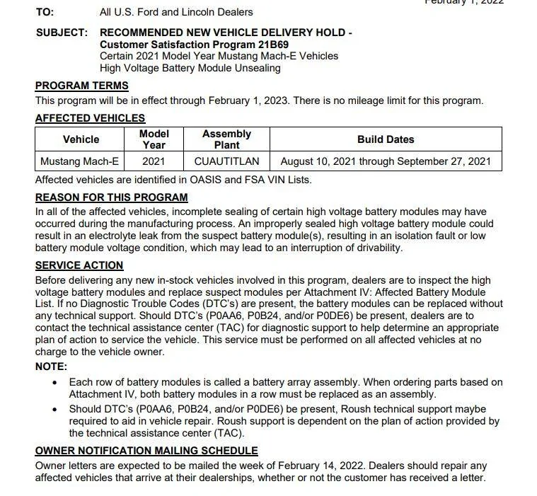

I am in the same boat. It’s been 17 days and they can’t get the charge to level out. Now waiting on a new BECM(battery energy control module). They think it will be in on Monday. When we hit Tuesday 4/19 it will be 3 weeks without car. Ford said that last resort would be to replace entire battery pack. I asked.
My dealer has been great, but want to forewarn everyone that ford will only cover rental for 14 days. After that you eat the cost. I am so tired of fighting I just turned the rental in.
Finally, after 3 weeks of no car and possibly longer I may do the same sell the car while it’s hot and look for another EV, even though it pains me to even think this since this is a great car.
UPDATE: After 3 1/2 weeks got the GT back. Apparently after replacing the batteries it ended frying some components including the BECM. They replaced the components and that fixed the issue. All the batteries equaled out charge and car was able to charge to 100%. I am nervous and will keep a watchful eye on the car, but hopefully no more issues. Thanks for all of you and your advice and support. Just make sure if you go through this process you provide your vehicle with a charge at 20% (As stated in another post) and if the batteries won’t equalize tell them to check the BECM. Good luck out there. Still love this car.

Took my car in for a front passenger tire replacement last Monday, 5/16. I hit a small curb and it burst open like a balloon, and while waiting for the OE tire (took 3 days), the dealership ordered the battery modules for the 21B69. Service Rep initially refused to give me back the car after tire replacement saying the technician claimed "it was a safety issue, cannot release the care before battery module replacement". I insisted, showed the CSP letter and all the documents shared by ChasingCoral (thank you) and was grudgingly handed back my car late Thursday.
Got a call that parts came in on Tuesday, 5/24. I turned in the car @ 19% battery Wed early morning. It was moved into service bay yesterday, Thursday, at 11:30 AM and the service rep texted me that it will be ready today, Friday, COB. As of 3 PM today it is still showing 18% battery. Is the repair that quick that it can be finished over less that 2 days? Don't they have to charge the battery and ensure balanced charging etc.? Can anyone weigh in on this?
As you can tell, the whole experience so far with my dealer has me quite leery re. their ability to fix this correctly. I requested some photos of the car/parts/battery during repair, but no response. On the +ve side, I got a loaner, a brand new Ford Edge. Keeping my fingers crossed.
