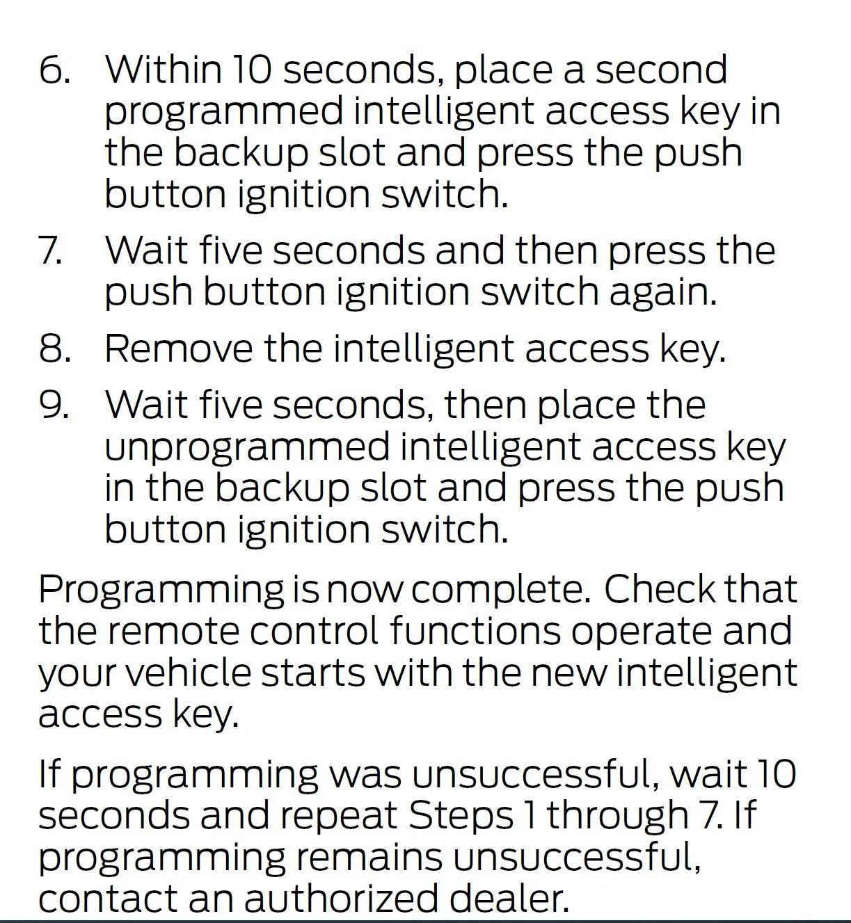

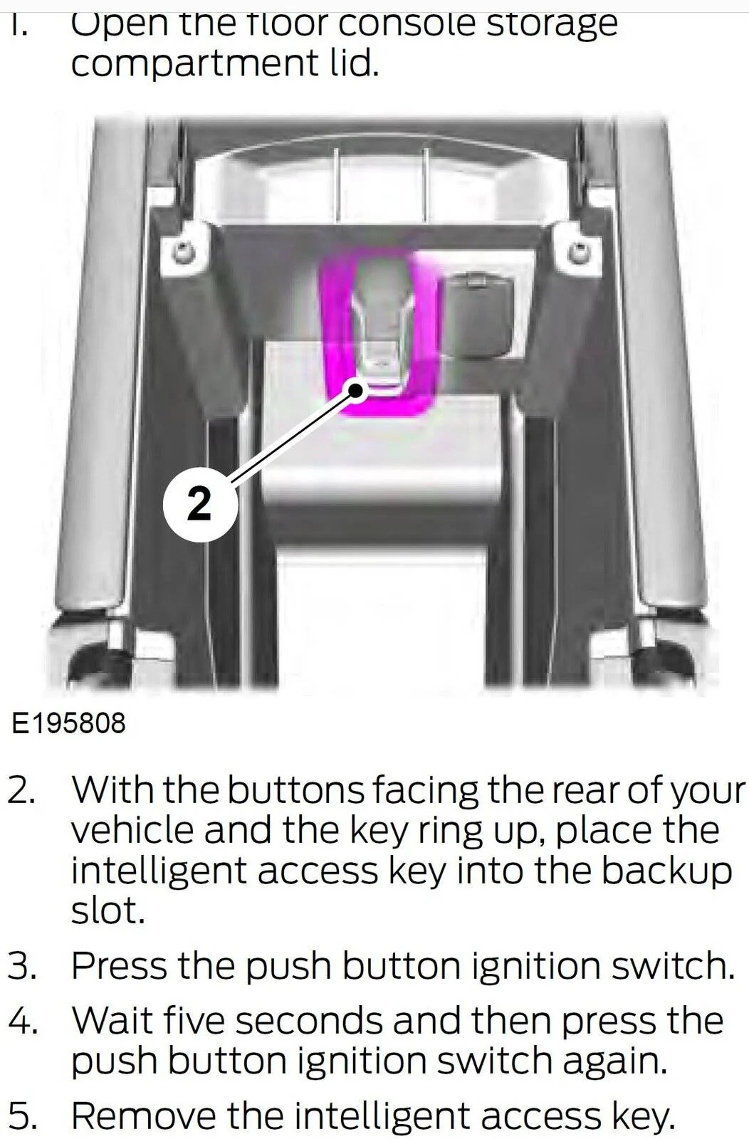

You can program your own fob on the MME. If you already have 2 programmed fobs. At least according to some posts on here. I haven't tried it.
1) Where did the second fob come from?
2) Where are the programming instructions in the MME Owners Manual?
Here are the rest of the instructions for an Edge. I don't see that in the MME manual.
Ford Mustang Mach-E Getting a second fob programmed edge2
Ford Mustang Mach-E Getting a second fob programmed edge3

The instructions are the same for the MME. They are likely not in the manual because the car only comes with one fob. ;)
