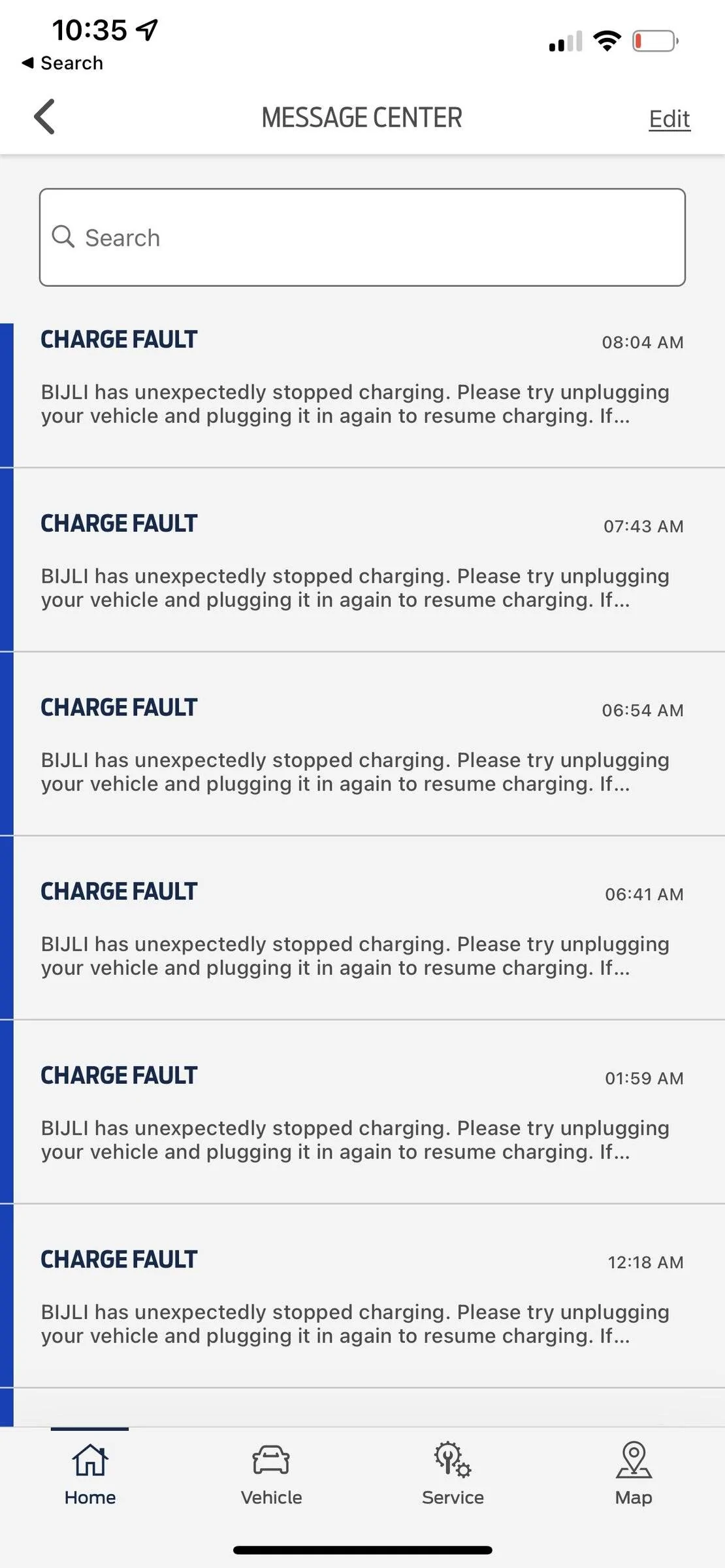

I am getting charge fault errors all the time. Using 240V 50A ford default charger at home. This is making me nuts. Any of you guys know about this issue. I have a service planned this Friday but for now I have to remove/insert charger again and again throughout the night. Attaching msg center pic.
I suggest you search the forum for that since it's talked about a lot.

I tried on one of them. Didn’t find a lot but do guide me if you know one. These faults are from default home chargers and not DC fast charging.
Trying to get some ? for solutions if you let me

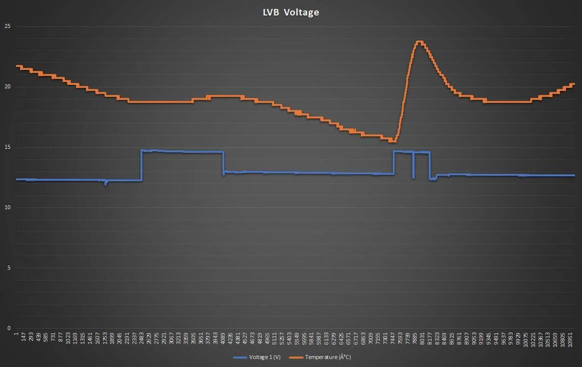

EDIT: I originally conflated HVB for LVB and didn't pay enough attention to the post being made. The 15% SOC was for the HVB and there's a post where an engineer from Ford actually said it's 12%, not 15%. Either way, I was assuming that comment was based on the LVB. I have modified my below response slightly to make up for this mistake.
The LVB normally hovers around 12.3V-12.8V even when it drops below the 40% SOC it doesn't normally engage the 12V maintenance until it gets much lower. There's quite a lot of uncertainty as to when exactly the DC/DC kicks in to maintain the LVB.
The two spikes below (12 hour snapshot) are charging and driving respectively. I monitor my 12V and record data on it every 5 seconds. I've never received a warning about LVB drain unless I force it to happen. Also, between the first spike and second it was on the charger. Keeping the car plugged in as some suggest doesn't mean the LVB will be continually fed juice from the charger, that's just flat out wrong.
Ford Mustang Mach-E Getting really really PI**ED OFF 1644869010279
You can see below where there's a couple 11V readings. This was because I approached the car with PaaK and the welcome lighting came on. The car didn't engage the DC/DC and it recovered once I walked away and it turned off.

It's definitely not 40%.... The misinformation in this thread is wild.
