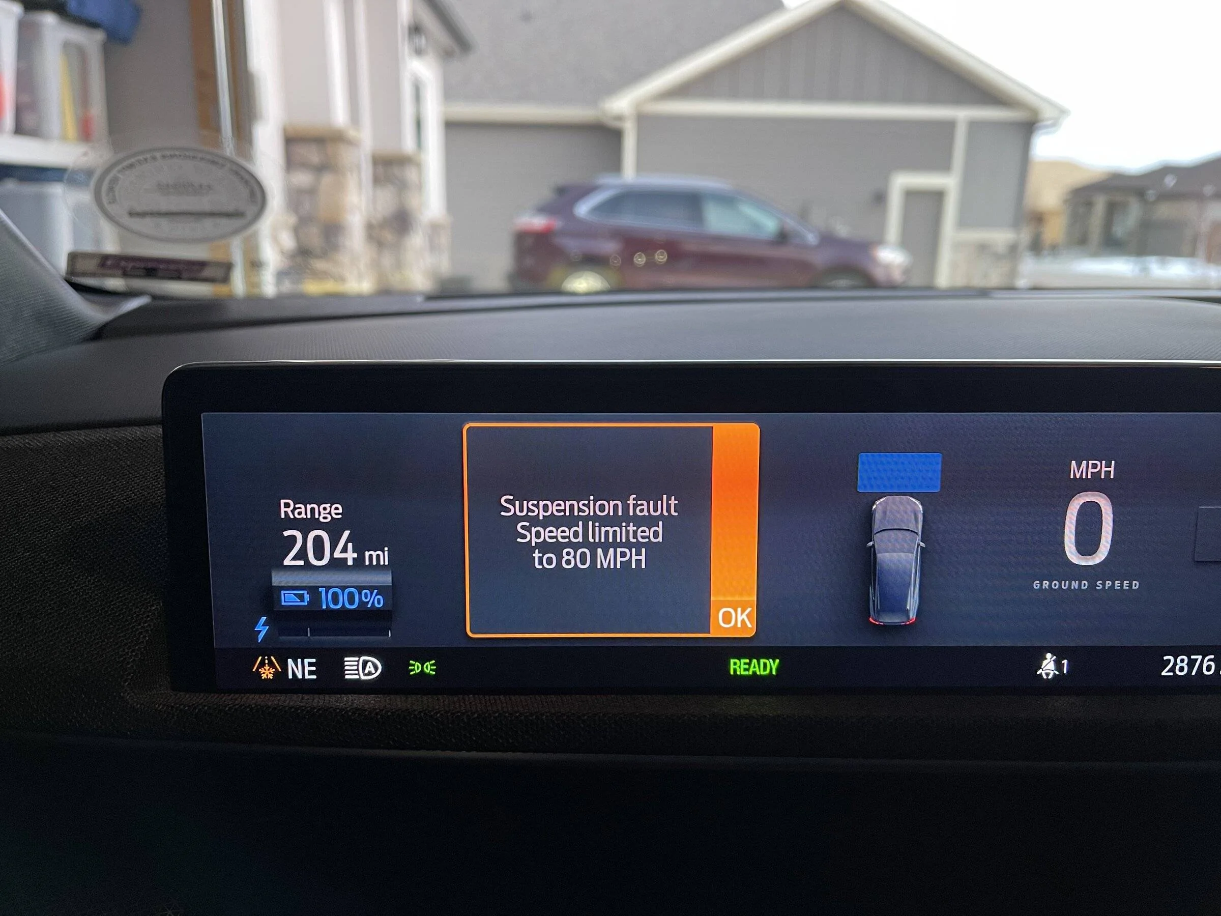

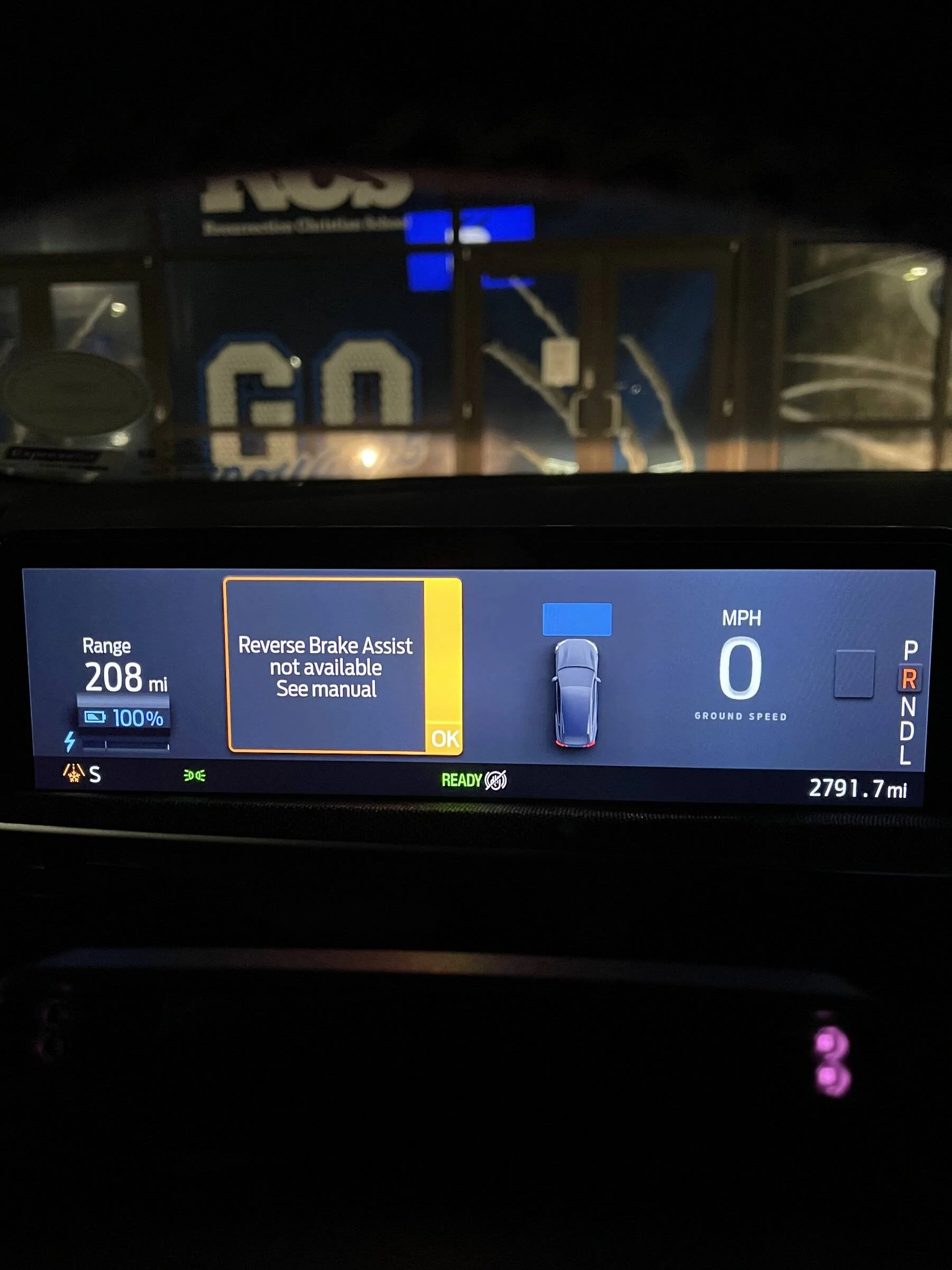

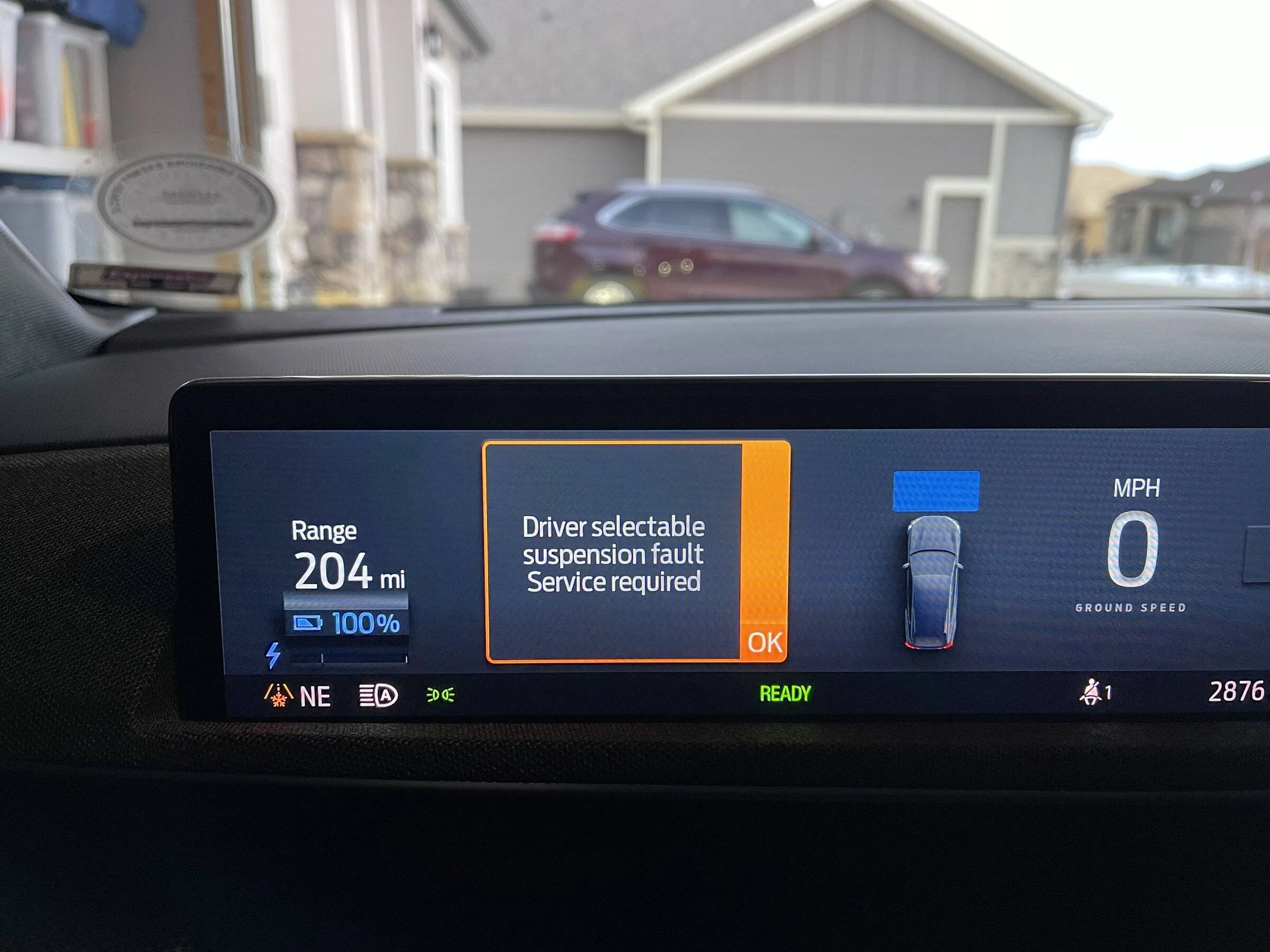

Man, I feel for you because I’m there too! In the shop again. This is the 5th trip for the same suspension default and now a new reverse assistant issue. I’ve started a claim with Ford to return the car. Sucks because I got it (GTPE) in August and I’ve put on less than 3k. I love the car but it can’t stay on the road. Bummed! Oh, and you see that lame Edge in the background. That’s been my loaner for the better part of the last two months.

Most people with this issue are living in extreme cold regions. This is the first time I heard about the same issue in Florida. Mine worked with no issues in summers and as temaratures dropped, this all started
puzzling indeed......
I'm wondering if there might be some non-waterproof connectors that are suffering from salt/water intrusion as well as the cold weather people suffering from slush/salt intrusion ?
I'm thinking that with the big gaps around suspension in the wheel well, and an almost sealed belly, the combination of water/salt sprayed on or piling up on the HV connections at the front of the HV battery might be a problem if the HV connectors are less than perfect.....

You have to keep it in perspective. Globally over 70,000 MMEs have been sold. If there's 10 people here that we know of with issues that's a fraction of a fraction of a percent. Obviously there's people who don't participate in the forum, but even if we took 10 of the 8kish members we are still talking about very very few.
..... just looking for what could possibly be similar with the ones having problems ....
it may not be cold as much as salt+water if there are not similar problems popping up in FL.
I am getting suspicious of the HV connectors; 450+v DC will arc like a mother if given the opportunity and a path with a bad/unsealed connection.

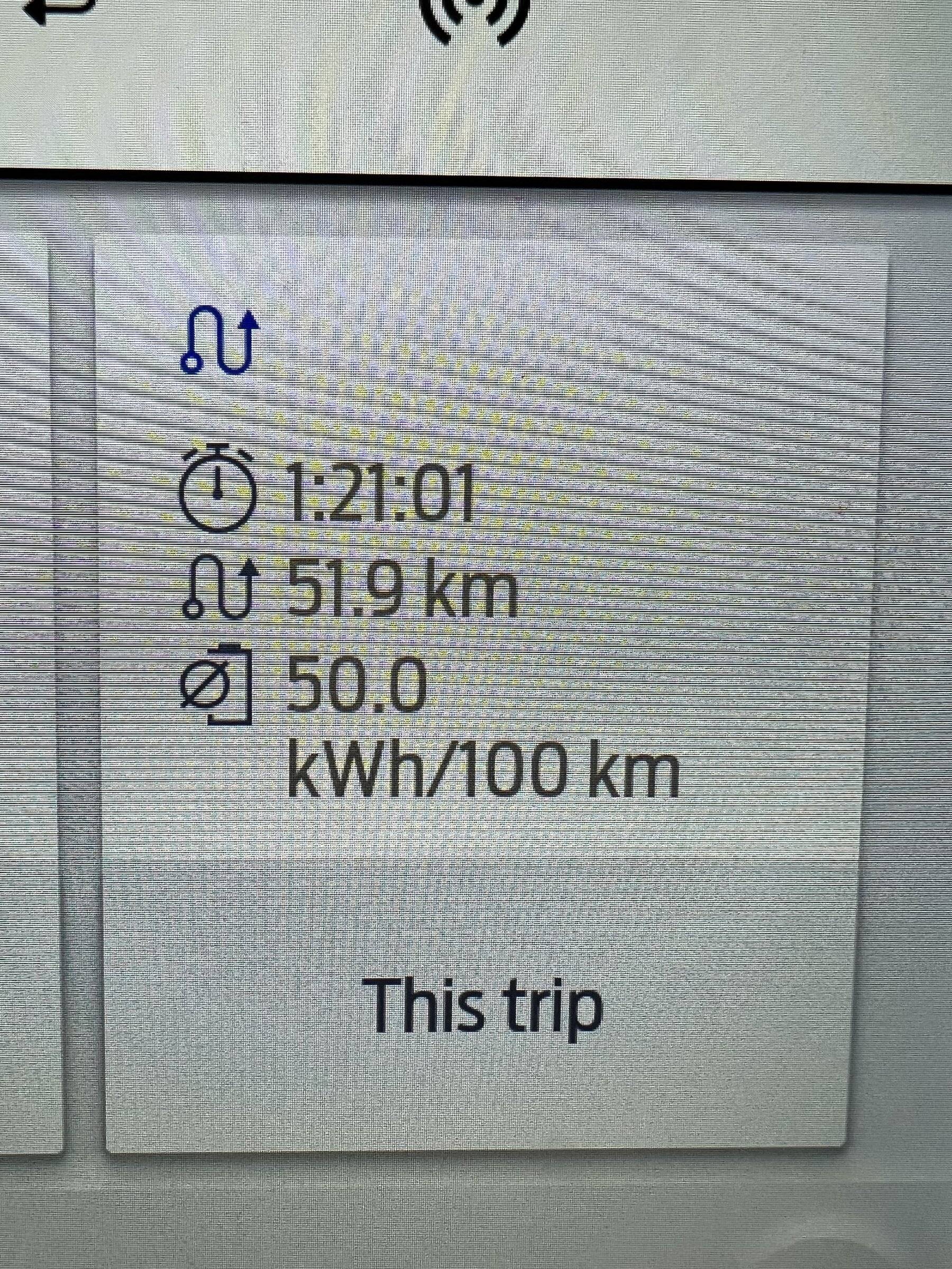

I have a Mach E premium and I also experienced same problem. I thought it was due to severe cold in Winnipeg. Now I know it wasn’t the issue.
Just to inform you that I did a factory reset and turn off my car for a while and restarted it. It worked for me.
Anyway, now some other problem started. My Mach e battery drains faster than others (might). Just to give you numbers, to travel 25 km, it drains 16-20%.
Is anyone facing same problem?? Should I be worried. First of all I have a range anxiety on top of that this problem. Started hating Mach e.
