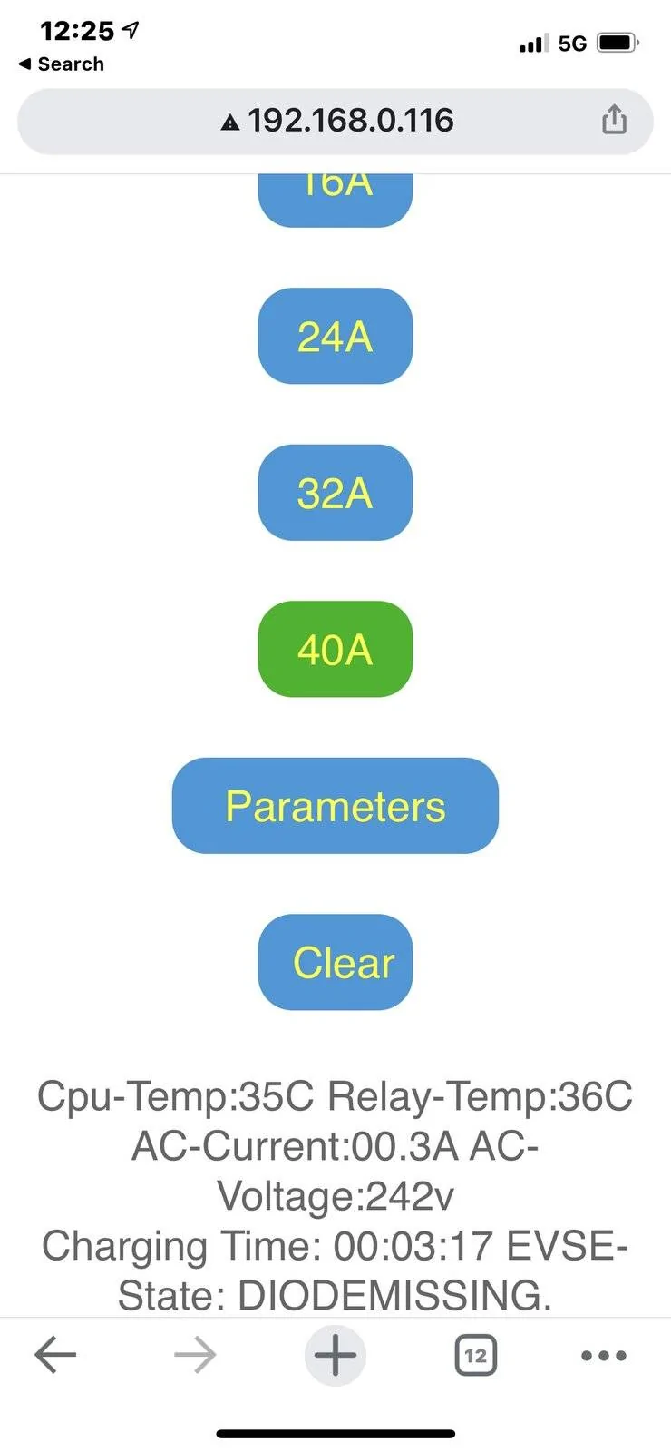

Looks like there might be some compatibility issues with the Mini. I've gone through two of them, one was my original order and the other was a replacement that was sent when I reached out to support, and both gave me a DIODEMISSING error when trying to charge both my Mach E and my Bolt. I'm waiting to hear back from them as to what the next step is but at this point I'm hoping to just get my money back and move on.
I have contacted United Chargers several times but to date just recieving canned replys with no resolution. Have you been able to return you charger for a refund or one that works? I ordered mine directly from their website, not Amazon in May of this year. I am getting no where in trying to resolve this issue.
