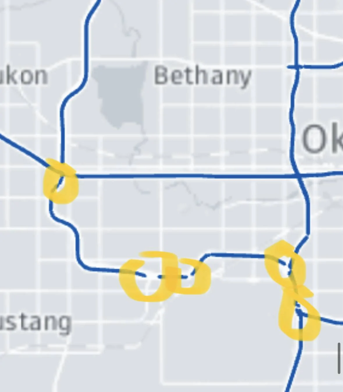

I also drove these areas last night and it makes sense why there are holes in the blue route. Those are where paths merge or diverge so logically, it would be safer to hold the wheel in those areas.

Interesting. You should know there is a delay after entering a BlueCruise highway before it will fully engage, during this time it monitoring if your lane position is stable or if you are following another car too close. This could take 10-15 seconds. So if your lane position isn't stable or if you're right behind another car it won't engage.
FYI here is the map website instead of zooming in on that one picture: https://www.ford.com/technology/bluecruise/

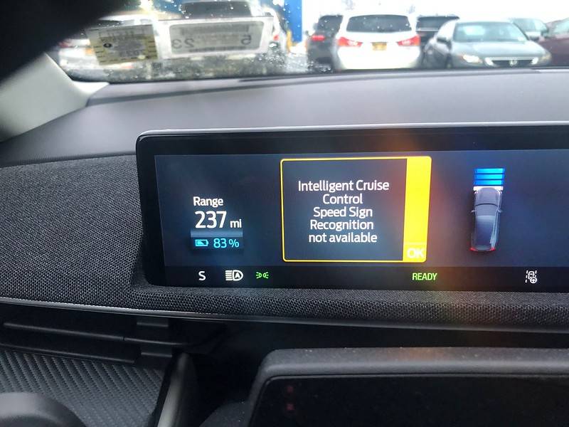

Of of the blue (pun intended) this popped up today when I first activated ICC on my morning commute. Never, ever had a problem since I got Blue Cruise working last Spring. I recently got OTA 4.1.2 three days ago. This thread popped up when I did a search.

Your windshield looks dirty in your picture. Make sure the glass is CLEAN in front of the windshield cameas. Then turn the car off for a minute and see if the error goes away.
I had the same issue right before I washed my car.
It's been worse but I will clean it off before I head home after work.
Well, I cleaned it but it wasn't bad at all. When I clean my windshield with the wipers, it swipes the camera area. Anyway, BlueCruise worked fine all the way home with Interstates I used.
