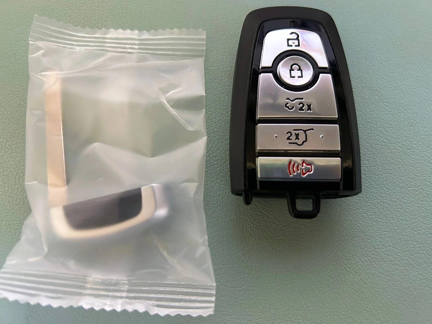

I’ve never had a hands-free liftgate that works by waving your foot but it seems easy enough to understand. Except it doesn’t work on my new MME. I’ve tried scanning the QR code (doesn’t scan), and checking the settings on the in car manual. Really not sure if this has to be activated or if I’m just using it wrong?
My 2022 Premium had it installed but it wasn’t activated. I’m guessing the assembly line wasn’t updated in 12/21 when mine was built.
I was able to activate it with a pair of programming changes, one to activate the hardware and another to add the feature to the touchscreen.
But as it turns out, I don’t use it so it’s turned off.

That’s because it doesn’t have the feature. The plaque was too expensive to change.
Admittedly there would be a small expense to have their supplier alter the label, and perhaps even a small price increase, but had they gone that route they would've/could've/should've recouped the $. Instead, and ignoring IATF 1699 Quality Management System Requirements regarding obsolecence, documentation and customer satisfaction, they left everything as is. It's all about money, always has been, always will be. I spent a career fighting the corporate juggernauts and holding manufacturing to Quality System Requirements (say what you do, do what you say). I've shut down production lines many, many times over failure to 'do what we say'.
As you've learned by now the hands-free function doesn't exist. There's lots of posts about this subject, including mine:
https://www.macheforum.com/site/threads/i-wrote-a-letter-to-ford-and-they-actually-wrote-back.42096/
I actually wrote to Ford expressing my dissatisfaction and they wrote back (twice!) basically saying, "Yeah, we know...oh look! squirrel!...have a nice day."

It wasn't active on my 22 premium, built in June, so I enabled it in FORScan. I use it quite a bit but it does open from time to time when I'm walking up to the car (up to 30' away). This hasn't caused any issues, but it's definitely a bug that probably won't be addressed since Ford doesn't support this feature any longer..
