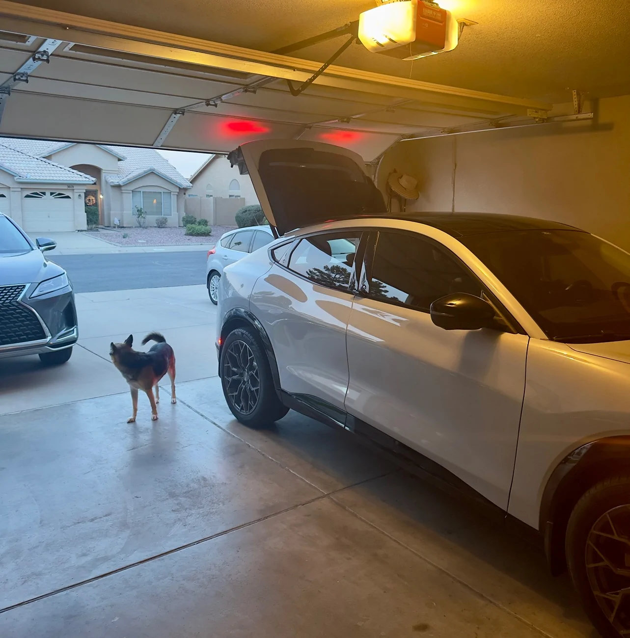

Un freaking believable I went to go take the dog for a walk and he darts underneath the garage door. Apparently he’s tail swings past the kick the open trigger for my car both the garage door and my hatch open up at exact same speed and don’t cause any damage to each other. Here’s a picture of my dog looking guilty as shit.
Being canine, how do you know your dog doesn’t do this for amusement? 😁🐩
Usually he does, but shoots out the middle and heads to the middle of the front yard. His public display of freedom. Which pisses off the golden lab across the street barking at him through the window.
The proximity changed for sure. It was working pretty well after that unlock zone change, then it kinda quit. I pulled the negative terminal when I was doing the spring and it appears to be back to 'really far away is ok' mode as I didn't move when I took the pic. Neighbors golden came over yesterday and rummages around the garage. He opened the trunk 5 times with his tail. Never once going under the car. Granted now that's lifted it's got a lot more available kick room.
