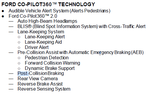

This is exactly the scenario my wife asked me about.
What happens if the foot is near accelerator and someone rear ends you.
I am wondering if car has any crash sensors that would disable acceleration in an accident?
The Mach-E, as part of the Ford Co-Pilot360 Technology, has Post-Collision Braking. This brings the car to a complete halt after a collision.
Generic info:
How Post-Collision Braking Works
Unlike pre-collision warning systems, which use radar and cameras to monitor the road ahead to detect frontal collisions before they happen, post-collision braking goes into effect in the milliseconds following an initial impact.
Airbag deployment or fuel cutoff are the signals that the post-collision braking system should engage. When either of these things occurs, the system knows the vehicle has been in a collision and immediately initiates braking to provide a moderate level of deceleration to prevent the car from rolling forward and hitting another object.
However, the driver retains control of the accelerator and brake, allowing them to override the system at any time. In addition to slowing the vehicle down, the post-collision braking system will activate the flashing hazard lights to alert approaching drivers of an incident.
Post-collision braking systems operate under certain rules and prerequisites:
  • Since abrupt braking at high speeds can result in even more severe secondary collisions, the system will not activate if the vehicle speed exceeds a pre-determined limit. Each automaker sets the upper speed limit for their individual system.
  • The system will deactivate if the driver mashes the accelerator pedal. The system will view this action as an attempt to avoid secondary collisions with other objects.
  • The system will deactivate once the vehicle comes to a complete stop.
Post-collision braking is usually not applicable in low-speed accidents on side streets or parking lots. In those “fender bender” situations, the vehicle generally comes to a halt at impact.

This is a great find. Thanks. I somehow missed that after my first read of the manual… continuing my second read…
267
17,962
28,006
If you find it in your second read, let me know. Because it's not in there... HA! :D
It's in the Order Guide. It's not in the manual. That's what I cut and pasted from.
Edit: Also on page 269 of the manual.

Page 269 under post-impact braking. It’s awesome. I wonder if the 1-P drivers still need to hover over the brake when they are stopping. But that’s also trusting the system a little too much…
267
17,962
28,006
Ah. They took out the hyphen, that's why I didn't find it with search in the PDF. I did remember reading it, then found it in the Order Guide.
POST IMPACT BRAKING
How Does Post Impact Braking Work
In the event of a moderate to severe crash, the braking system reduces the vehicle’s speed in order to prevent or reduce the impact of a potential secondary crash.
Post Impact Braking Limitations
Post impact braking does not activate if any of the following occur:
• The anti-lock braking system is damaged during the collision.
• Electronic stability control is disabled.
Overriding Post Impact Braking
You can override post impact braking by pressing the brake or accelerator pedal.
Post Impact Braking Indicators
It flashes when a post impact braking event is occurring.
