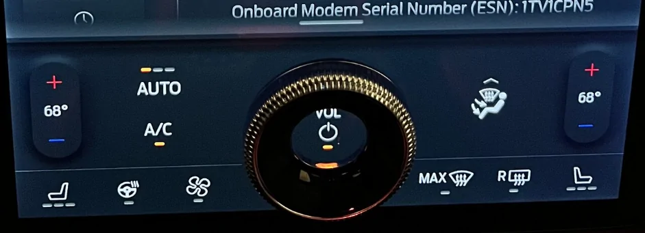

Dear Ford if you are listening, I implore you, don't add "climate off" to the Auto button. This would make no sense at all.
Okay, then how about a "climate off" button right next to the Auto button? They're already adding an A/C button below it. Why not one more?

I think this would be VERY confusing. I can't think of another car at all (and I rent a lot of cars so I have experience with many different makes) that has the auto button turn the climate off. In fact, most cars you can't even "disable auto" with the auto button. It's just there to turn on Auto and in a few cars, to adjust the aggressiveness of the auto function.
If it works the same as other Ford's auto climate systems, changing the fan speed only takes the fan speed out of auto, the vents that the air is flowing out of and it's temperature is still automatic. Same goes the other way. If you force it to come out of a certain set of vents, the auto light will turn off but the fan speed will still be automatically controlled.
Or just rename it auto/off. Or add a separate off button next to it. Either way I don't think it is very confusing personally.... 3 bars 2 bars 1 bar 0 bars....
Wow, logic. While I love this solution, it ain't happening. It makes too much sense. ??‍♂?
That could work. Or, switch the A/C button to be some sort of toggle between A/C, Heat, Auto and off. My thermostat at home has these options. In an EV the A/C and Heat are the things that are robbing you of miles. The circulation fan is such a small amount of energy, leave that on. Just kill the part that's sucking battery.
The fact that there is a quick off for the A/C and not the heat is just a hold over from ICE cars where there was no option to turn off the heat.
Yeah, that would be A/C and E-Heat. I just want a quick way to turn those on or off without going into a separate menu. Adding the button for A/C is a good start, but if they just made that button a climate on/off button it would provide better functionality (for me).

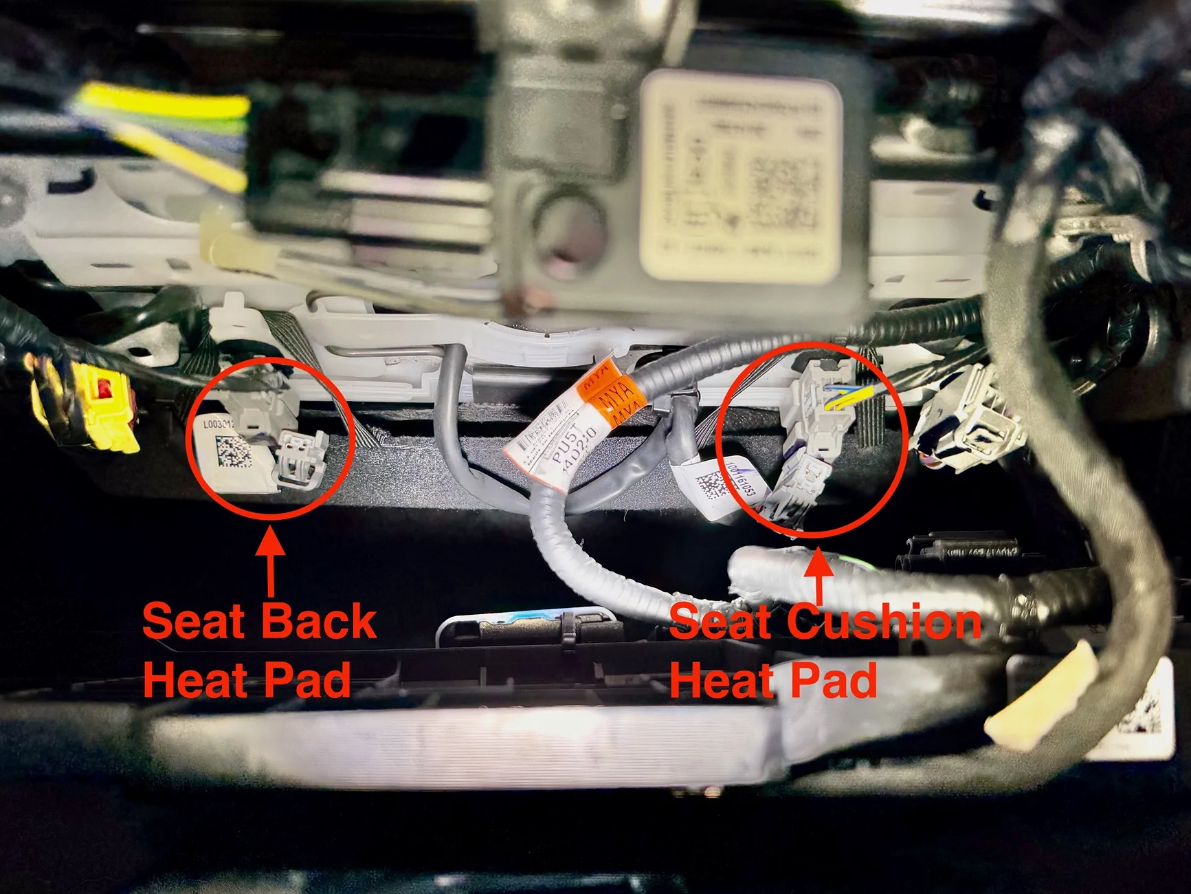

If OP or anyone is interested in disconnecting the seat heater for the passenger, the photo below will help out.
Looking at the circled areas, I have purposely disconnected the connectors out of their sockets. You can see the connectors hanging down below the socket. To disconnect there is a tab on the connectors you push in and at the same time push it back out of the socket. Make sure you lift the seat all the way up and back to get extra room under there.
