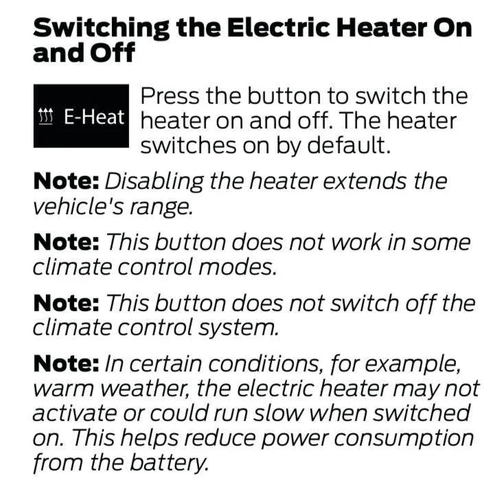

Please note, I was told to disable E-heat , Not turn off the heater . Turns out E-heat is the only source of heat in the car and they obviously thought otherwise . To be fair E-heat as described even in the cars dashboard is misleading . It is described as a ‘supplemental electrical heater used to warm the cabin before the car can make its own heat’ That’s not me paraphrasing that’s what it says when you click on the info for E-heat on the dashboard. If it’s supplemental and before the car can make it’s own heat , then I and others rightfully assumed at some point after switching on the car it will make its own heat. Turns out that’s bullocks .

E-heat is the heater. I can see how Ford's description can be confusing. Technically the car can "make its own heat" by scavenging waste heat from the HV battery and motors. But that heat will never be enough to warm a cold cabin. Ford's documentation should be clearer about that. At least you know now.
