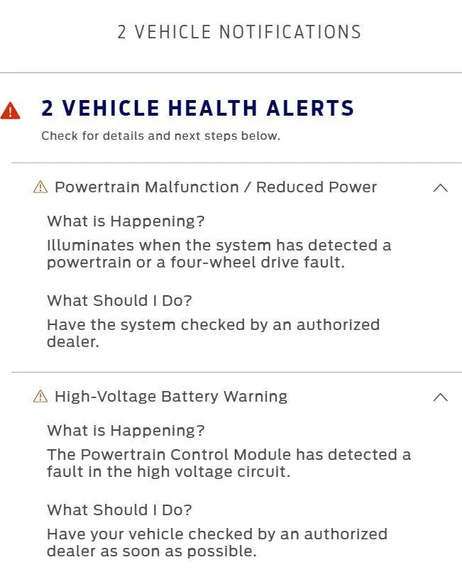

HighVoltage Battery Warning

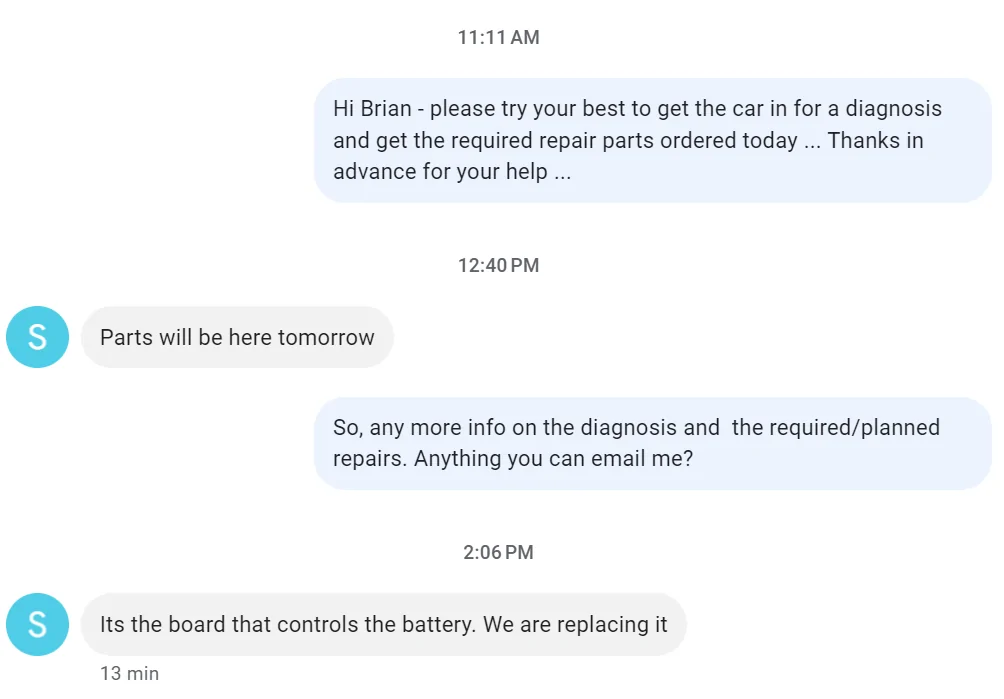

Phew - I did get confirmation from the service that they are replacing part no: LK9Z*10C666*B, which is what TSB 23-2020 is listing for the GT HVBJB. They are evidently going to receive the part tomorrow! And repair done by Thu.; fingers crossed.
Will update ASAP.
Thanks @Mach-Lee, appreciate you pulling the code for me. My dealer, Serra Ford of Farmington Hills, MI currently has the car and info from them is spotty at best. They are reporting, " It's the board that controls the battery" is that the same as the HVBJB? I hope it is as much as it does not sound like it. See my conversation with the Service manager:

Try This First - Powertrain Malfunction / High-Voltage Battery Warning / Service Vehicle Soon While Charging
