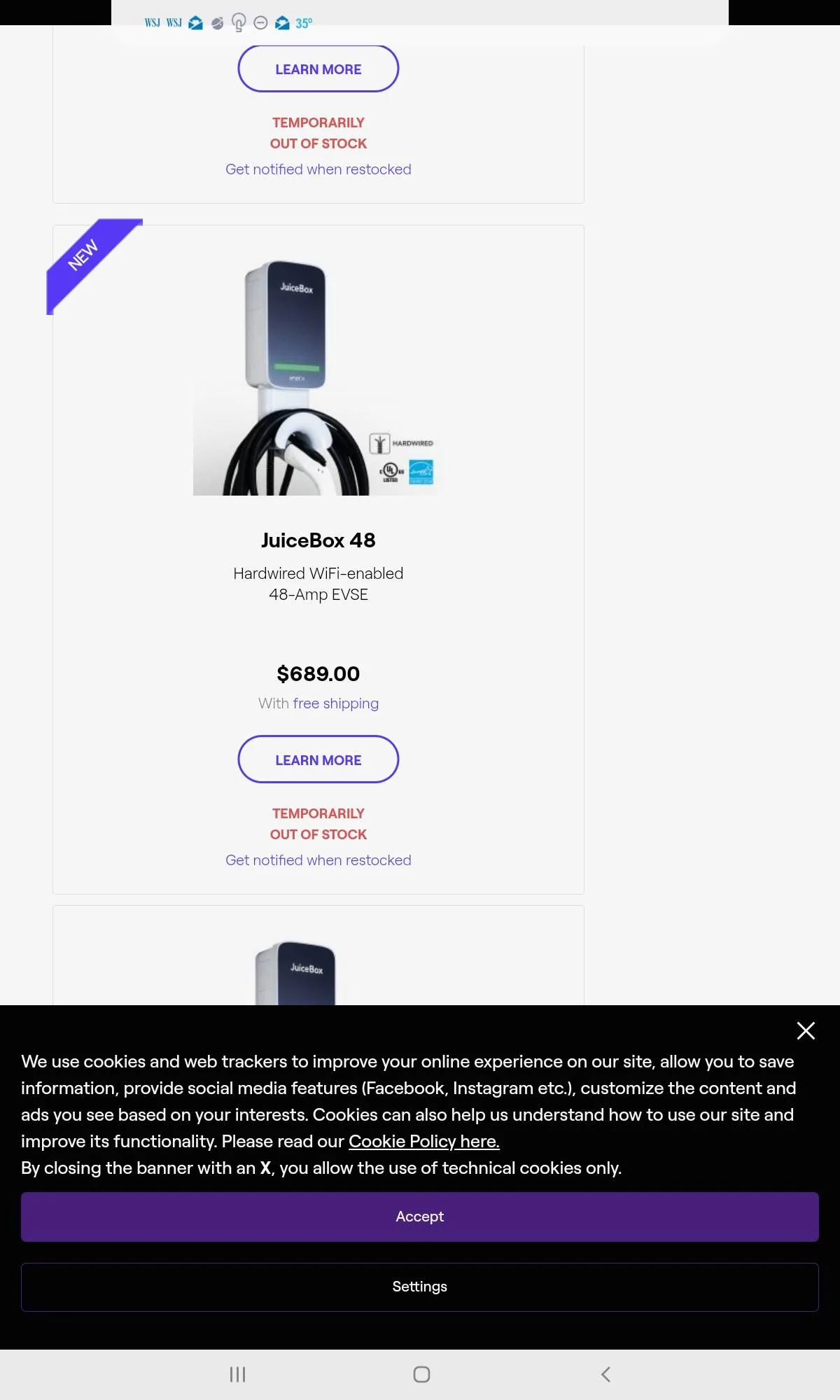

@Tngo23, while the ChargePoint may be popular, it is out of stock often, as is JuiceBox and others, due to supply chain issues. Not popularity.
Ford Mustang Mach-E Home L2 Charging: 40A versus 48A Screenshot_20220416-223756_Chrom
I am fairly sure it's popular for many reasons and Chargepoint, Juicebox, & WallBox were my top 3 choices and highly rated as many have used them with high praises....It's also out of stock bc many people want them over others......Supply & demand
