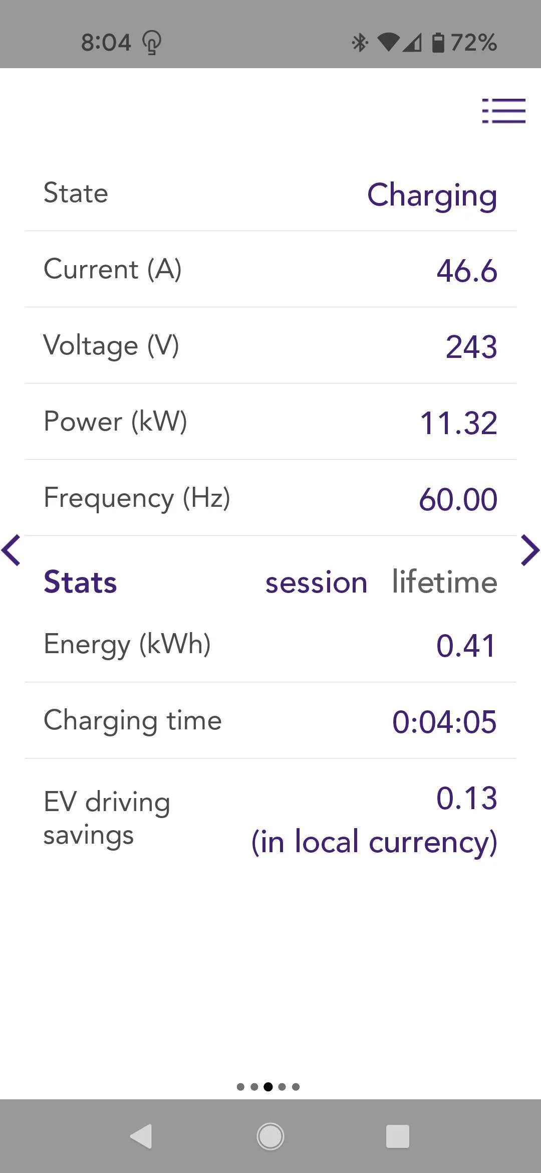

You really don’t need 4 gauge to run at 48 amps. 6 gauge is ok up to 65amps which you will not approach. The Mach e will only take 10.5kw on the level 2 charger. That means the max current it will take at 240v is 43.75amps.
My JuiceBox 48 has shown 11.32kw.
As to the connection, the wires connect in a box on the wall, not in the unit.
