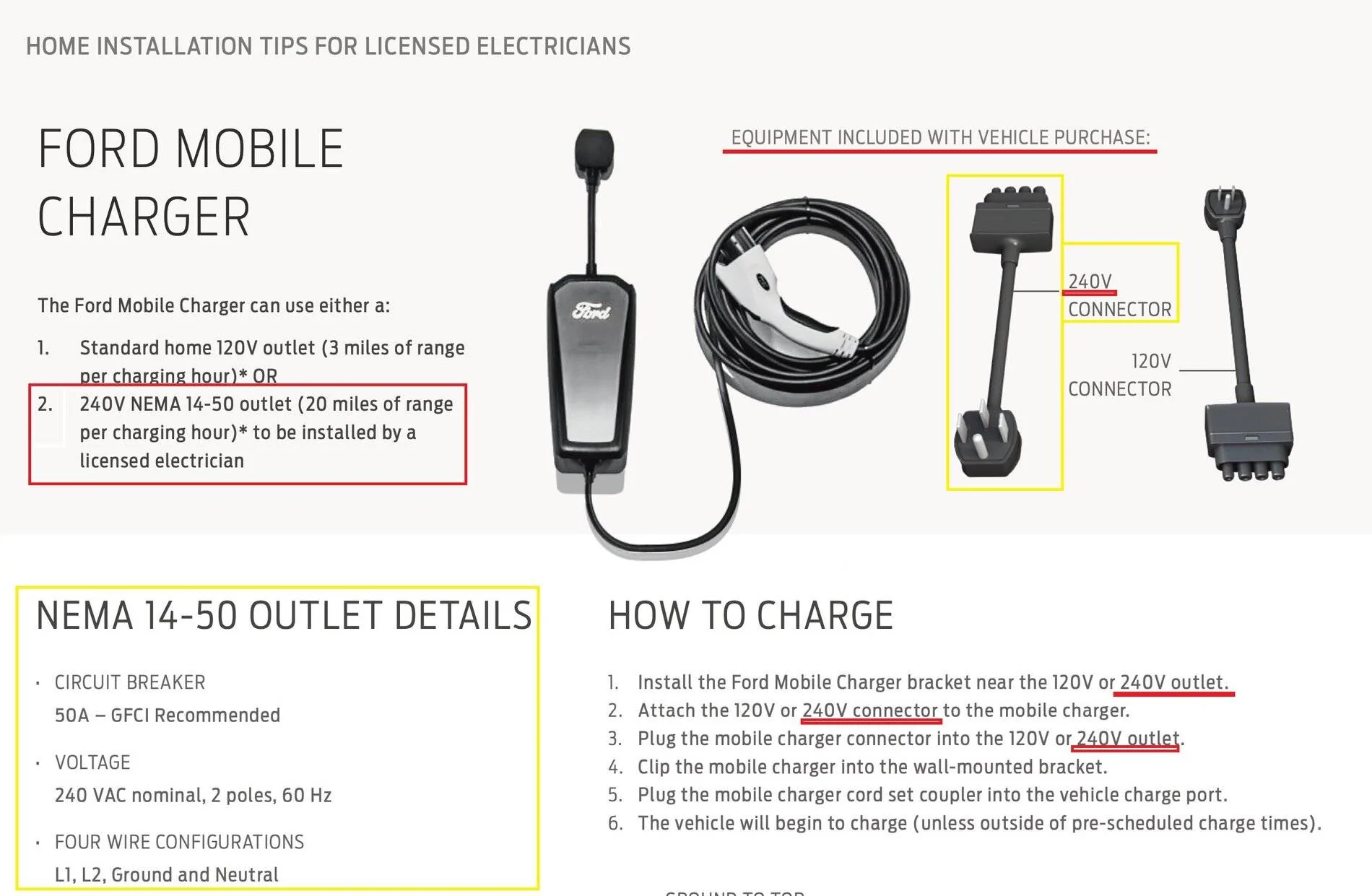

Hello.
Have you tried charging with the Ford Mobile Charger @ 240V via a 14-50 outlet?
Why did you choose a NEMA 6-50 instead of a NEMA 14-50 ChargePoint Home Flex?
Is your ChargePoint hardwired or plug-in?
Is it possible for you to plug the Ford Mobile Charger into a NEMA 14-50 outlet at your home and see if/how your Mach-E charges?

Has anyone affected by the 240V charging problem tried - Turn off all of the other breakers in the home panel, except for the one 240V outlet for the MME, or hardwired wall charging station breaker?
REPLY (For some reason I can't reply with white background)
Turned off all breakers except the 240V/50A charging outlet. No luck.
However I purchased a NEMA 6-50 to NEMA 14-50 adaptor and can now charge at 240V with the Ford Mobile EVSE. I tried switching back and forth between the Ford Mobile and the ChargePoint set at 50A, 40A, and 20A without success.
I had an on-line chat with Ford Customer Service yesterday and someone is suppose to call back.
Next step will be to contact ChargePoint and ask if they have any suggestions.
