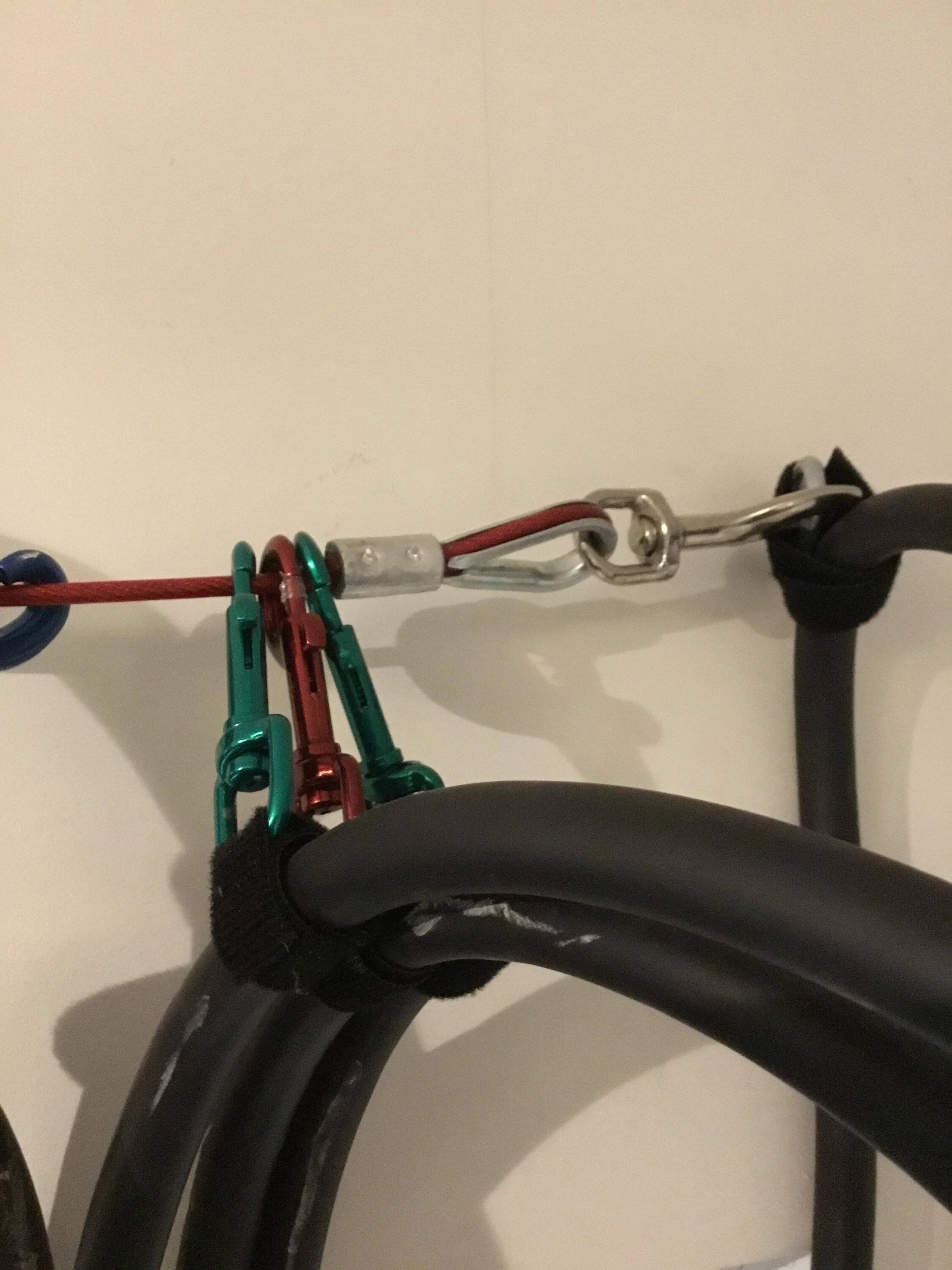

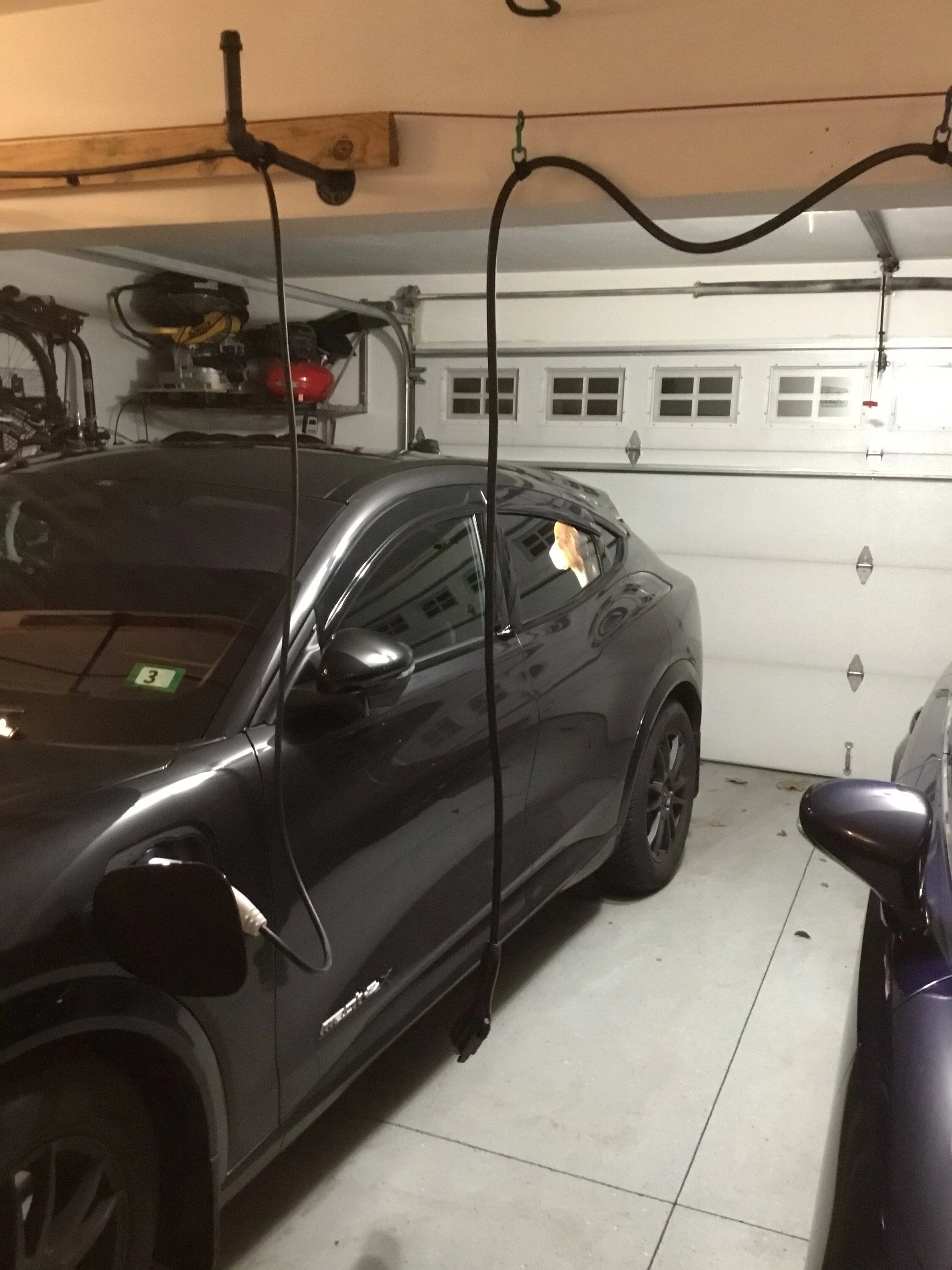

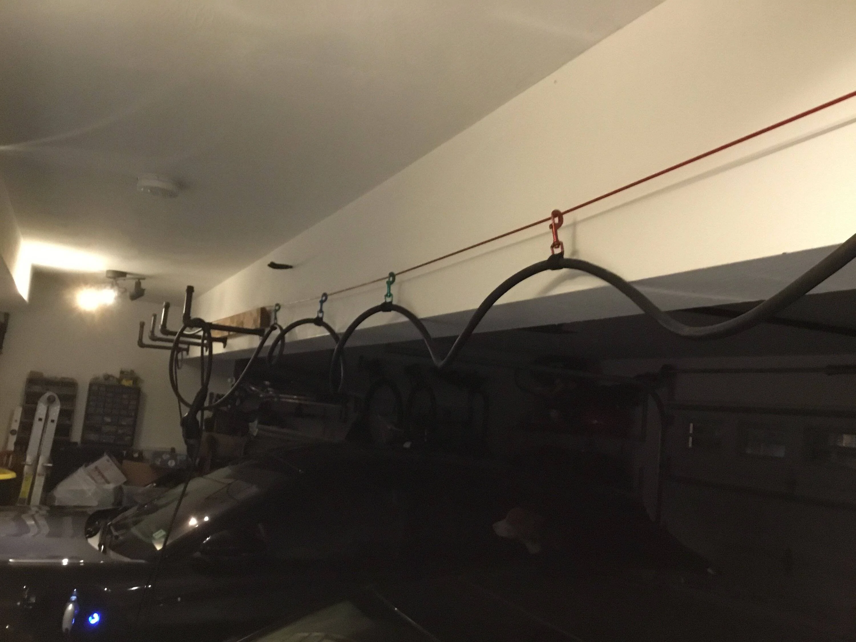

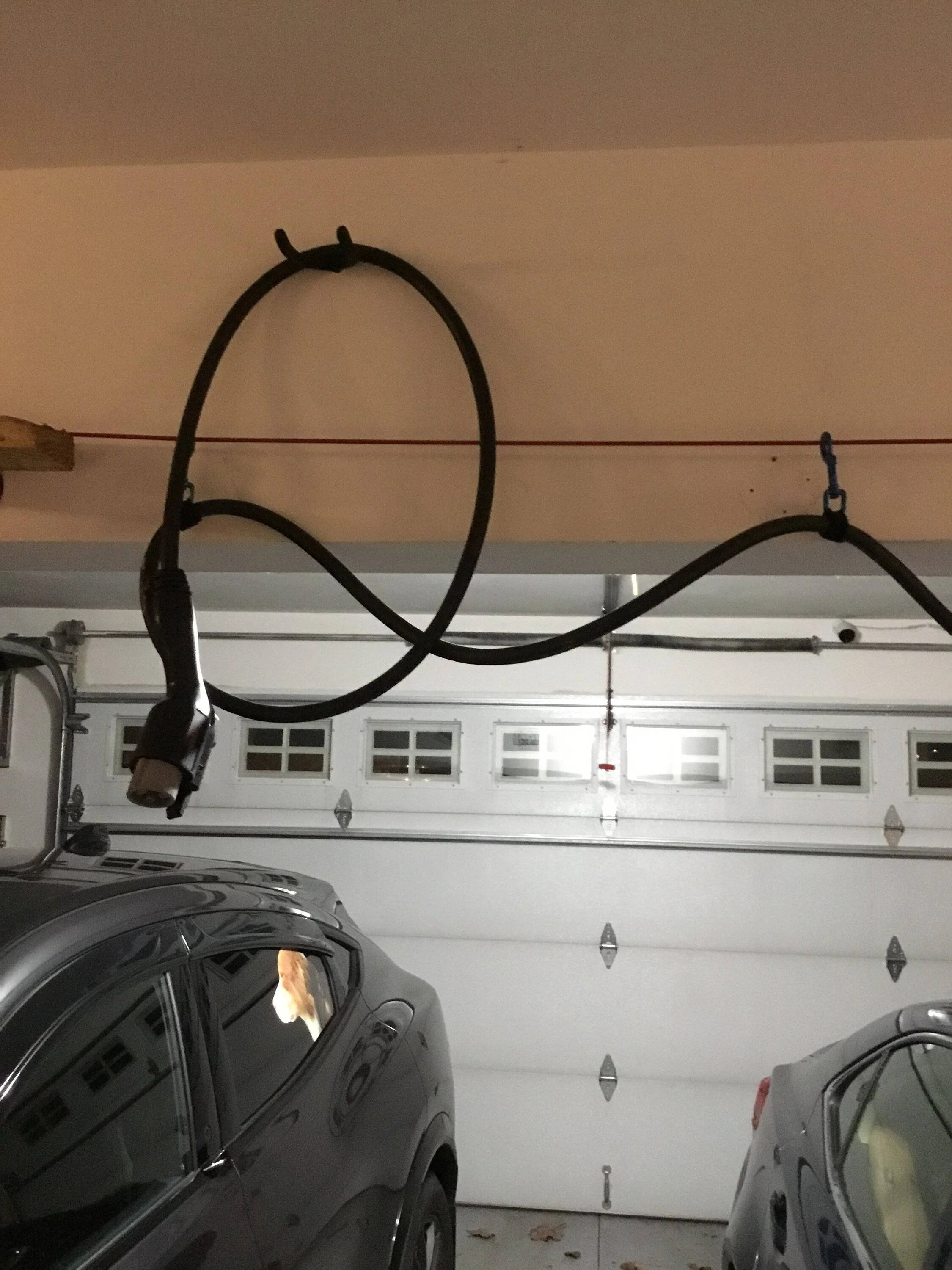

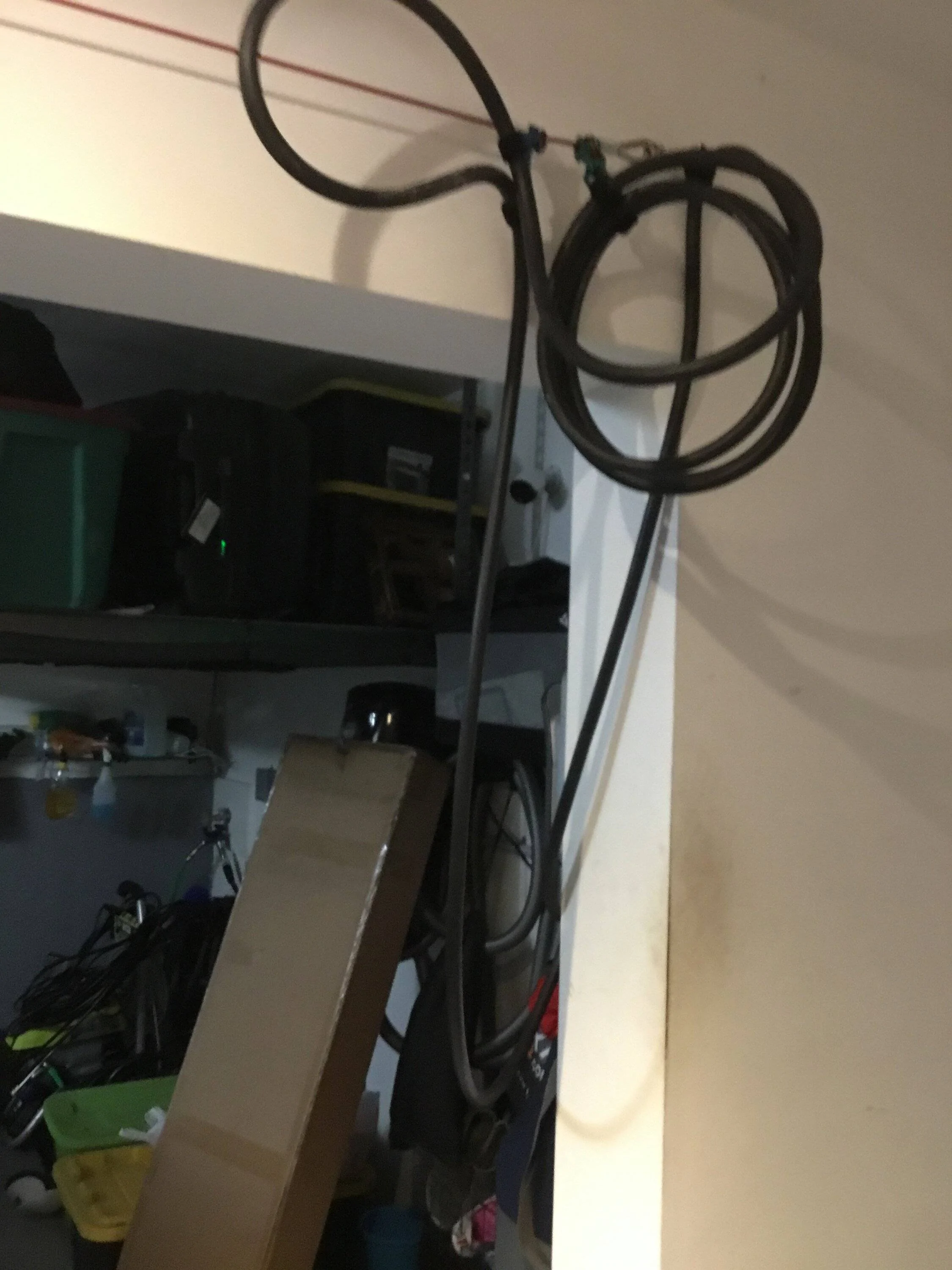

Here is what I did for less than 20 bucks. Ran a 25 for dog cable with eye bolts on each end and an adjustment setter to pull cable tight, think was 12 dollars from a discount store. The attached 5 colorful locking clips that slide on the cable from one car to the other I think I got them at Walmart for 1.50 each On the clearance shelf. Then used Velcro stripping to attach the charger cable to it.
no trip hazard
easy pull to which car may need 220 60amp
also have 110 charger so if I don’t need to fast charge
also made it so if I drop it it will not hit floor
really liked the EV hover system but the price was way to much for this so this was my solution
