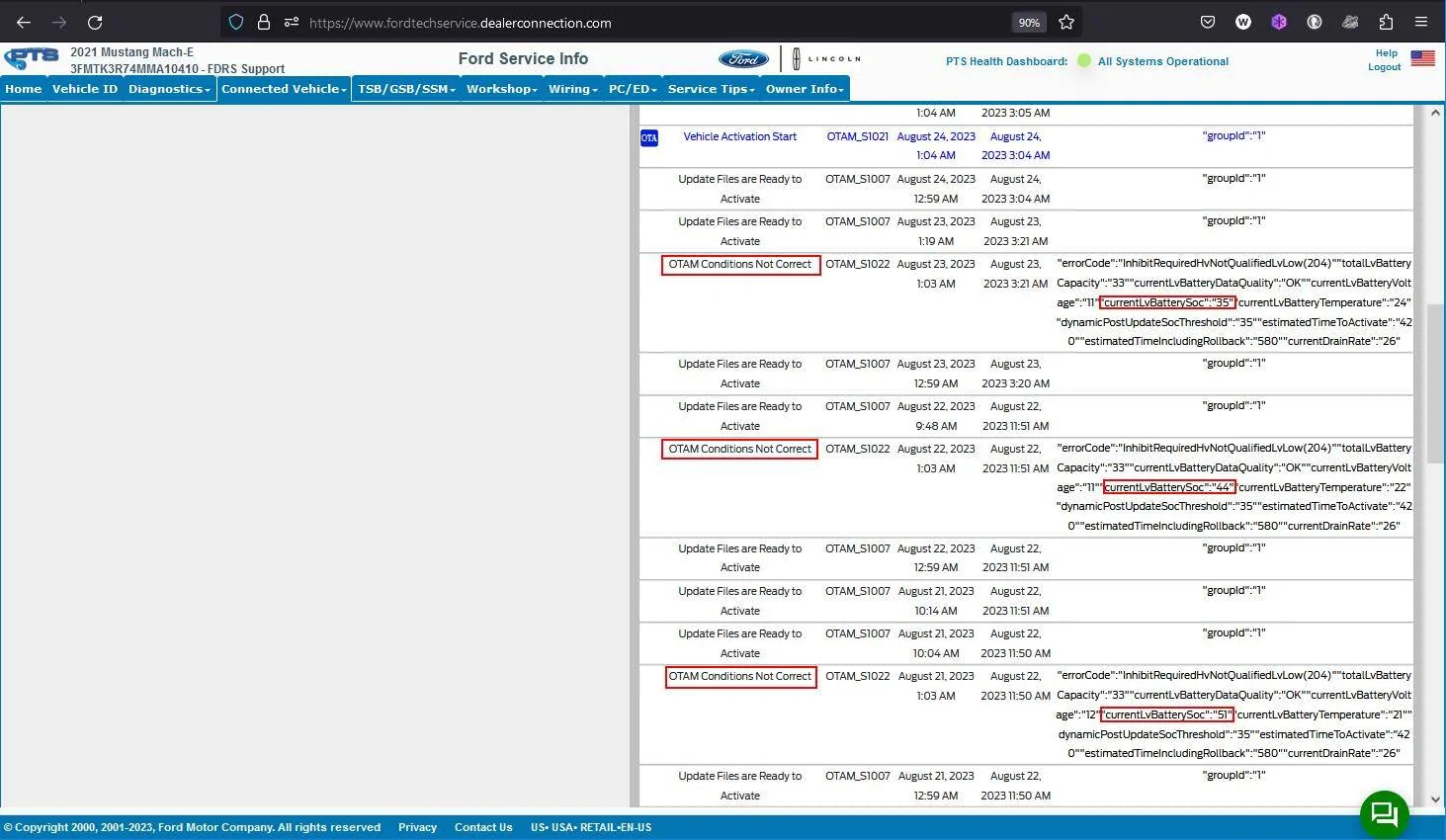

this seems 100% not what @Ford Motor Company promised regarding OTA?!Part of your problem is setting your recurring schedule at 2am.
To save Mike G from having to explain again, I cut and pasted from a previous reply:
Just remember to set your "Check Updates" in Sync to "everyday" and a time when you know you'll be out driving in the car. Preferably 15 minutes after you've gotten underway to allow your 12V battery to charge back up so the logic will allow the check to go through. And your car will not download updates over your home Wi-Fi in the middle of the night regardless of what Ford says (or that little note in FordPass). Just so you know.
If this is the case, then I would not have even gotten one update, because I am NEVER driving at 2am. I guess I'd like to hear from a few more people whether OTA arrive via wifi at night, or is this a bug that we all need to make a big stink about? Is it a bug with OTA, or insufficient bandwidth, or just terrible software version control?
Either way.... from the poll, it is quite obvious to me that even with people that have auto-update 'on' that updates are obviously NOT happening with frequency I would expect to keep vehicles up to date.
