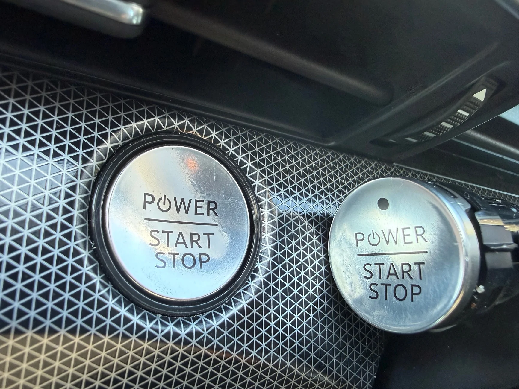

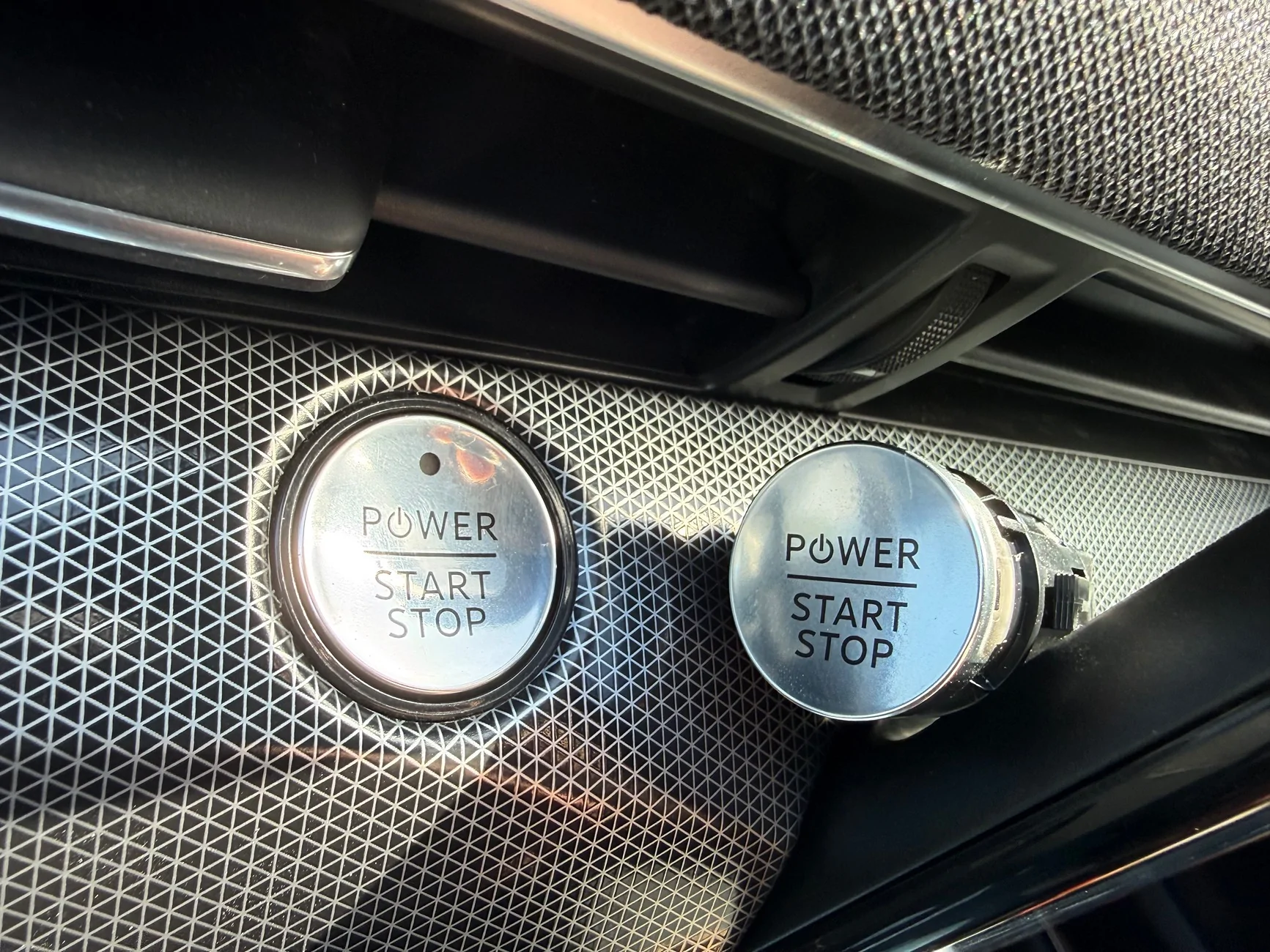

Being a Poodle of itchy phalanges, I decided I wanted the older ignition switch in my 2024 GT. So, I pulled the center screen and the instrument panel center trim panel. The switch is just held into the IP center trim panel by a pair of spring-loaded legs. Disconnect the wiring harness from the switch, squeeze the legs, and the switch slides out the outer face of the center trim panel. Reverse to install. The whole process took less than half an hour, a good portion of it trying to disconnect the pink connector from the center screen (paws too fat to depress the latch and not enough claw). 😁🐩
Before:
Ford Mustang Mach-E Ignition Switch with Power Indicator in 2024+ MME IMG_5735
After:
Ford Mustang Mach-E Ignition Switch with Power Indicator in 2024+ MME IMG_5738
While the old switch has the indicator lamp in it, the car does not illuminate it. Do any of the ForSCAN experts have any idea if this can be enabled in software? 😁🐩 If it can’t, I will probably swap the switches again. 🤪🐩

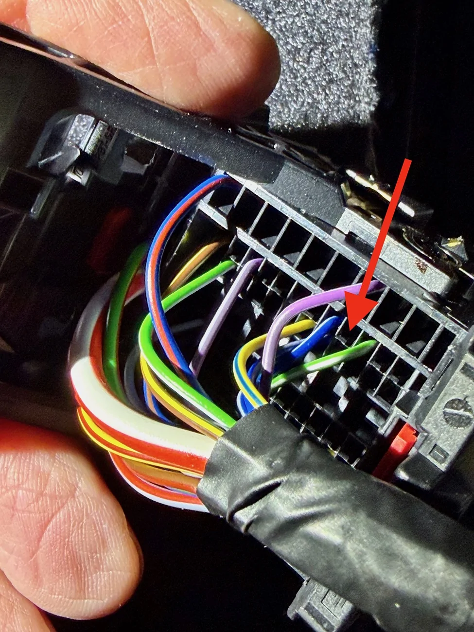

Hey Steve, not sure how I missed this! Probably because I'm busier than normal and also seems like tons of new threads lately. Can't keep up. 😊
The indicator on your ignition switch is not lighting because the wire from the BCM that powers the LED is missing. The 6-pin connector on the back of the switch has one open spot. This is where there used to be a wire going to the BCM. You need to run a wire from there to the bottom connector on the BCM. I have a photo of what position that wire goes in, just need to find it.
No need to use FORScan or configure anything. It will just work. I did this about a year ago. It's fairly simple and if you are interested in doing it, I will give you more details.

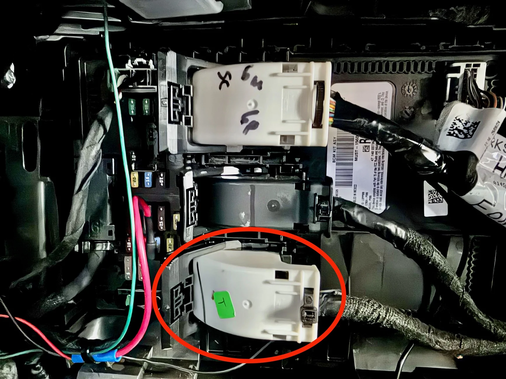

As far as the 6 pin connector behind the switch, there is only one spot open. There are wires in the other 5 so no need to figure that out. On the BCM, it is position 20 in the Bottom connector.
Pull the connector, cut the zip tie holding the wiring loom to connector, remove the white back shield and below I marked where the wire goes. Position 20 is between the Blue/Gray and Green/White wire. Put shield back on and new zip tie securing wiring loom to connector and reinstall connector.
