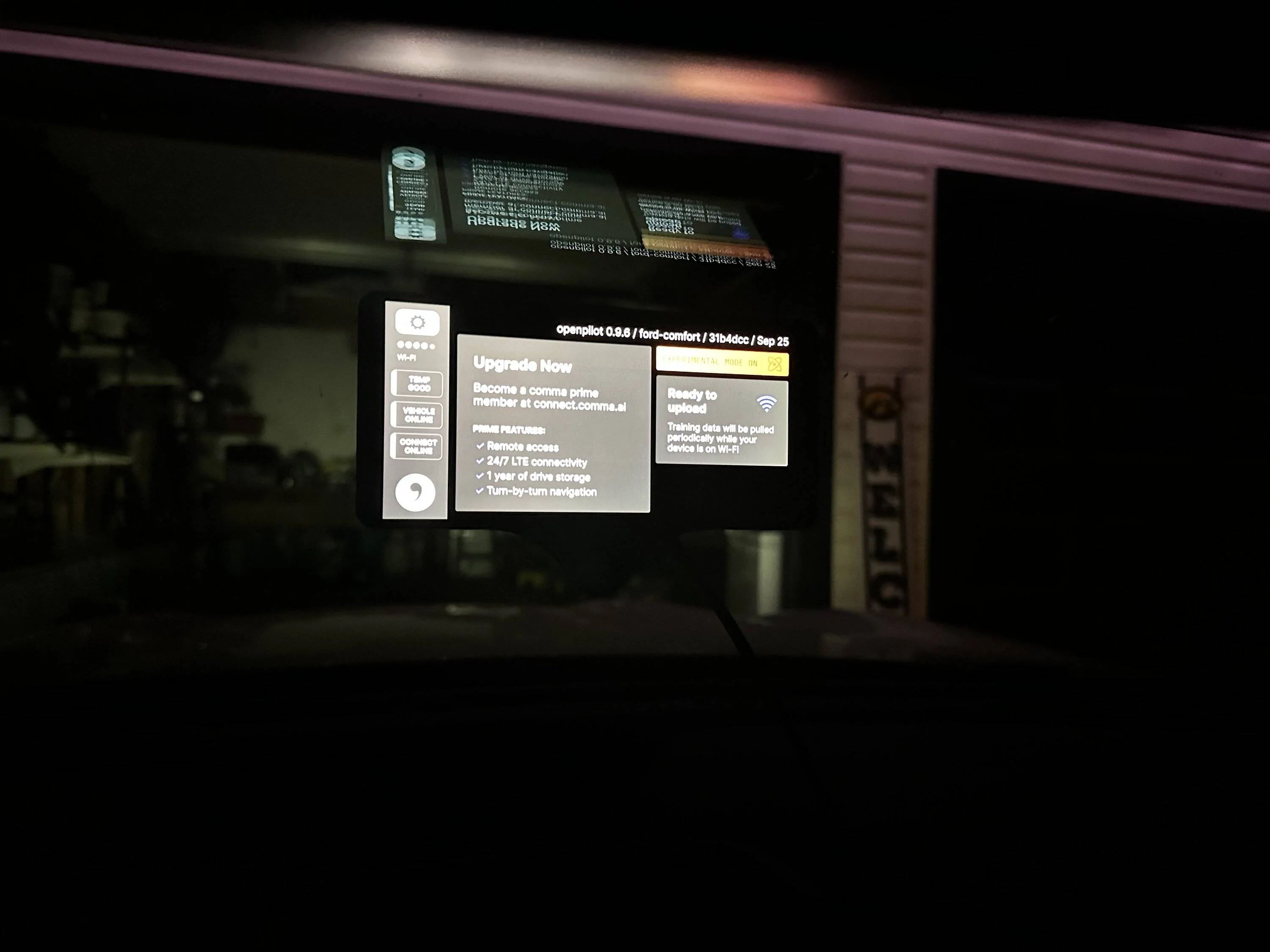

Thanks got it to download I don’t have a clue why I can’t get it off the main screen. I must not be smart enough!
Ford Mustang Mach-E Installing Comma.ai / OpenPilot (BlueCruise alternative) IMG_6559
AjzRide
Alan
May 1, 2021
365
541
Houston
RR 2021 MME Premium RWD
Eng
Should switch when you go into Drive.

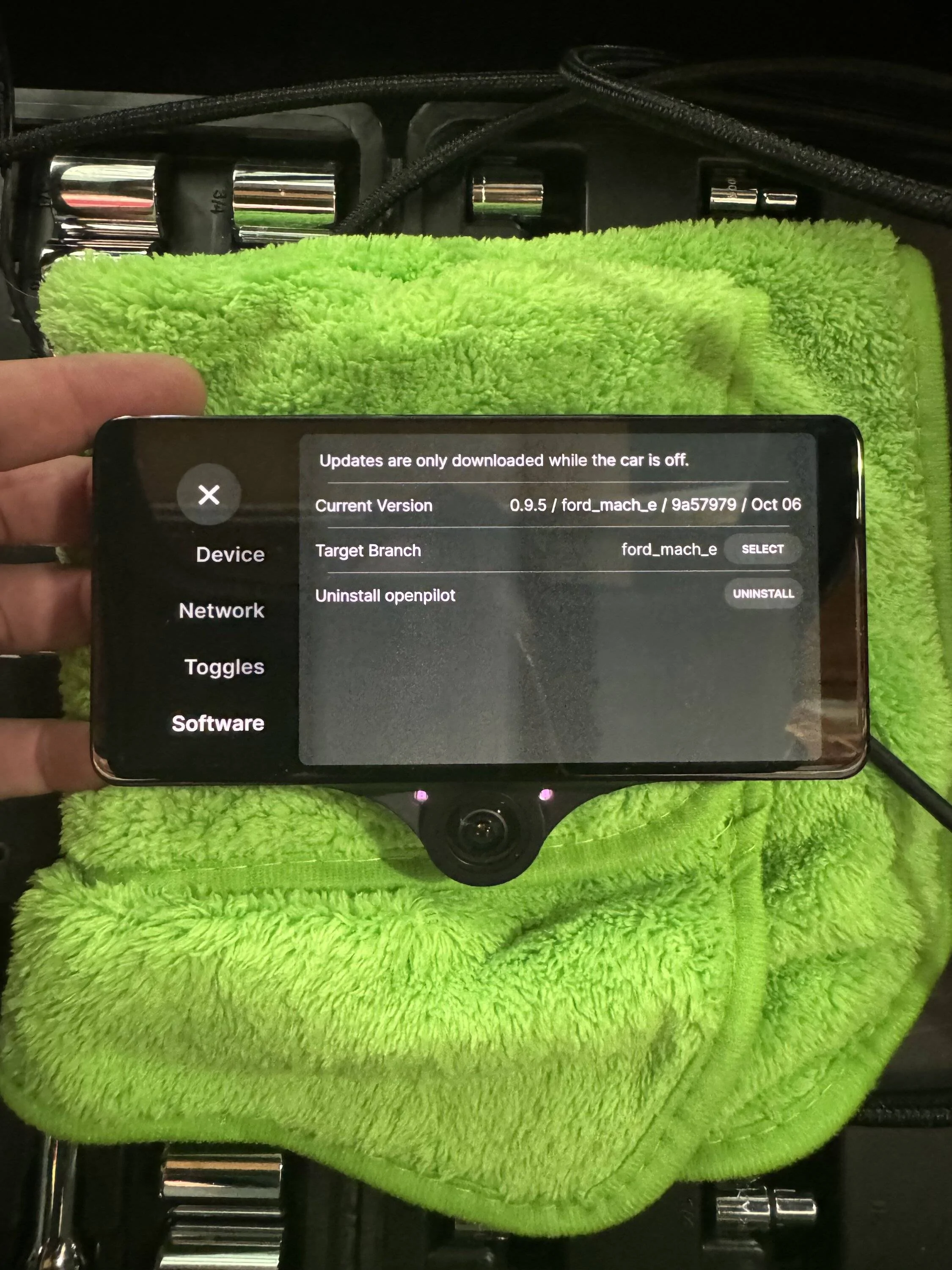

After running OpenPilot for a few weeks, I've moved over to a popular fork called SunnyPilot and was able to resolve the fingerprint issue by modifying some of the Panda code in uds.py and adding the Mach-E ECU values. Vehicle now being recognized properly.
Ford Mustang Mach-E Installing Comma.ai / OpenPilot (BlueCruise alternative) 1698990727330
I maintain my own personal GitHub fork for personal usage and highly recommend, to anyone interested, do the same.
