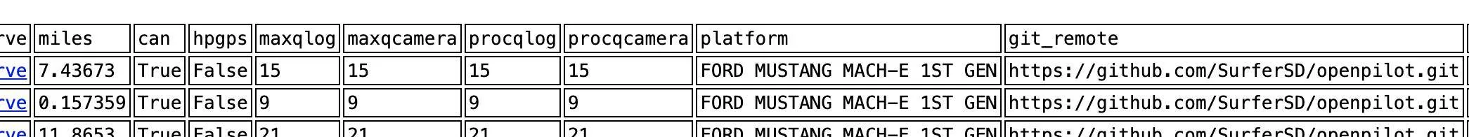

After running OpenPilot for a few weeks, I've moved over to a popular fork called SunnyPilot and was able to resolve the fingerprint issue by modifying some of the Panda code in uds.py and adding the Mach-E ECU values. Vehicle now being recognized properly.
I maintain my own personal GitHub fork for personal usage and highly recommend, to anyone interested, do the same.
