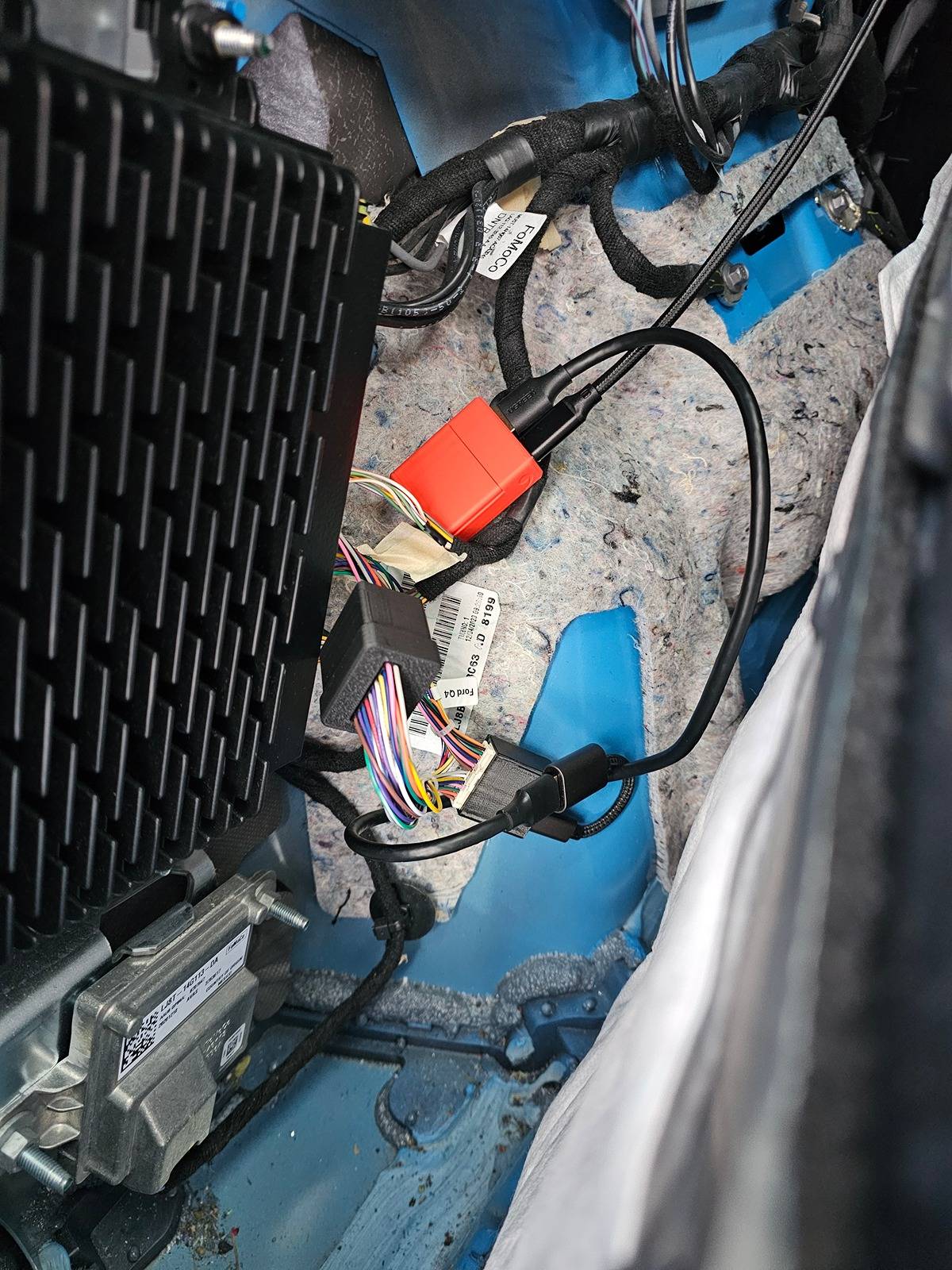

Hi!
So I never had BlueCruise in my car but compared with stock lane centering it is so much better!
With low speed manuvres it is weird as it tends to "hold" a turn after its complete due to ford using a curvature measure instead of torque. Above 30mph you won't notice. It can mostly stop at red lights too which is nice as I'm in a metro area, but you have to really watch the system to make sure its stopping appropriately.
In order to access the IMPA you need to remove the cover next to the striker latch in the trunk. Remove the tiedown points with a torx bit (not sure what size) and there are two other bolts under the false floor on the side of the plastic trim (also not sure of size). Then just pull up in a quick motion and it will pop off. You will see on the sides of the trim there is a plastic locating bracket that attaches to the frame. POP THIS OFF FIRST, then use a panel clip to get access to the IMPA. Once you are in there you will see two harnesses that "fit" the comma harness. It is the upper one if I remember correctly. Cable routing I basically didn't care about as I just ran it under my floormats. I used double-sided tape to hold it along the A-pillar trim. I'm not going to lie it looks pretty bad but I have no desire to try and get it to look pretty.
If you really care about fit and finish I'm not the one to ask, but the trim panels in the car do pop apart pretty easily and other than the panel on the side of the dash, they shouldn't use screws.
There a YouTube vehicle showing how to get to it, and then some engineering student wisdom of figuring out how it's all held together.
I can take some pictures later of the wiring.
You also have to be very picky with the extension cables you use. Someone else in this thread mentions the ones you should buy.
