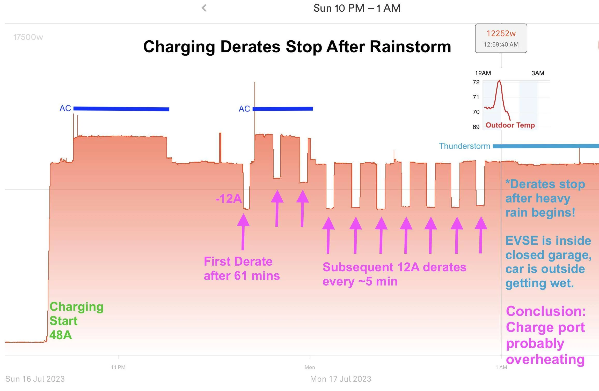

Well, caught something interesting on someone else's car. The derates magically stopped right (minute or two) after heavy rain from a thunderstorm started falling on the car. Nothing was touched. This is data from Sense home energy monitor (ignore the A/C usage):
Ford Mustang Mach-E L2 charging speed recently dropped 33% Derates Solved?
There were no further derates for the remainder of the charge session (continued for an hour along with the rain). So thinking about what the rain would affect, the most likely thing is it would cool off the charge port and J1772 handle first. The air temp didn't really change much, it actually went up a couple degrees right before the rain started. The ChargePoint EVSE was inside the closed garage with the cable running under the garage door, so it wouldn't have experienced any difference in its temp environment. However the surfaces on the outside of the car and the charge port would have reacted very quickly to the cooling effect of the rain, which was observed. There were no power hits because the car continued charging without interruption. The most likely conclusion I have is that the derates on his car were being caused by an overheating charge port, and the rain cooled down the port enough to stop the thermal derating.
I'll remind folks that currently the only way to monitor AC charge port temps is with FDRS (BC_COUPL_TEMP_A, see here), Car Scanner and other apps have the wrong parameters programmed so you aren't actually seeing the AC port temp. I need to check if FORScan has them correct compared to FDRS.
It's possible the previous version of the charger software didn't monitor and respond to charge port temps properly, or the overheat threshold was lowered, so when the car updated to the current version it reveled preexisting issues with the charge port or J1772 plug (just like the crop of bad HVBJBs that were reveled shortly after the recall software was installed). Lowering the charge rate on the EVSE will mask the problem since it reduces heat generation. However the problem will continue getting worse with time as the connection degrades further, 40A may work for a while, then it won't and you'll have to drop down to 32A, then 24A, etc.
It's certainly possible other cars might have other reasons for the charge rate decrease.
Gentle rain on the charge port may be an interesting experiment for some...
This is going to be a bitch to reproduce at a dealer because they don't have 48A L2 chargers yet.

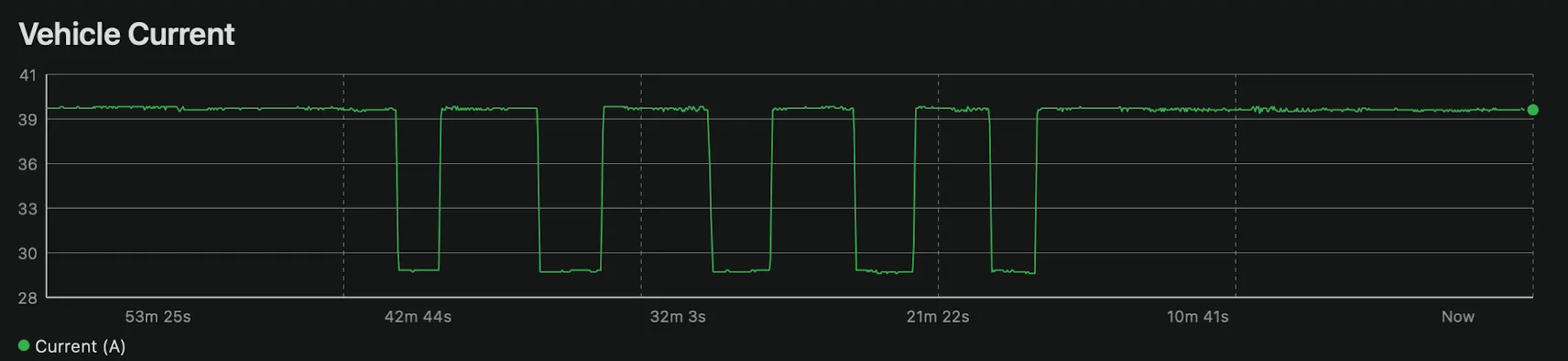

Perhaps I'll try my floor fan, suitably mounted to blast the relevant area. This is the kind used after floods to deep-dry carpets. (Yes, I live in Louisiana, ha ha.)
That. I have a box fan in the attic I could go get, but it's 145 up there currently.. lol. LOVE Phoenix.
BUT I have a 120 mm computer fan I'm going to put on there right now.
Ford Mustang Mach-E L2 charging speed recently dropped 33% Screenshot 2023-07-17 at 8.45.09 AM

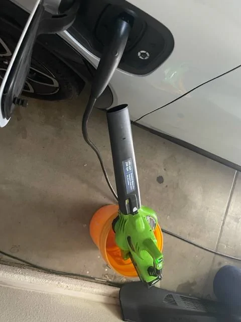

Edit: USB fan isn't enough, so enter the leaf blower on it's lowest setting with professional mount kit.
Ford Mustang Mach-E L2 charging speed recently dropped 33% IMG_4741
It's supposedly 143 in my garage according to the WallConnector (wrong by about 50 degrees, good job Tesla) And the air isn't enough so far to curb it from cycling down. It's actually maybe 95 in there. And this is about 70 cfm at the charge port with the DC door open. Nothing is acutally even warm, I think the sensor in the DC port is being used and is in the back side deep in there. The lower cycle was about 30% shorter, maybe it needs more time, I'll leave it running for 30 to 60 min. (current 64%SOC)

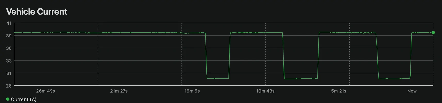

Ford Mustang Mach-E L2 charging speed recently dropped 33% Screenshot 2023-07-17 at 9.17.05 AM
Well that does the job.. Now just need to charge up that battery before charging the battery.
