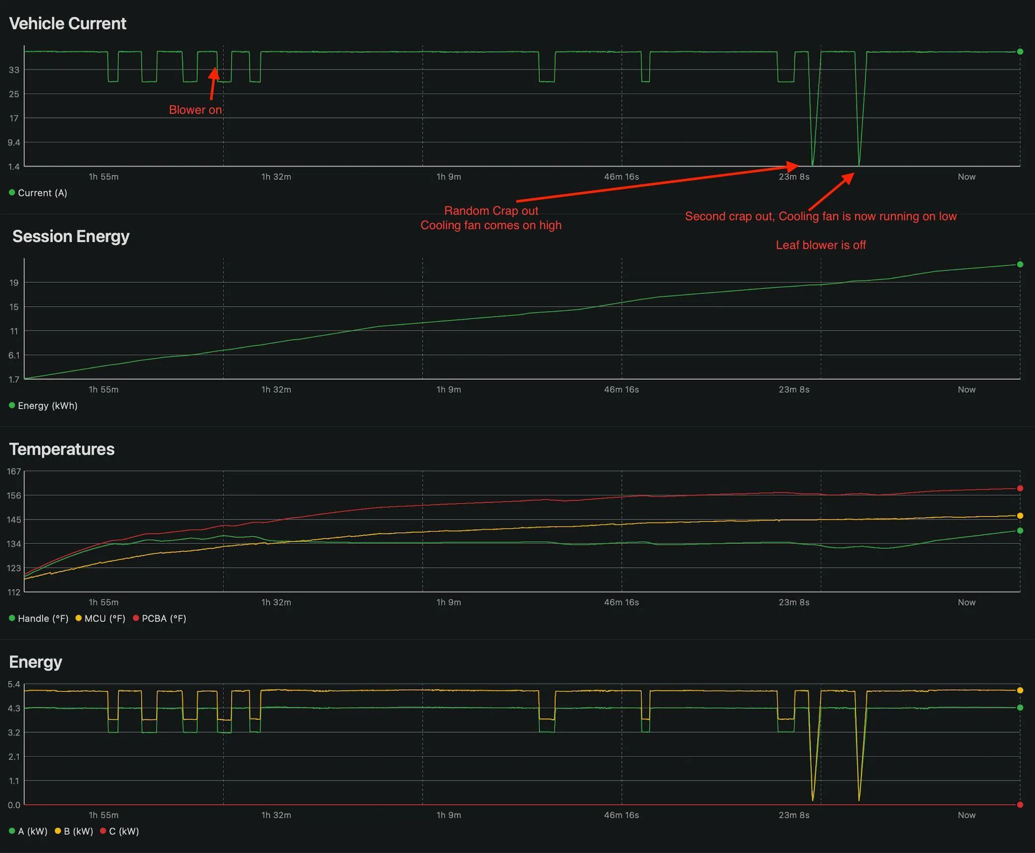

It helped, but I think it really depends on if your cars fan starts at all once plugged in. Mine didn't start until almost 2 hours into the charge when it actually stopped and started the charge by it's self. It was sitting all night in the garage ~ 105 degree soak at 9pm -> prob 90 degrees by 8am.
At 64 degrees I do not see a need for the fan to start but still charging at a slower rate here. Maybe ice in the frunk not for shrimp but for faster charging?

It just threw a curve ball. It's cycled the car fan twice, and restarted the charge, twice. Now it's charing at 40 solid with the car fan running on low and the leaf bower out of the picture. It's been charging for over 25 min (longest I've seen before a drop in amps) without the blower, the garage and all other temps higher than started and the cars fan running on low.

Something I noted about the way it's charing now, the air from the cars fan, is most likely cooling some other sensor somewhere. One that wasn't cooled by the leaf blower. Which would explain the rain having a better effect. With the way the fan is running now air if coming out of the wheel wells in the front. Remember my cooling fan never started this morning and didn't start until the first crap out. It has now charged to 85% and stopped (my target) without cycling the amps since the second crap out.
You could have multiple issues here. I think the port is still overheating some.
It could take a while for the fan to come on since everything in the loop including the motors has to heat up first. After that the fan should cycle on and off periodically. That’s how mine works. There are multiple reasons why the fan might come on, could be a battery cooling request (A/C will run) or another module like the DC/DC converter might have sent a cooling request too (that one usually jumps right to medium or high speed).
The interruptions are odd though, not sure what’s happening there.
Maybe the fan blowing on the backside of the port helps, but I didn’t see any effect on port temp in my tests.
