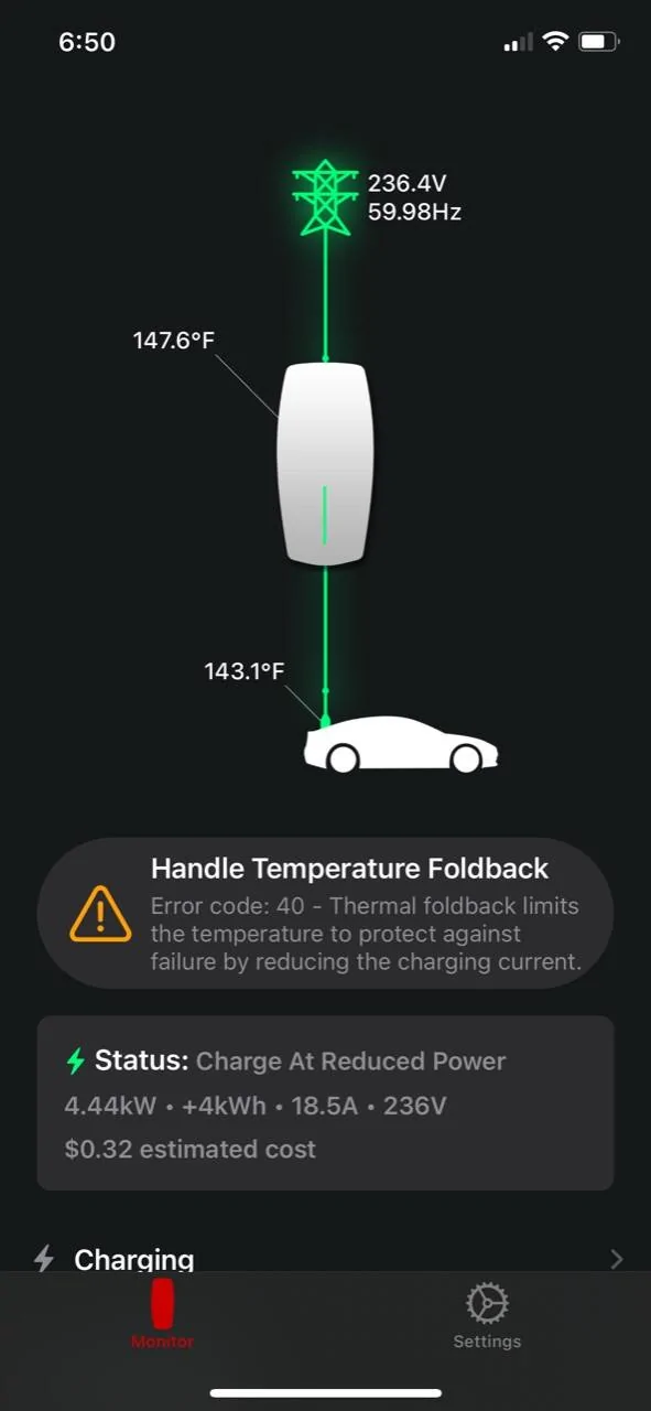

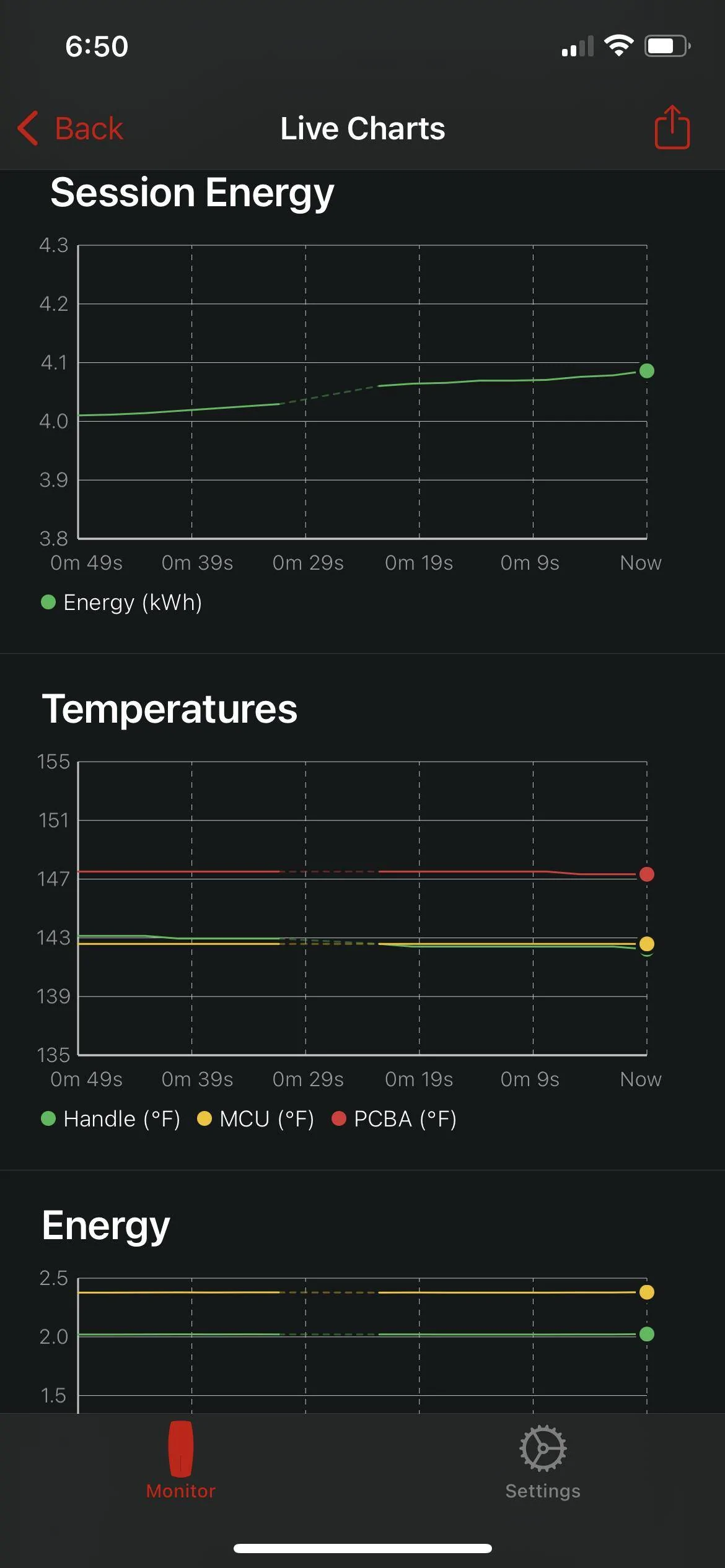

Well, yesterday was the first real rollback from my Evse. 4kw took a while to charge. The garage door was cracked open but the car had heat soaked. Can’t tell if this is related to the charge port overheating or the handle of my evse, but my fan was running and picking a different speed every 20 seconds or so.
