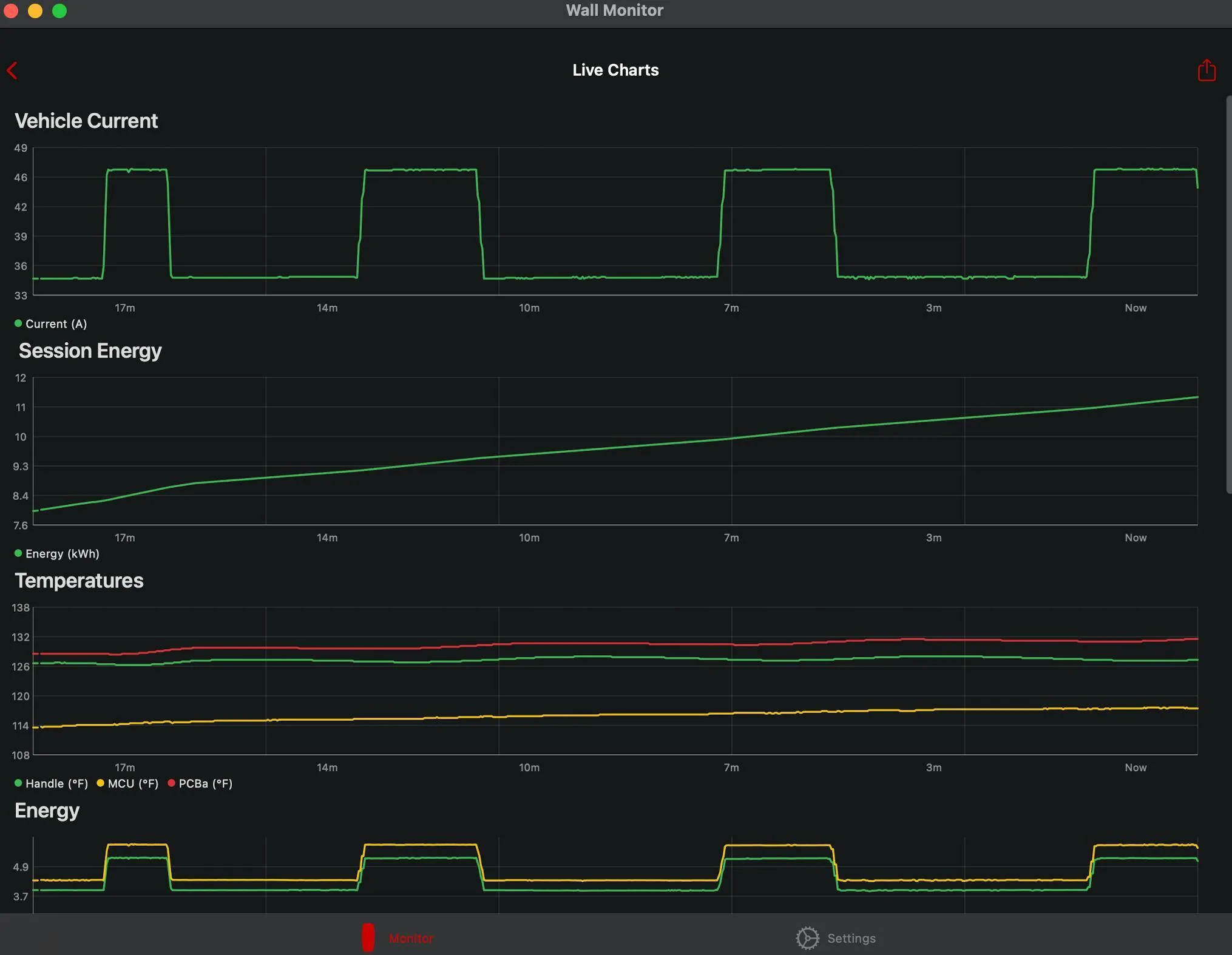

I know for sure it was happening back on May 1st.
Ford Mustang Mach-E L2 charging speed recently dropped 33% Screenshot 2023-05-03 at 7.55.16 AM
And it honestly wasn't that hot.
