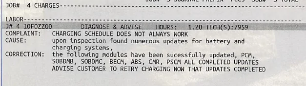

Would be weird if that SSM references our problem as it is for problems back on March 27, 2023 and my problem started after service applied updates on June 7, 2023. It does note that engineering is currently working on a solution for this condition that is expected in June 2023. Maybe we got the solution that caused our problem. Solution was to lower our charging to an up and down average of 32 amp? Here is what was updated to cause the problem.
Ford Mustang Mach-E L2 charging speed recently dropped 33% Screenshot 2023-08-04 131504
Really wonder if I should drop my dumb 40 amps charger down to 32 amp for the 1 to 2 months? Wish someone from Ford would let us know if that is a good idea for now. Started June 7 so the end of September for a fix sounds about right. Around 4 months after the software update caused the problem to fix it. I would be happy if I do not have to go into service again and it gets fixed.
I would derate it for the next couple of months.
I have no idea if the up and down will ruin anything but why take any chances.
