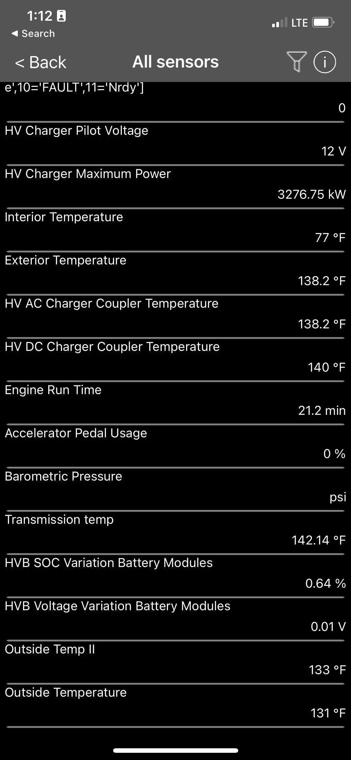

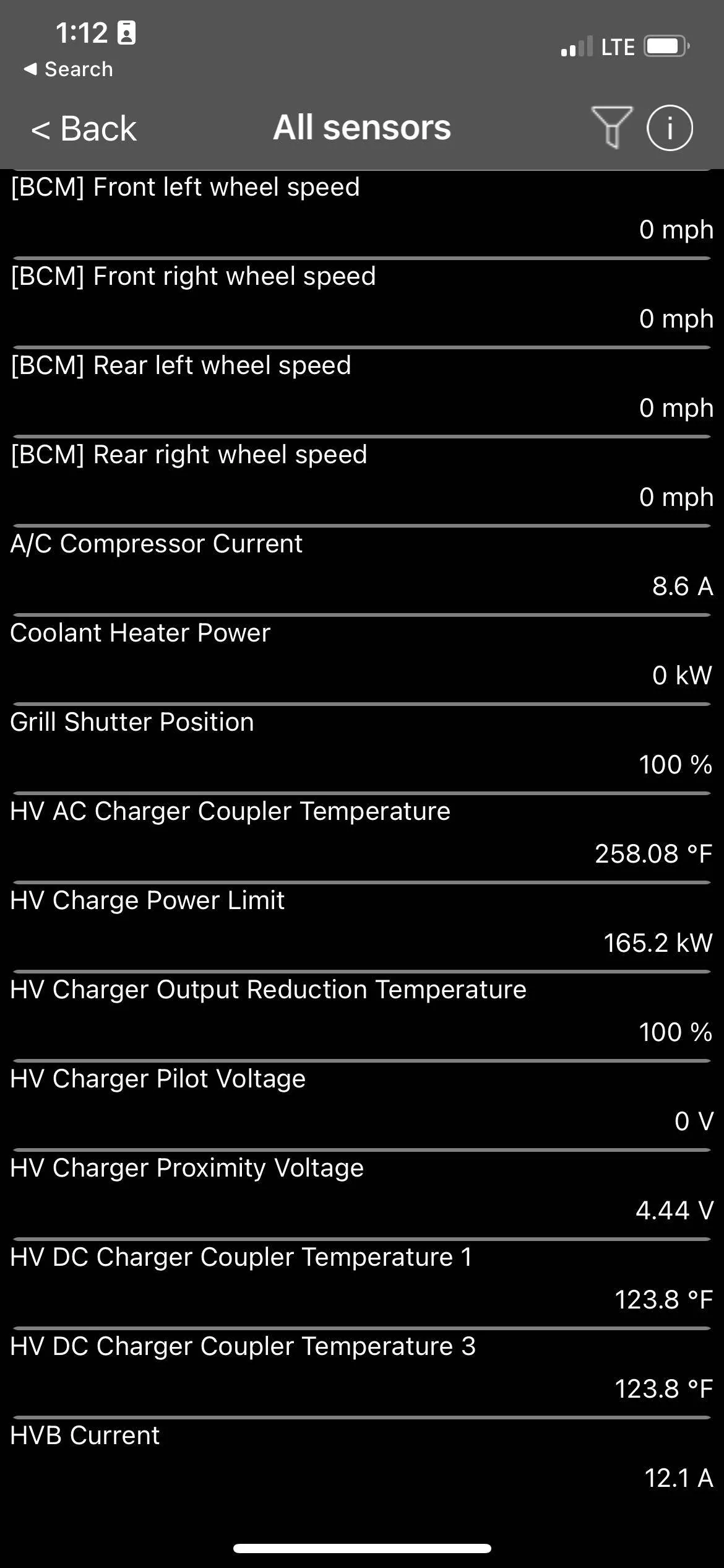

Not sure how accurate these are but this is the temps after driving and just getting home. A few hours of heat soak in 105+ (not 130+…)

To me all BUT the DC charger coupler temps look off. This was after a 18 mile drive on the freeway at 70, not leaving it running in the driveway.
