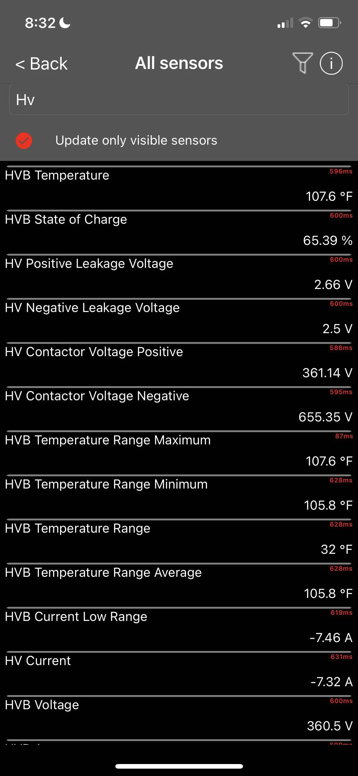

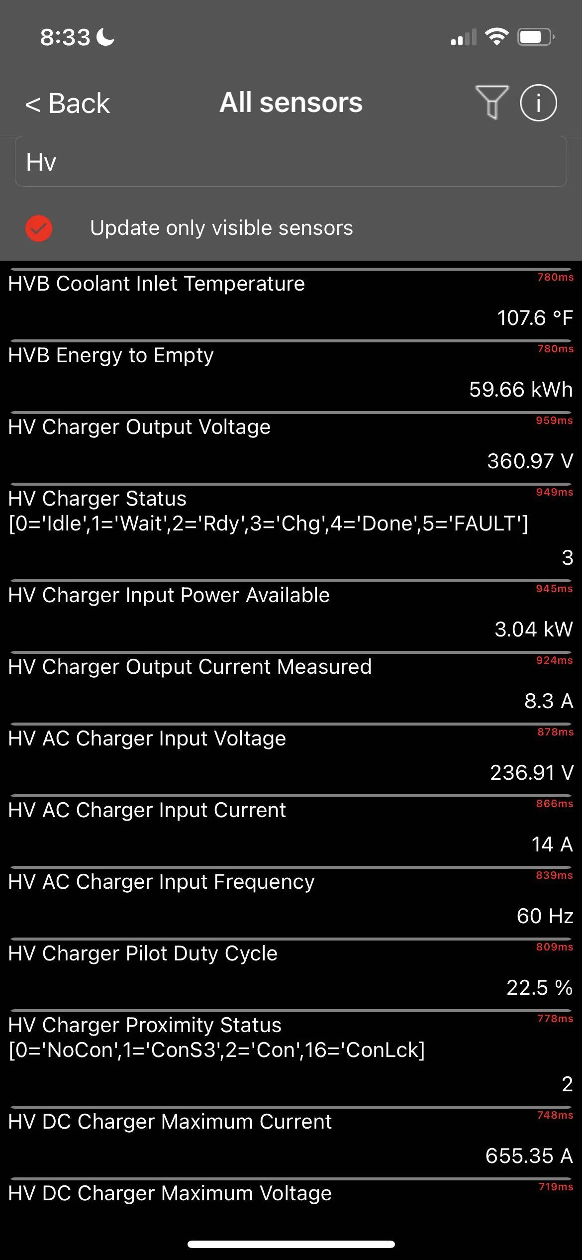

Not sure how accurate these are but this is the temps after driving and just getting home. A few hours of heat soak in 105+ (not 130+…)
To me all BUT the DC charger coupler temps look off. This was after a 18 mile drive on the freeway at 70, not leaving it running in the driveway.

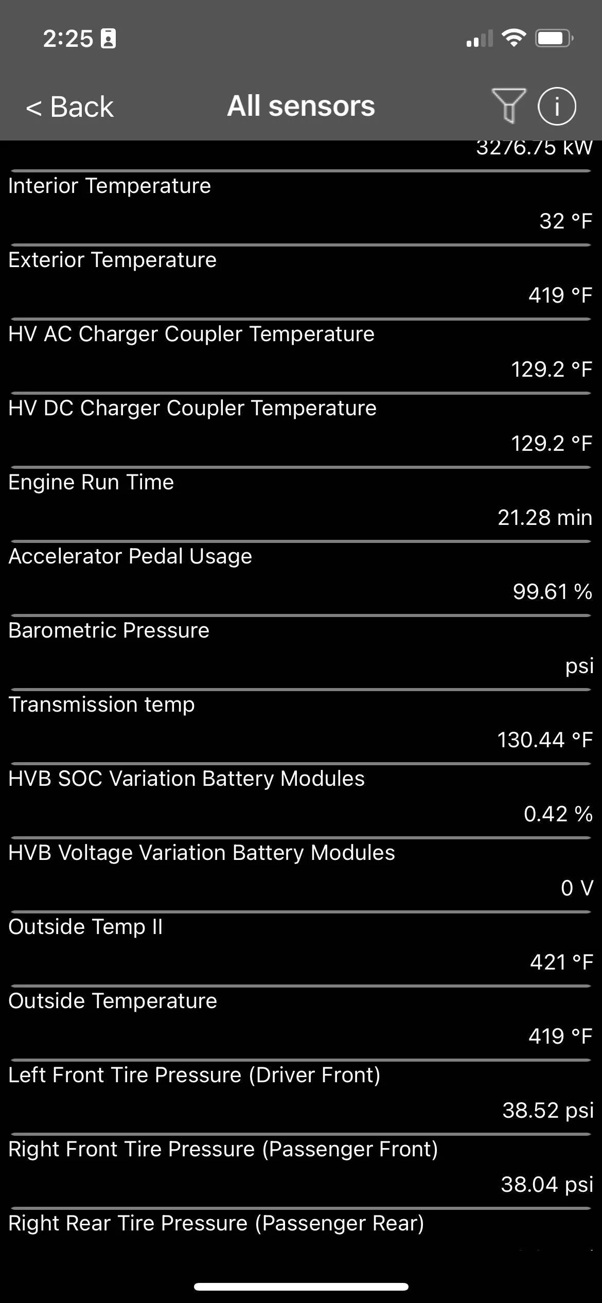

What scan program is that?
Also make sure the car is on, if the car is off the temps could default to a maximum value since they can't be read.

CarscannerPro just under 'all sensors'. It was on for the first 2 screenshots (I can't remember the 3rd it was so long ago (like 20 minutes or something lol))
3 external temp sensors off by 30ish degrees though (or all 3 pids are pointed at the same sensor)

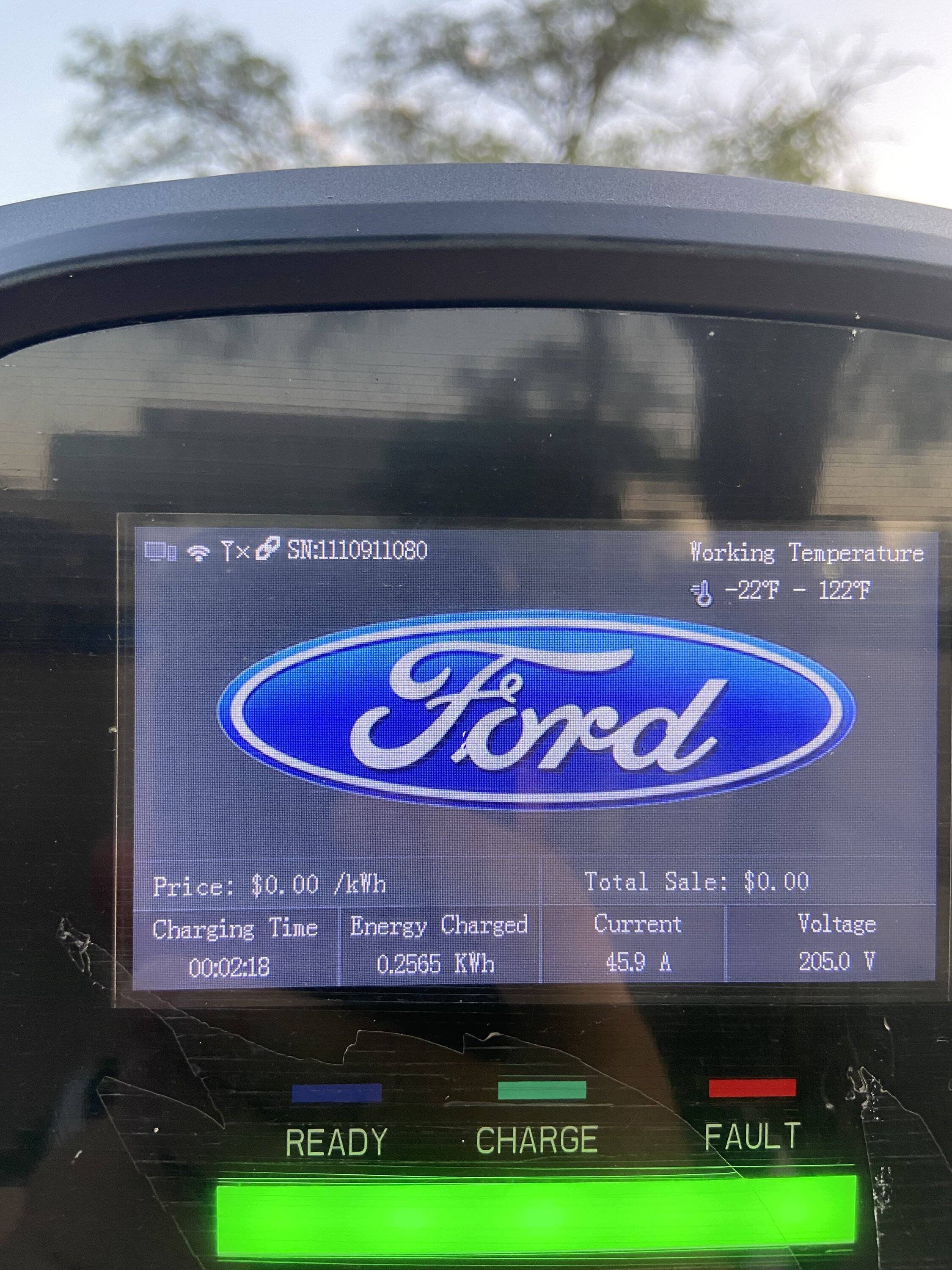

Started out at about 46 amps.
Ford Mustang Mach-E L2 charging speed recently dropped 33% IMG_4219
After work, ended up at about 34 amps on average.
Ford Mustang Mach-E L2 charging speed recently dropped 33% IMG_4228

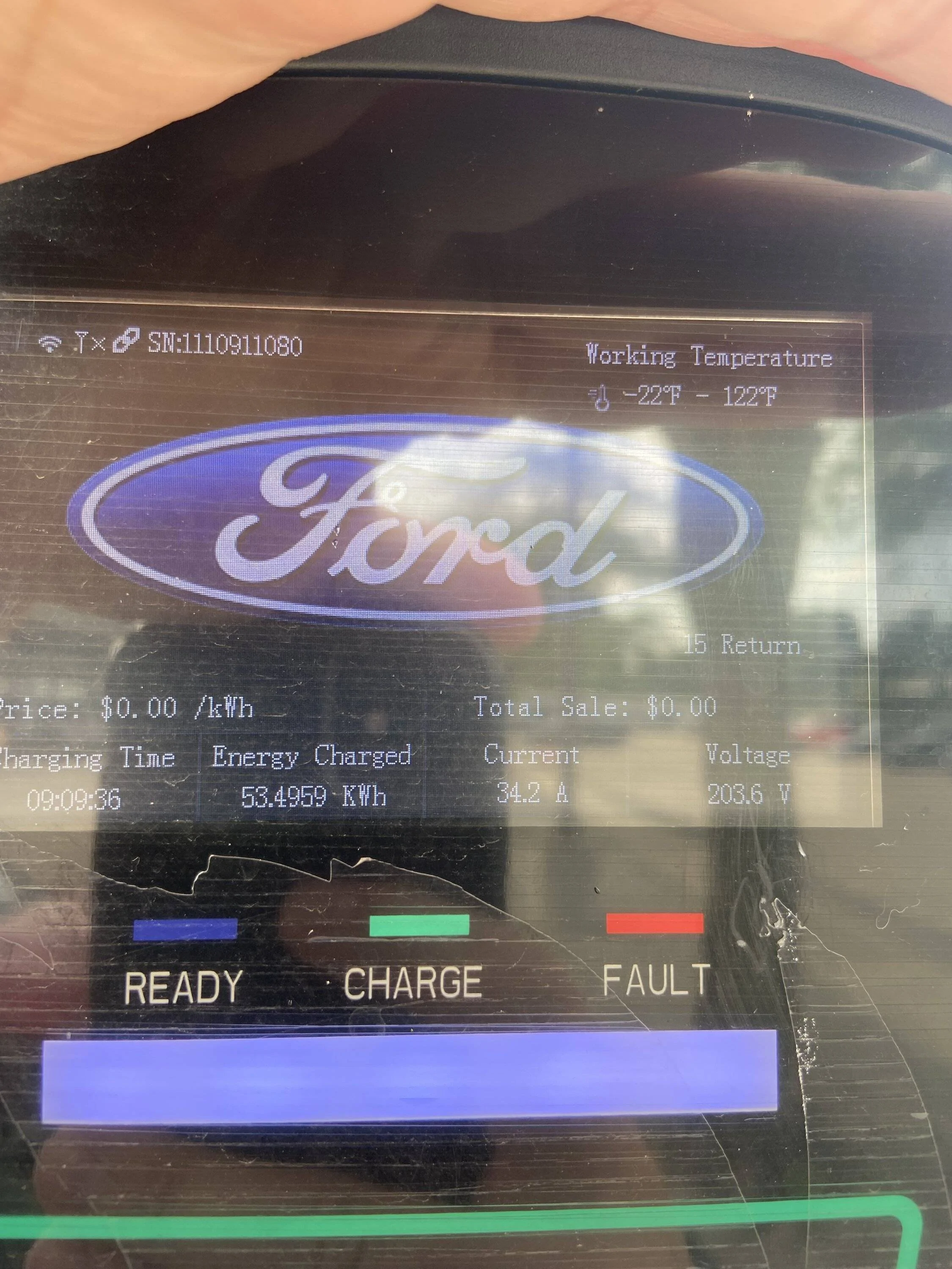

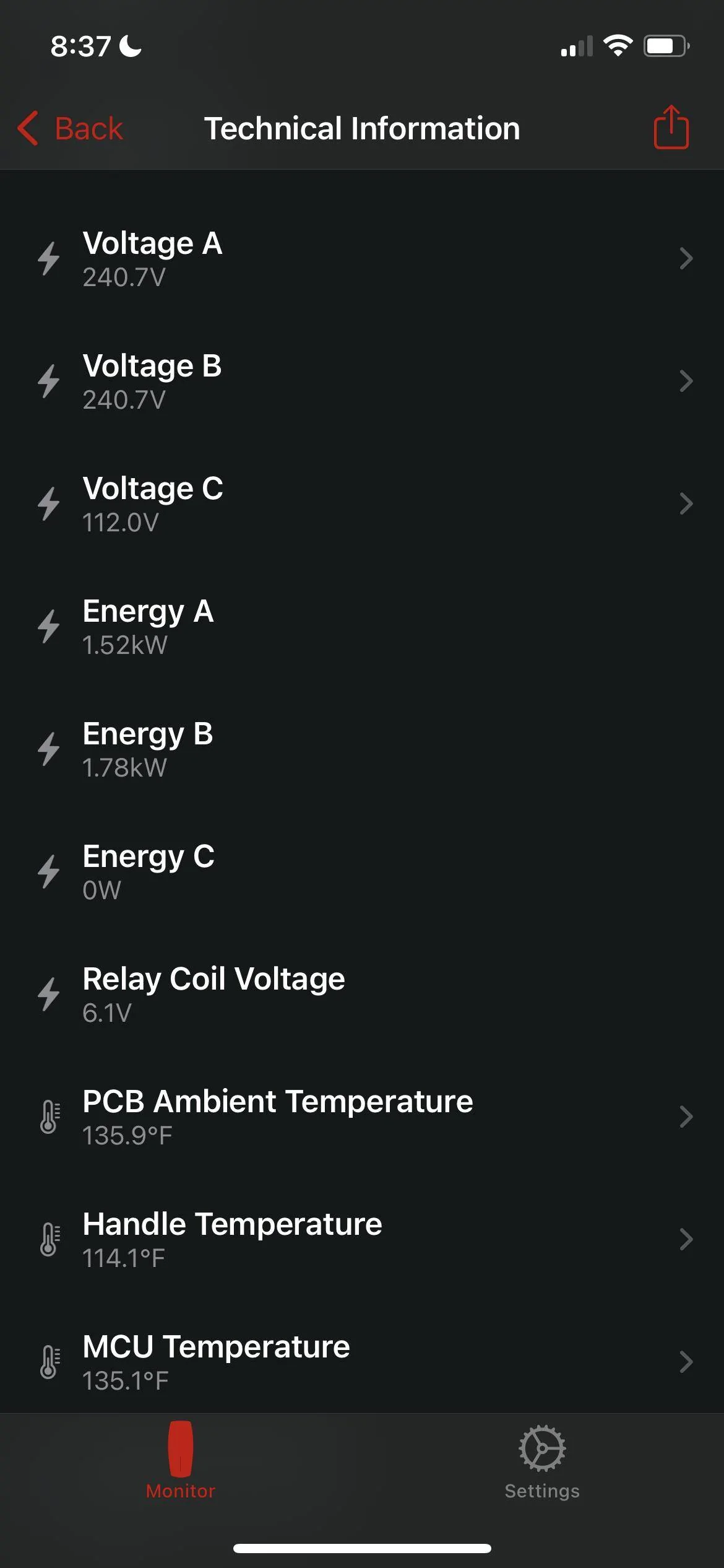

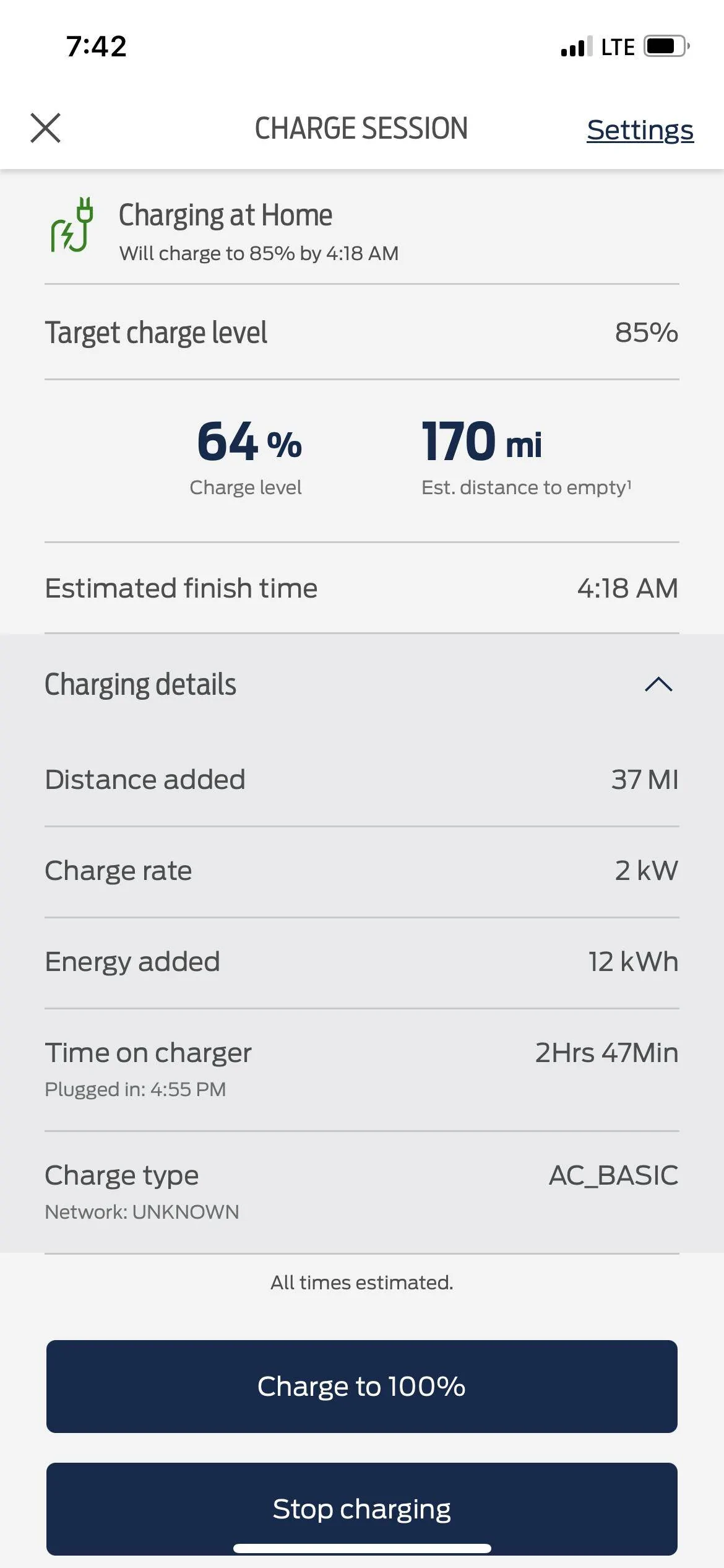

It looks like the fans don’t come on unless the battery is above 104° I plugged in a couple of times this week and it has been like 102.3, 102.0, 103.5 and the fan never came on. I plugged in one afternoon the battery pack was 105.5 and the fans came on and stayed on for a good 30 minutes.
It was hot as all hell this week. I have to dig back through other screenshots but I think I win for worst charging above zero.
Ford Mustang Mach-E L2 charging speed recently dropped 33% IMG_4891
Ford Mustang Mach-E L2 charging speed recently dropped 33% IMG_4887
Ford Mustang Mach-E L2 charging speed recently dropped 33% IMG_4889
Ford Mustang Mach-E L2 charging speed recently dropped 33% IMG_4888
From what I could tell my wall connector had dialed it down because its control board was nearly 140° which is 20° above its operating temperature.
