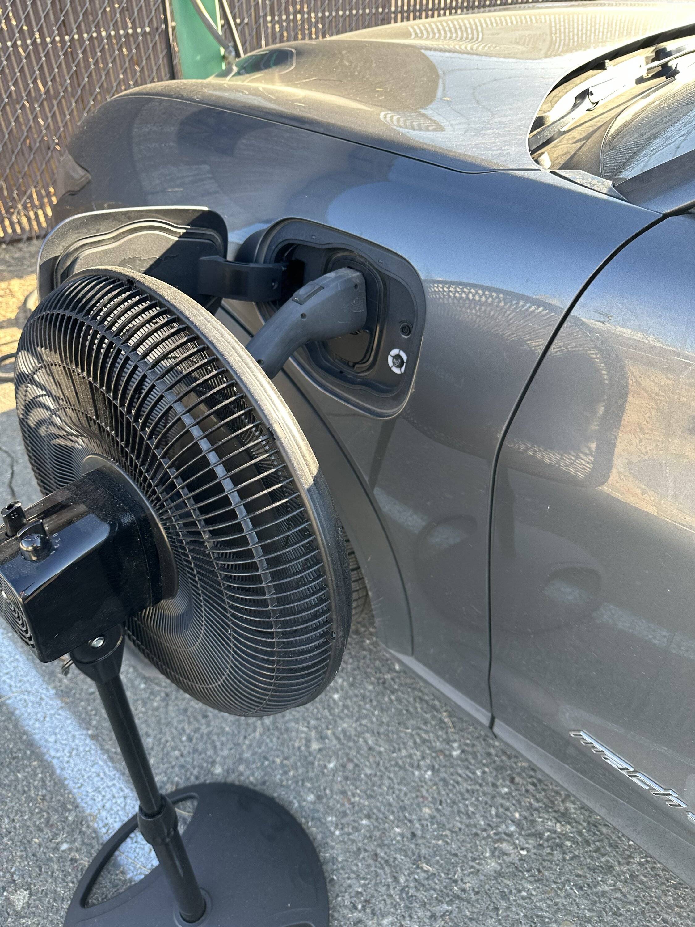

My car was doing the same thing, start out at 8KW charge and then drop to 6. and it started after the most recent update in June.
Seeing that most people feel the issue is tied to the charge port temperature, I started using an IR temp gun and checking the temp, the charge cable handle was running around 130-150°F
I put a fan onto the cable and now it is staying at 8KW the entire time. I am in California and it has been over 100°
This is day 3 of using the fan and I have not had any issues with it backing down to 6kw and before the fan it was doing it every day.
It seems stupid to have to do this, but until Ford gets their sh*t together, this is how I have to charge
I think you have the solution! No OTA update needed!

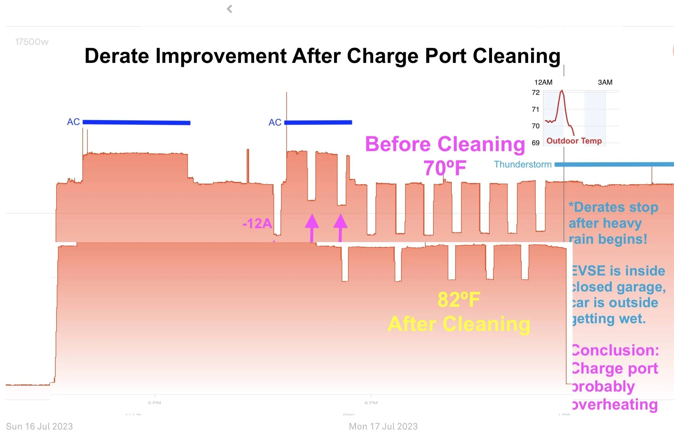

We saw some improvement in charge derate after cleaning the charge port. Even though it was about 10ºF warmer than the previous session, the derates took longer to start and were less frequent (I recycled my previous diagram here to overlay the new session, same time scale, sorry it's messy).
Ford Mustang Mach-E L2 charging speed recently dropped 33% Cleaned charge port
I wrote a topic about how to clean your charge port if you wanted to try and see if there's any improvement: How to Clean Your Charge Port
Great post and thankyou for your help. I have a small compressor with a water remover on it for electronics as the cans of compressed air are a bit costly for air. 99% rubbing alcohol is not a problem? I have checked my port and the charger handle and it is not that dirty living in a blue sky region and the way I treat/maintain my machines.
Still have to say that this happened to most of us after the charging software was updated and all fingers point to whatever was changed (monitored) in that update. My last charge was down to 6.2 KW average and ran well past what use to be normal. Something is still not right with my car. Can see that cleaning it may reduce some of the heat but still not the fix as far as I see. I charged at 14C and will say ambient temp is not the problem but it could be the heat generated from the charging process itself. 15 minutes charging at 40 amp than drops to 32 amp and stays there.

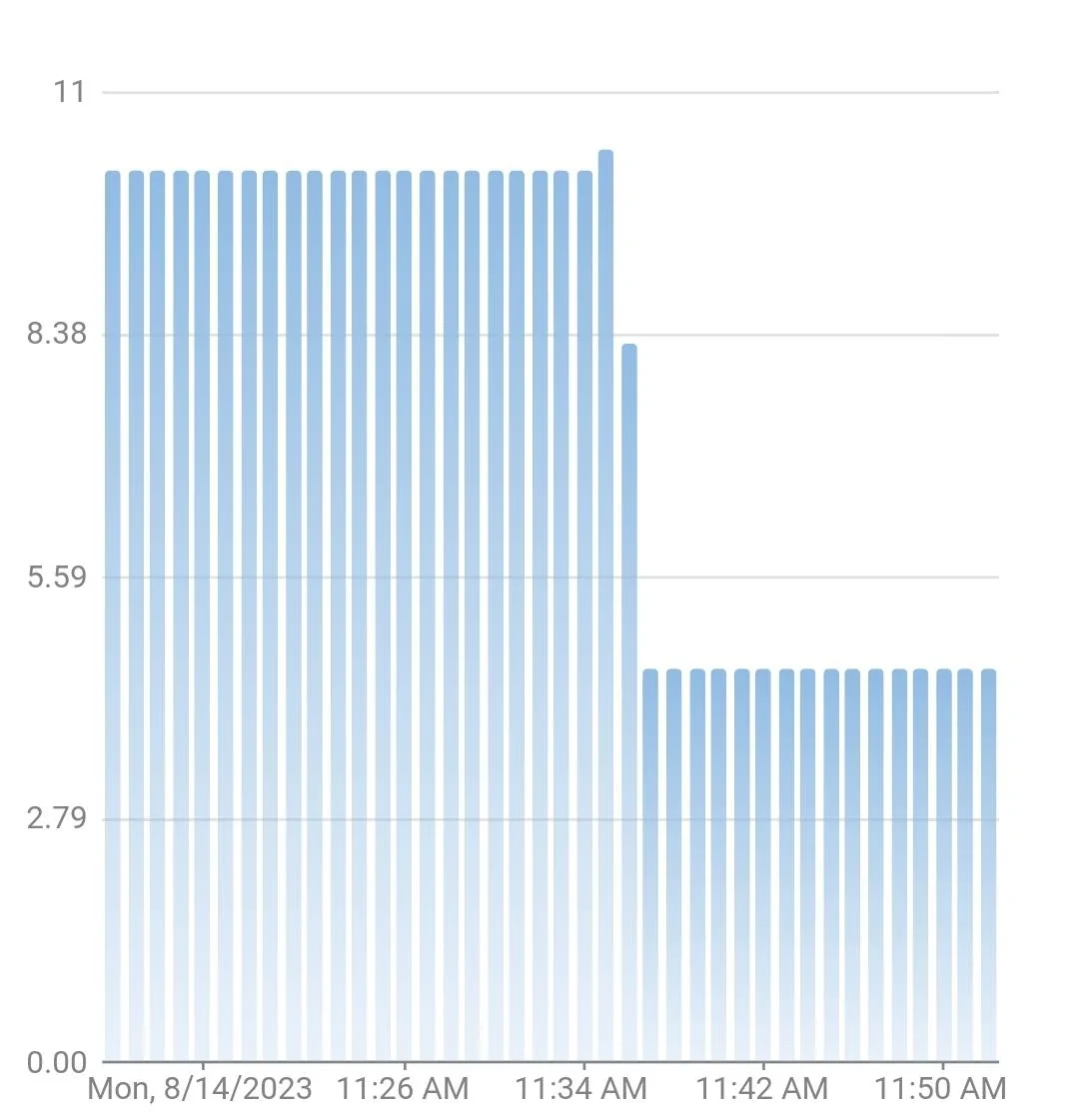

I previously posted that my car doesn't have this problem. I was wrong. I just didn't charge it for long enough to see it occur.
Yesterday I did a 5-hour charge. After about 2 hours, the charge rate started throttling. I left it alone until it reached around 85% and then I disconnected the charge. At the end, it was severely throttled.
For the first two hours, it maintained 11 kW like normal. Near the end? Well, see the chart above. I may try cleaning the port like Lee suggested, but it never used to do this before. Is it software, or wear and tear? Maybe both?
The car was parked inside the garage, which was around 82 degrees. Not very hot at all.
