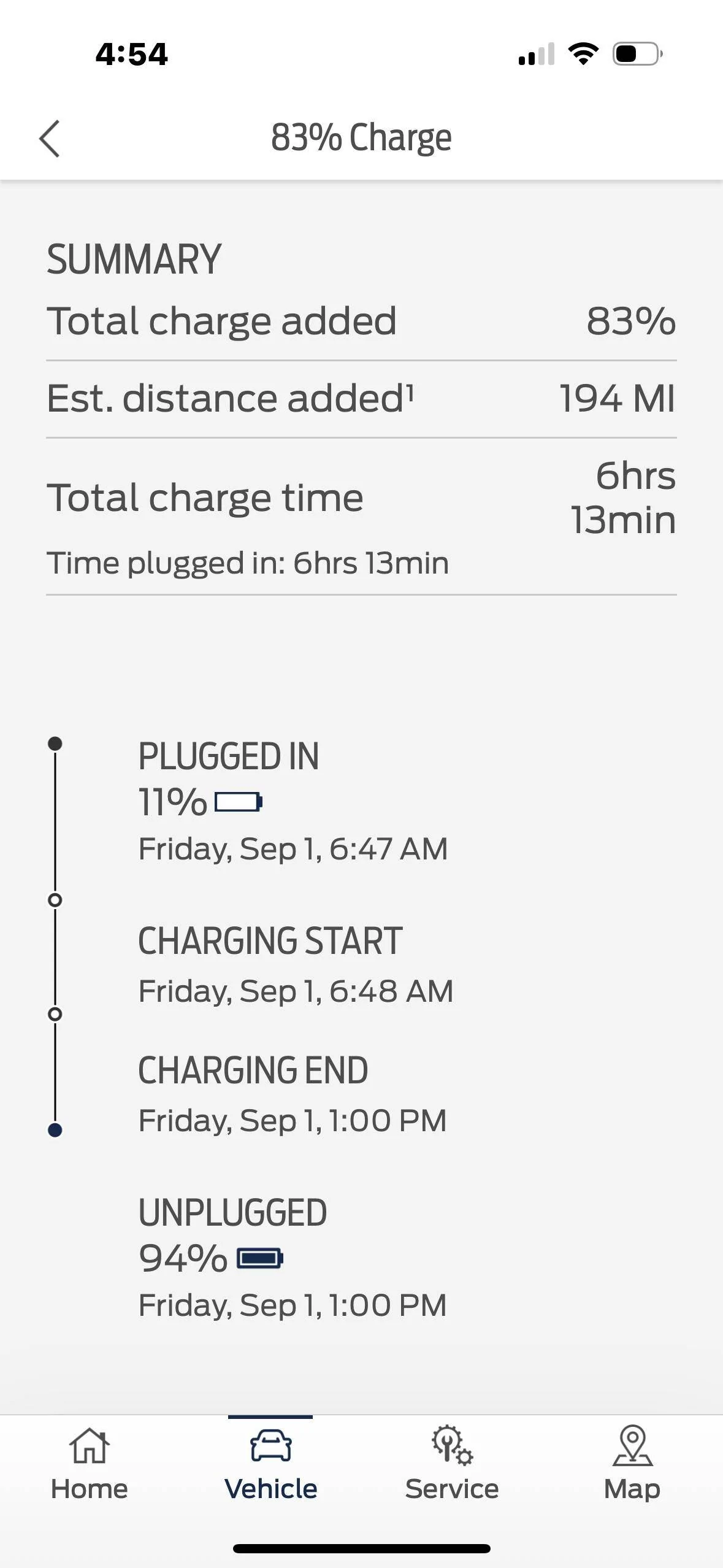

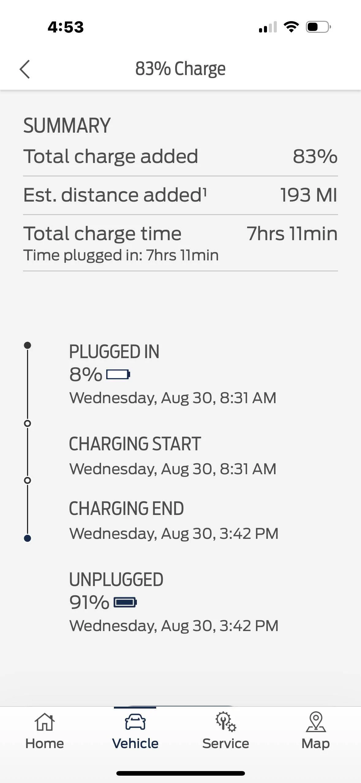

In Northern California it has been in the upper 90's, and my charging has been cycling from 8kw to 6kw like everyone else.
We recently had a spat of cool weather and the highs were in the 80's.
My charging did not cycle on that day and look at the difference in time for adding an 83% charge.
2 days apart. 1 hour longer to charge in 90° weather
Both of these charges were with the same charger.
@Ford Motor Company should be embarrassed and ashamed
The #1 problem with EV's is recharging, instead of making changes to speed up recharging, they are slowing it down. Why?

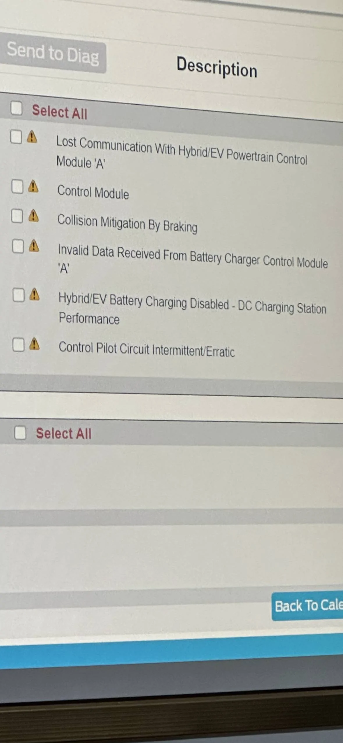

Back in July I took my car to the Ford Dealer for this charging issue, they found the error codes in the pic below.
The Ford procedure says to clear the error codes and try charging and see if the error codes come back. They have a 6kw charger at the dealer, they plugged it in, charged it up and no error codes.
I told them it needs to be plugged into a 10.5KW charger to see the problem. They do not have a charger that size. So they could not replicate the issue.
As I have stated before, the dealerships are woefully unprepared to handle any type of repairs on this car.
The worst part is the service advisor told me they had several other MME's in their shop for the same charging issue.
But to me the bigger issue is that if the charging issue is occurring because of a high charge port temp, real or simply a sensor issue, why doesn't the car give you a warning that there is a problem.
If it is, as you say, a risk of the car catching on fire, shouldn't the car, at a minimum, throw a warning and let you know there is a problem.
Not just continue with no warning as to what is going on until it actually catches on fire.
The error messages below were not throwing any warnings on the screen either.
To me, lack of communication from the car and from Ford is a major problem, and there are a lot of people on this forum that are experiencing the same charging issue and not a peep from @Ford Motor Company
That is why I say Ford should be ashamed and embarrassed.
